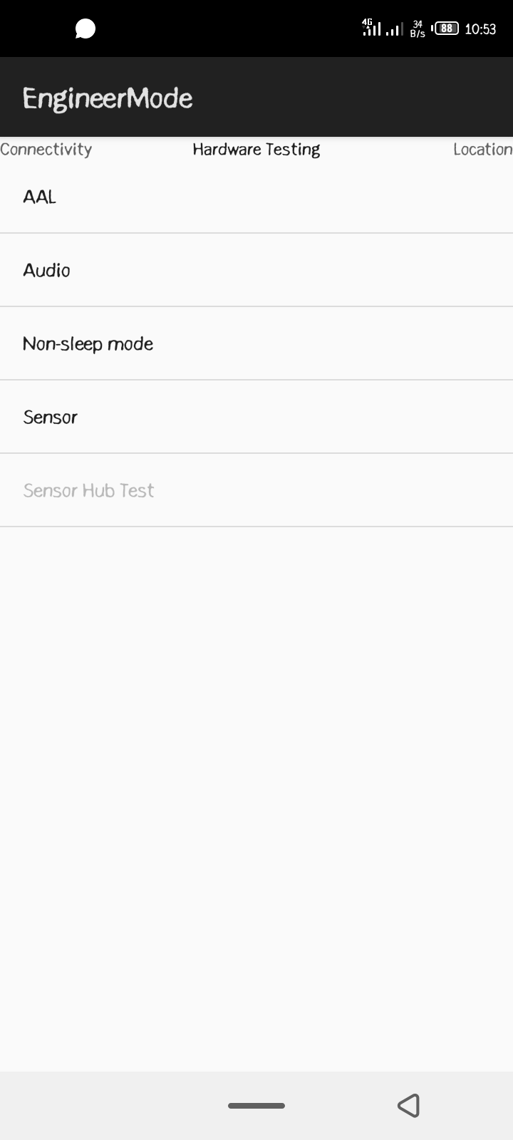

Thanks tho. But pls can you give me a full guide to root the device? Wanna check something in the root folder. I tried patching the boot.img with magisk and replace but after flashing, my device got stuck in a bootloop with an error on the infinix logo screen saying something like "Red State" that i should flash the original boot image or disable verified boot. Please help
And again, If u have any recommendations on how to get that "Sensor Hub Test" option in the attachment clickable, It'd be much appreciated. Thanks

items you find disabled in engineering mode don't apply to your device, as far as i know they can't be enabled
