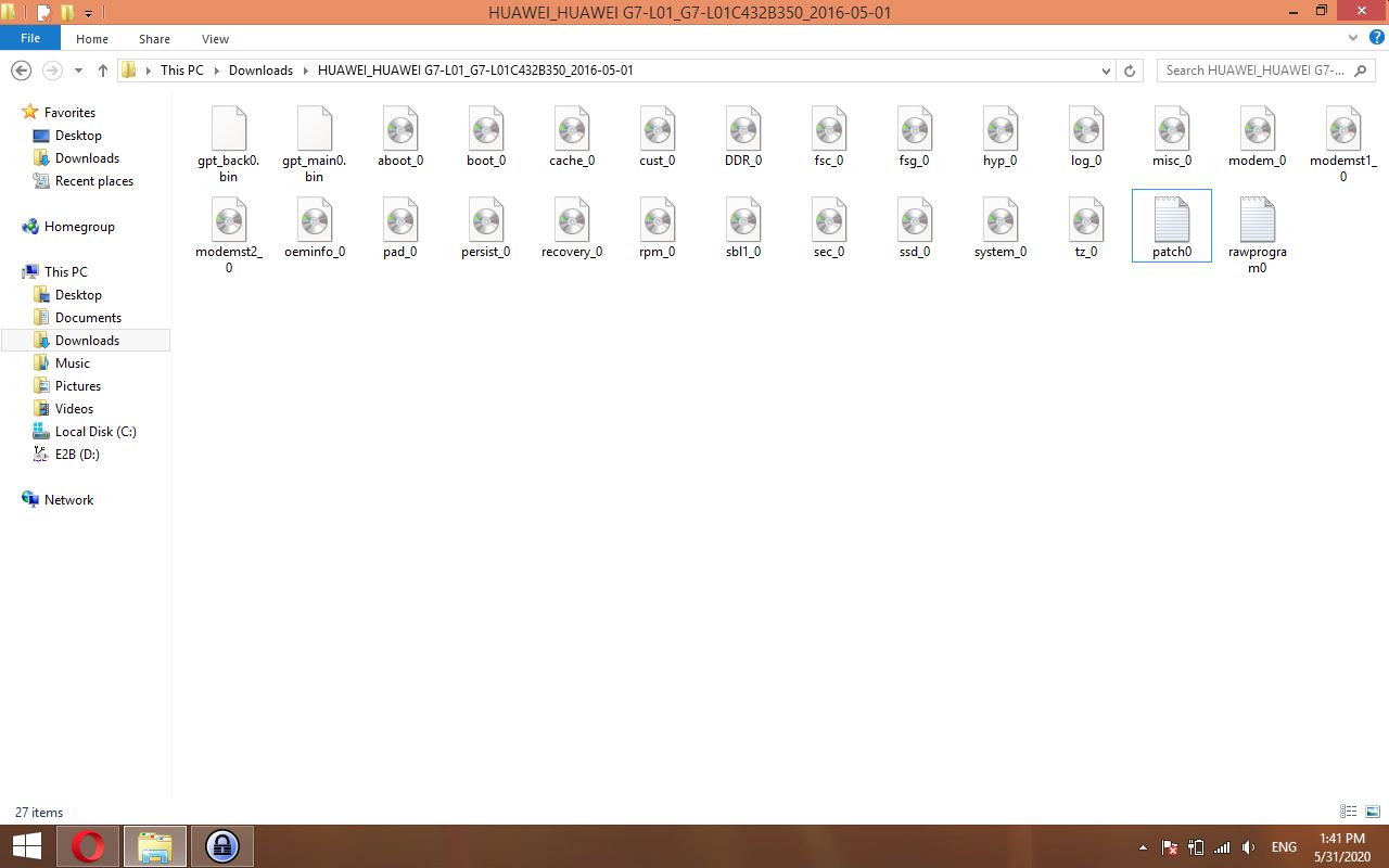

i found a firmware and maybe won`t need programmer. i didn`t see such field in nck box flasher.
I am attaching shot of files in firmware.
the need - can`t enter EDL. Maybe my cable should be tommorow in post (from ali express) maybe not.
I see there is combination for shorting two fields on board for EDL - i short them and while connect the phone to pc?
This post was last modified: 31-05-2020, 11:45 AM by disturbed.

(31-05-2020, 11:43 AM)disturbed i found a firmware and maybe won`t need programmer. i didn`t see such field in nck box flasher.
the field for selecting firehose is present in qfil or miracle thunder tool
miracle thunder even has g7-l01 under the model select field (which would mean that you don't necessarily need to supply firehose programmer file). you can try that too i.e select your model from the dropdown model select box in miracle thunder or nck box if such is available
(31-05-2020, 11:43 AM)disturbed ...I see there is combination for shorting two fields on board for EDL - i short them and while connect the phone to pc?
if you found this then yes, shortening the two points and connecting the device to the pc will get your device into edl mode
