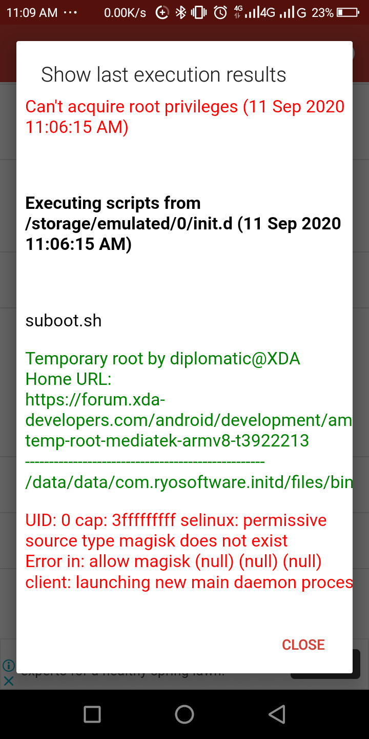

  10. Click run scripts now (if you're using the free version then watch the video ad, usually 30 secs then click run scripts now a second time)
  11. Once show last execution results becomes clickable, click it
  12. If you see "Selinux Permissive" then your device now has root access and you can confirm this using root checker app from playstore

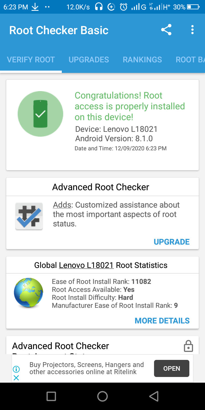

So lets quickly return back to root checker to confirm if there's root access now, check, and here i have super user prompt so i'll just click on grant and the device is rooted now
So this is how you root a mediatek android phone using mtksu bootless root
So with this now you can easily get root access on just about any app

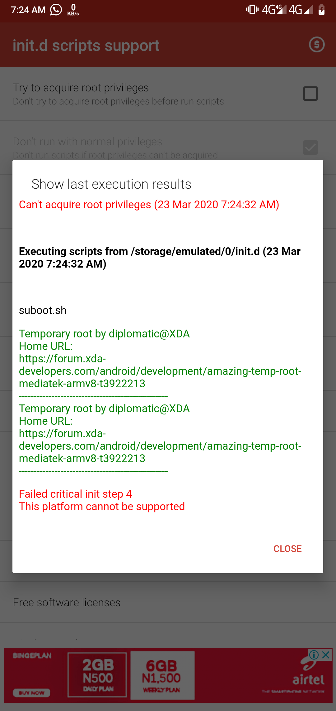

23-03-2020, 07:33 AM
init.d is showing
FAILED CRITICAL INIT STEP 4
THIS PLATFORM CANNOT BE SUPPORTED
In Umidigi a5 Pro. does it mean dat my phone is not supported?
Screenshot attached
23-03-2020, 10:36 AM
(23-03-2020, 07:33 AM)Studio ...
Screenshot attached
sadly yes, your device isn't supported
you can root using magisk instead
This post was last modified: 23-03-2020, 10:37 AM by X3non.

Now we'll need to config this app, tick run script at boot time, execution delay, no delay, accept, selected folder, select the init.d folder you created earlier on then save
Lastly click run script now, now since we're using the free version, we'll be prompted with an option to display an ad, so we'll display an add
This requires internet connection, my device is currently connected to my wifi, so this is what the ad will look like
We're actually waiting for the countdown, now i'll click run scripts now again

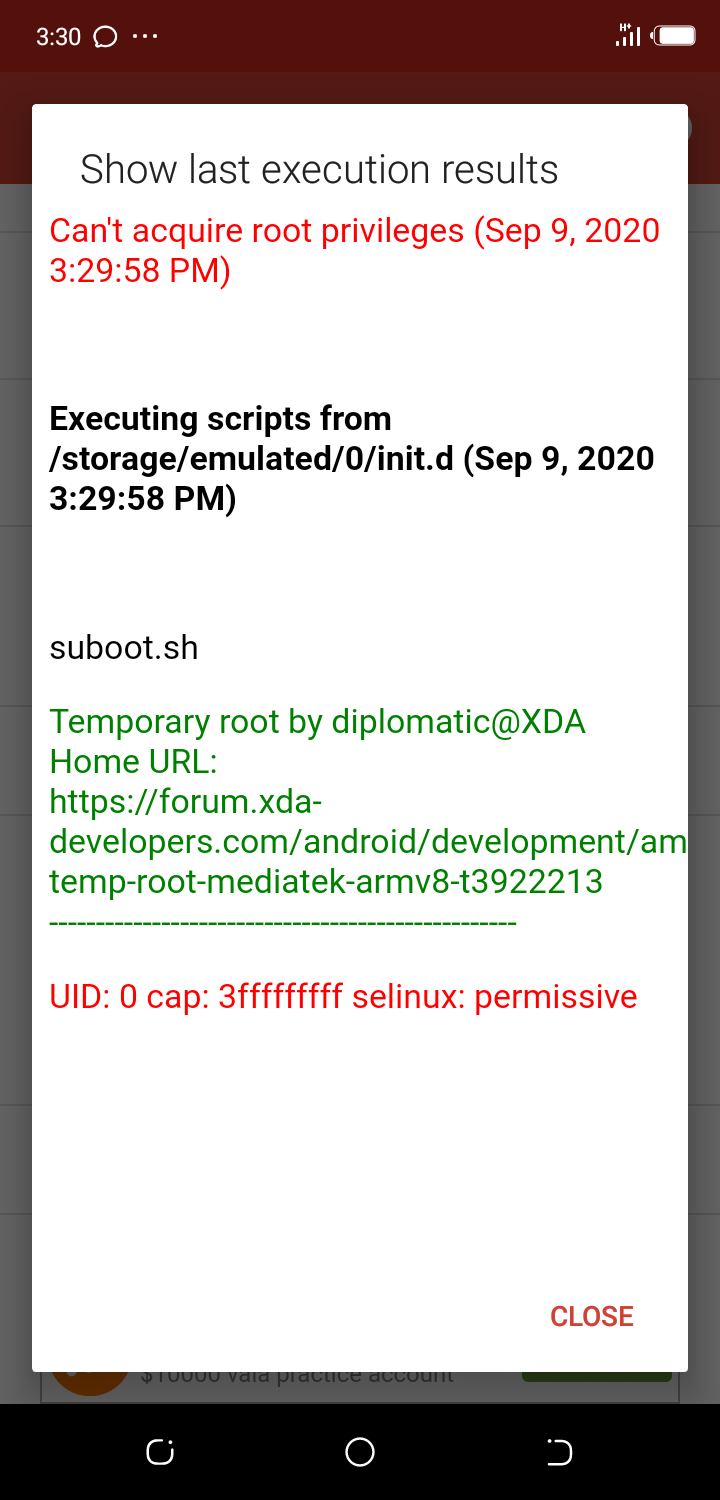

You see show last execution has come up, once you see selinux permissive then you know you have root access and everything was successful

Hi my device is tecno i2 mt6761 android 8.1, i just applied all the procedure mention above and got execution result selinux permissive but when i open magisk manager and root check it showing sorry root is not properly installed, what to do now ,where did i go wrong please help. Probt bdw my bootloader is already unlock ...
