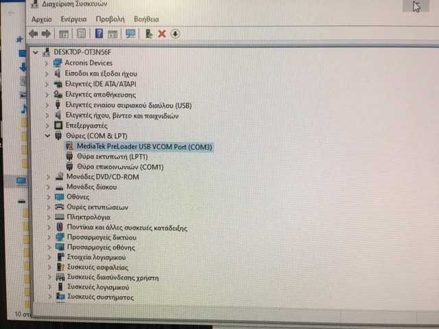

problem with mediatek smartwatch drivers
i install the drivers but it shows (!) in device manager and when i click on it it shows the follow error message :
the software for this device has been installed but may not work properly.
device cannot be started (code 10)

That’s a normal error, code 10 means the driver is not signed but may still work.
Is there anything wrong with your device?

you get code 10 before you installed an unsigned driver, there is nothing wrong with the installing an unsigned driver. if it bothers you, you can uninstall the driver using the guide @ https://www.hovatek.com/forum/thread-7660.html then reinstall signed drivers ; download "Auto Mediatek USB VCOM Drivers Signed (all MT**** devices)" @ https://www.hovatek.com/forum/thread-16640.html
the important things is, do you have problems getting a detection on a certain device?
