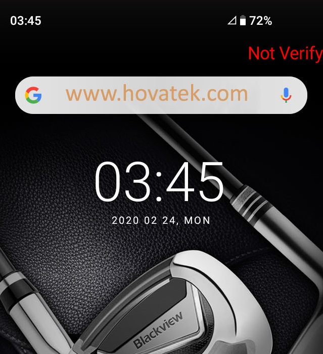

This error as seen in the screenshot below is usually as a result of formatting certain partitions on a mediatek android phone while flashing firmware i.e flashing firmware using format all + download or firmware upgrade
[Image: how-to-remove-not-verify-red-text-on-a-m...-phone.jpg]
If could be
  • Not verify
  • Unwritten google key Unwritten tee key
  • Tee key not write Google key not write
If you have a previous backup of the following 3 partitions (proinfo, protect1 and protect2) then simply flash them back to remove the red text but if you don't have a backup of these partition then continue with the guide below
