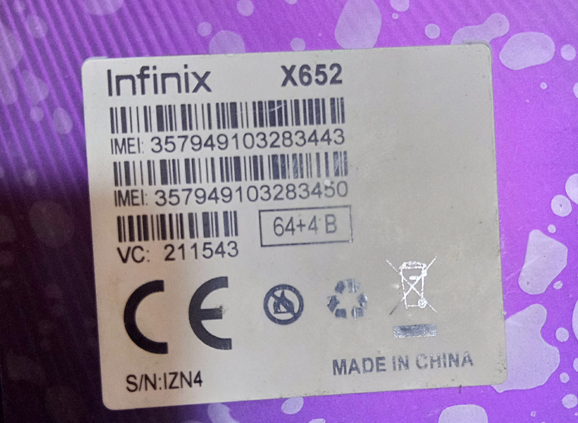

The phone was boot loop, I tried doing hard reset didn't work. It was showing a lot of errors.. the build on the phone at that moment was X652-h627AB-P-191214v258. I couldn't find the exact version to flash so I downloaded this version here X652-H627AB-P-200113V290.. As soon as I plugged the phone it just showed me error, status_brom_cmd_fail (0xC0060005). I tried using swd tool, it's the same thing.. please assist me what I'm a doing wrong?
that's the back of the phone

(20-02-2020, 01:52 PM)highbee The phone was boot loop, I tried doing hard reset didn't work. It was showing a lot of errors.. the build on the phone at that moment was X652-h627AB-P-191214v258. I couldn't find the exact version to flash so I downloaded this version here X652-H627AB-P-200113V290.. As soon as I plugged the phone it just showed me error, status_brom_cmd_fail (0xC0060005). I tried using swd tool, it's the same thing.. please assist me what I'm a doing wrong?  that's the back of the phone
see the fix @ https://www.hovatek.com/forum/thread-439.html
Also, did you use the infinix S5 DA?
