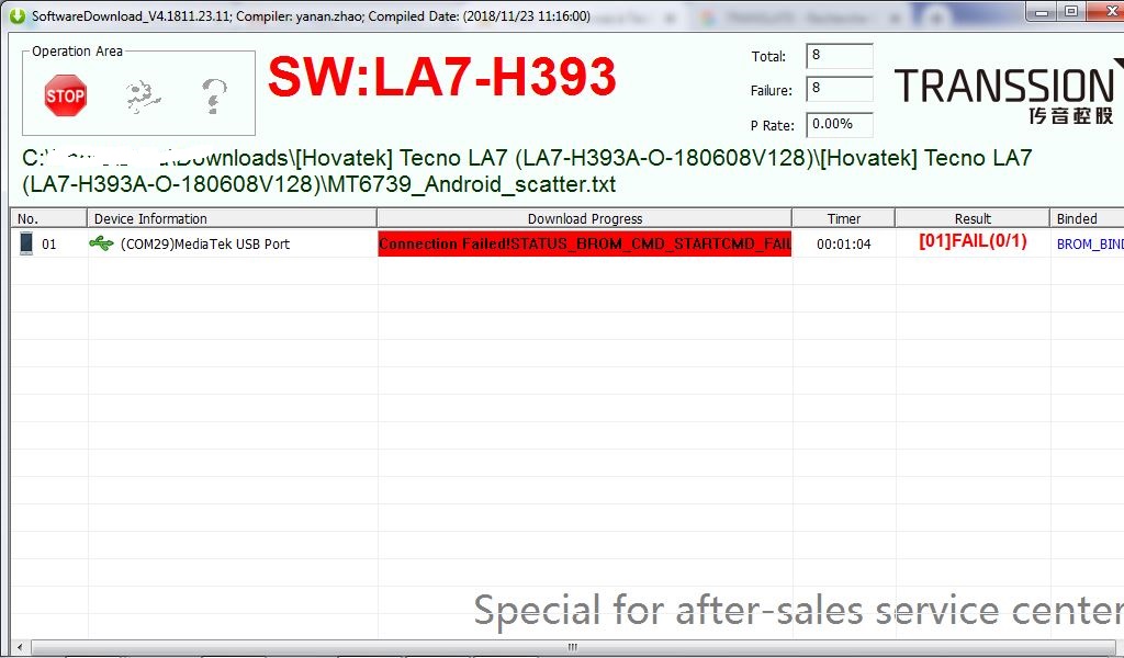

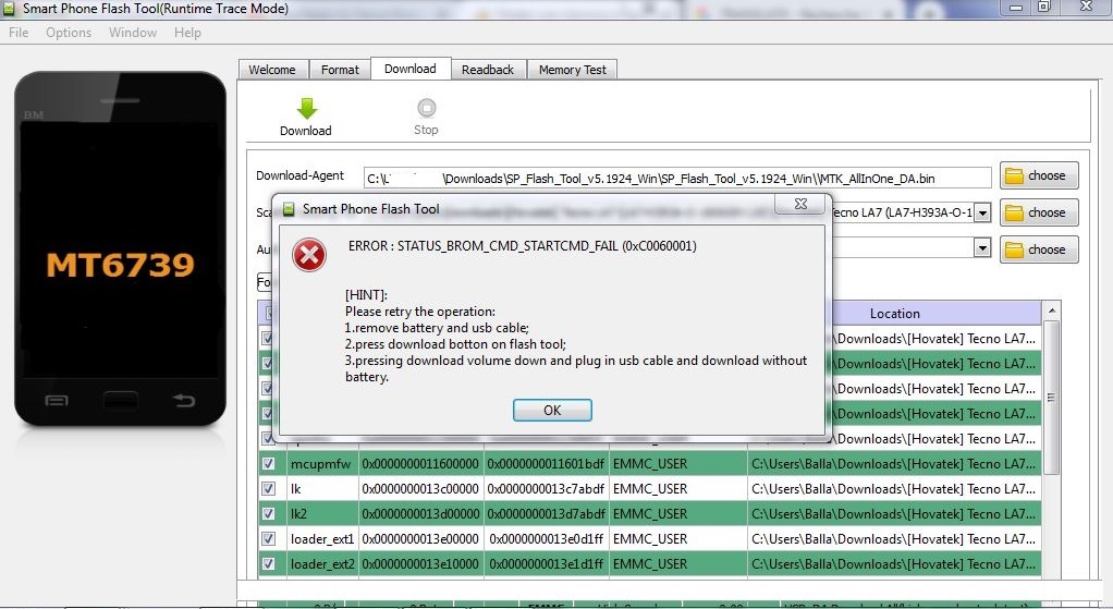

08-02-2020, 03:20 PM
My battery is built into my phone and I downloaded the second firmware (Tecno LA7 (LA7-H393A-O-180608V128) [Factory / Signed]) to flash the phone but it really doesn't work.
Do you have an explanation? Sad
Thank you in advance !
PS: I think flashing requires a download agent, but the download agent that I downloaded here https://www.hovatek.com/forum/thread-23243.html does not work.
Here is what the flashing light gives attached. I tried with SP FlashTool, Miracle Box, SW afterSaler.
Thanks to all for your contribution.

50,891
08-02-2020, 06:18 PM
(08-02-2020, 03:20 PM)balla123 Ma batterie est intégrée à mon téléphone et j'ai téléchargé le deuxième firmware (Tecno LA7 (LA7-H393A-O-180608V128) [Usine / Signé]) pour flasher le téléphone mais cela ne fonctionne vraiment pas.
Avez-vous une explication? Sad
Merci d'avance !
PS: Je pense que le flashage nécessite un agent de téléchargement, mais l'agent de téléchargement que j'ai téléchargé ici https://www.hovatek.com/forum/thread-23243.html ne fonctionne pas .
Voici ce que le clignotant donne ci-joint. J'ai essayé avec SP FlashTool, Miracle Box, SW afterSaler.
Merci à tous pour votre contribution.
post in English language, you can translate to English using https://translate.google.com
and for your sake, it's best you don't attempt to flash anything yet until you confirm that your device is not dead due to empty battery or been stuck in flash mode when you initially attempted to use miracle box
for inbuilt battery, you need to disassemble the back till you get to the battery if it's clip then unclip and reclip it back
10,418
08-02-2020, 06:20 PM
(08-02-2020, 03:20 PM)balla123 My battery is built into my phone and I downloaded the second firmware (Tecno LA7 (LA7-H393A-O-180608V128) [Factory / Signed]) to flash the phone but it really doesn't work.
Please use English only to post/reply on forum.
you need to loosen the phone to disconnect/reconnect the phone's battery before flashing the firmware you have downloaded.
also, attach the screenshots of the errors you encountered with all the flash tools you tried flashing the firmware with.

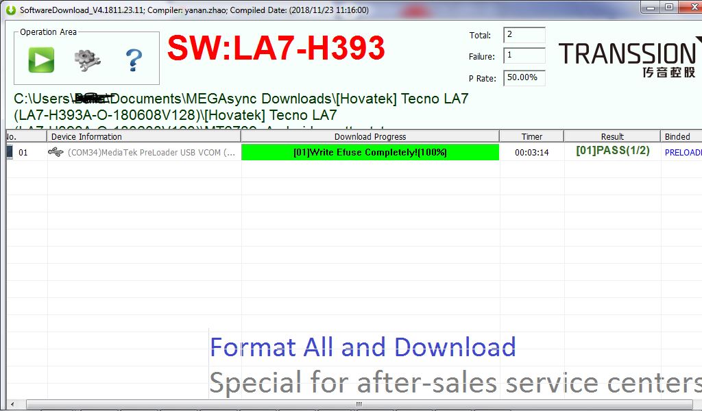

09-02-2020, 12:02 PM
[quote pid='186781' dateline='1581182448']
As for loosening the phone, I think that would not be possible since I have neither the tools nor the skills to loosen a phone that does not even have a target.
Here is when some results I have with the boxes
[/quote]
balla123
balla123
balla123
09-02-2020, 12:05 PM
