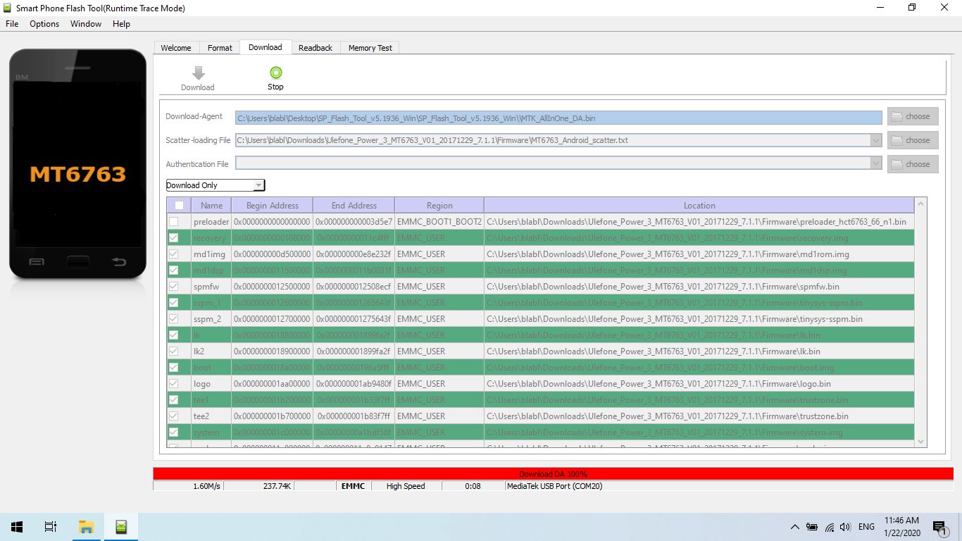

the phone is a gift for me from a client. It was watered i think. Have buyd new subboard and now am trying to make the phone alive.
I will try flash with SPMDT. something else on mind ?

if the phone is fully bricked from flashing wrong firmware or formatting entire emmc, then you should tick preloader when flashing
