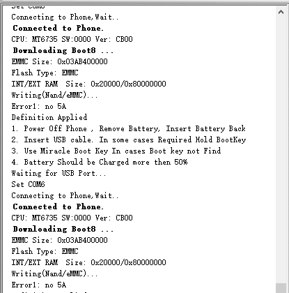

Hi All
I need help with write full dump to my phone nokia 3
This post was last modified: 30-12-2019, 01:40 PM by pawelek.

What version of miracle box are you using?
30-12-2019, 05:44 PM
(30-12-2019, 01:38 PM)pawelek Hi All
You need factory/signed firmware, miracle box dump won’t work.
What’s wrong with phone and how did the problem begin?
What’s the phone’s build no?

30-12-2019, 06:49 PM
Hardware issue faulty emmc chip

31-12-2019, 09:44 AM
as @bayaman18 mentioned, error 5a is related to faulty emmc chip
you might want to try flashing factory firmware using sp flash tool just to properly verify. link to factory firmware can be found under the important notice section @ https://www.hovatek.com/forum/thread-26928.html

I have version 2.8.2
This dump is from working version
50,982
03-01-2020, 11:35 AM
(03-01-2020, 08:31 AM)pawelek I have version 2.8.2
was not referring to emmc chip problem on the backup phone, rather on the faulty phone
read my previous reply again
