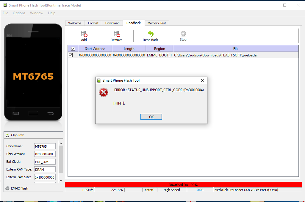

(18-12-2019, 10:14 AM)hovatek
(16-12-2019, 01:49 PM)mencoronaldo I've tried the read back of pgpt (EMMC_USER, 0x0, 0x80000) using spft but i get the same error as before
What version of sp flash tool are you using?
SP_Flash_Tool_v5.1924_Win

(18-12-2019, 06:26 PM)X3non
(18-12-2019, 03:59 PM)mencoronaldo SP_Flash_Tool_v5.1924_Win
check my last two replies

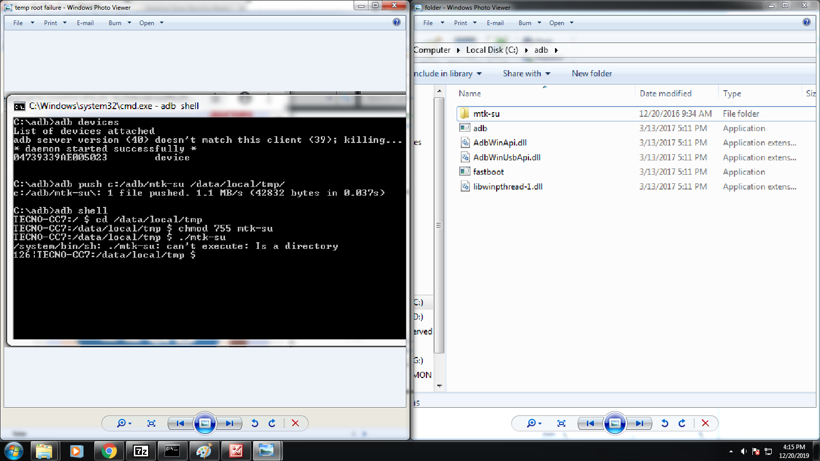

latest spft gives the same error 'STATUS_UNSOPPORT_CTRL_CODE'
mtk-su temp root procedure was unsuccessful

(18-12-2019, 07:28 PM)mencoronaldo mtk-su temp root procedure was unsuccessful
doesn't seem like mtk-su was copied properly, adb detects it as a folder rather than as a file
attach a screenshot of the contents within your c:/adb folder
you can try "adb push mtk-su /data/local/tmp/"
OR better still try the bootless root method in the second xda link i posted

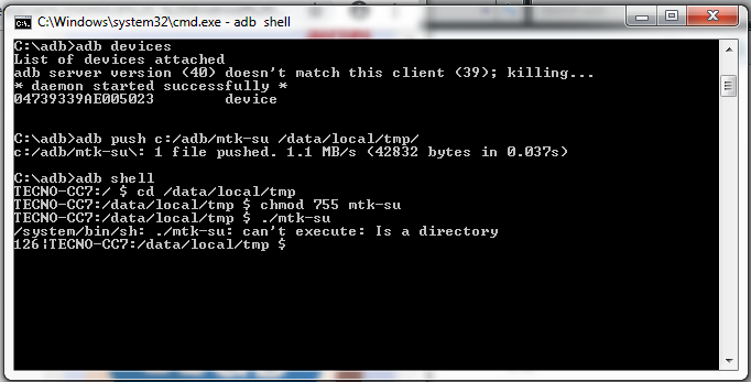

(19-12-2019, 11:10 AM)X3non

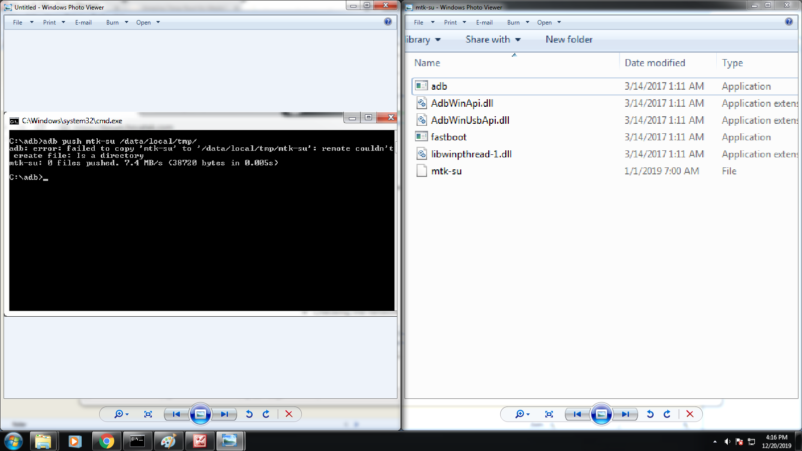

I've attached two separate contents of c:/adb folder along with its adb push error.
The second xda link requires a device that is compatible with the mtk-su method
20-12-2019, 08:26 PM
#26
(20-12-2019, 04:22 PM)mencoronaldo I've attached two separate contents of c:/adb folder along with its adb push error.
first screenshot as i suspected, you copied a folder not the mtk-su binary, now if you have mtk-su binary within that folder that copied successfully then you can try modifying the cd command you sent to match the folder path as seen below but leave all other commands unchanged
cd /data/local/tmp/mtk-su
second screenshot, retry using latest adb version @ https://www.hovatek.com/forum/thread-26886.html
lastly, you have not confirmed yet if mtk-su works on your device or not. you're currently still battling copying the mtk-su binary file correctly and haven't actually run the mtk-su binary (i.e ./mtk-su). the mtk-su bootless root method doesn't require adb, which should make it easier since you seem to be having problems using adb. if you try the two suggestions above and still don't get it right, then try the bootless root method

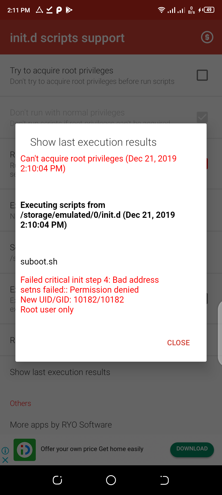

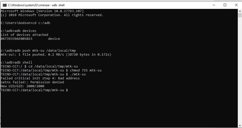

#27
(20-12-2019, 08:26 PM)X3non

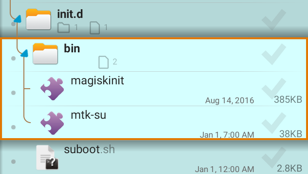

I've tried both modifying the cd command and latest ADB, still no success. It seems to be given the same error as the bootless root

#28
(21-12-2019, 02:23 PM)mencoronaldo I've tried both modifying the cd command and latest ADB, still no success. It seems to be given the same error as the bootless root
the new error from adb means mtk-su will not work on your device, don't retry mtk-su any more as well
you'll need to look for a hardware box / dongle to attempt backing up firmware from this device
