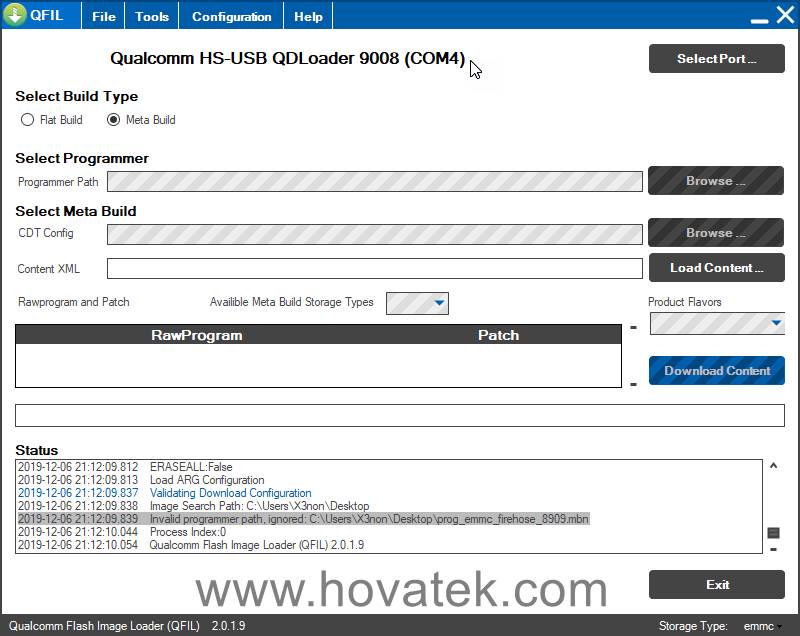

  1. Launch QFIL
    [Image: how-to-backup-firmware-from-a-qualcomm-a...qfil-1.jpg]

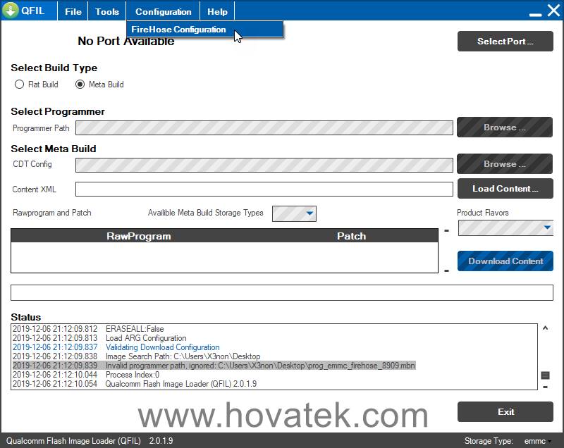

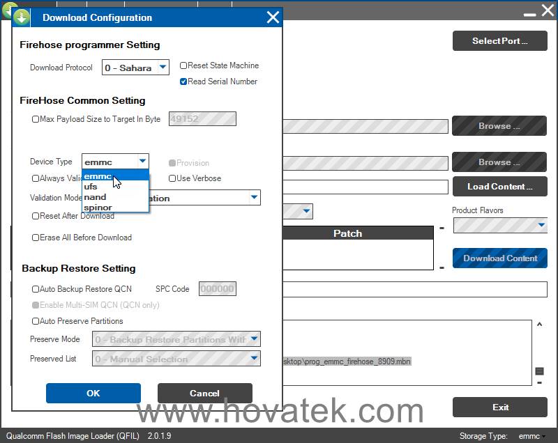

  2. Click Configuration > FireHose Configuration
    [Image: how-to-backup-firmware-from-a-qualcomm-a...qfil-2.jpg]

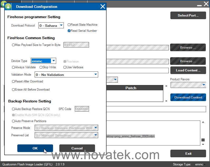

  3. In the Download Configuration window that opens next, click the drop down bar beside device type and select your device storage
    [Image: how-to-backup-firmware-from-a-qualcomm-a...qfil-3.jpg]
  4. Click OK
    [Image: how-to-backup-firmware-from-a-qualcomm-a...qfil-4.jpg]

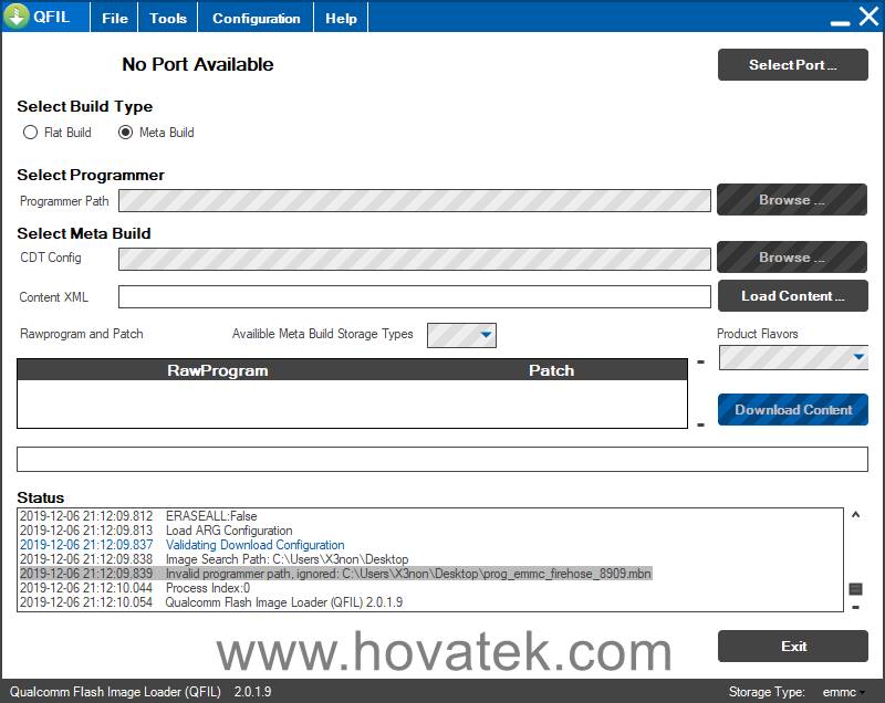

  5. Connect the device to the PC while in EDL Mode (device should be in EDL before connecting to pc). No Port Available should change to Qualcomm HS-USB QDLoader 9008
    [Image: how-to-backup-firmware-from-a-qualcomm-a...qfil-5.jpg]

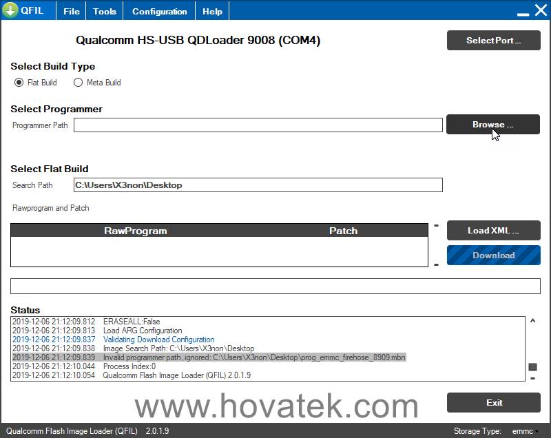

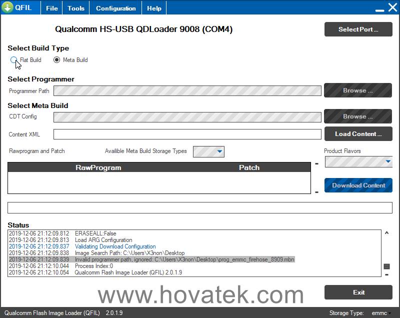

  6. Under Select Build Type, tick Flat Build
    [Image: how-to-backup-firmware-from-a-qualcomm-a...qfil-6.jpg]
  7. Under Select Programmer, click Browse
    [Image: how-to-backup-firmware-from-a-qualcomm-a...qfil-7.jpg]

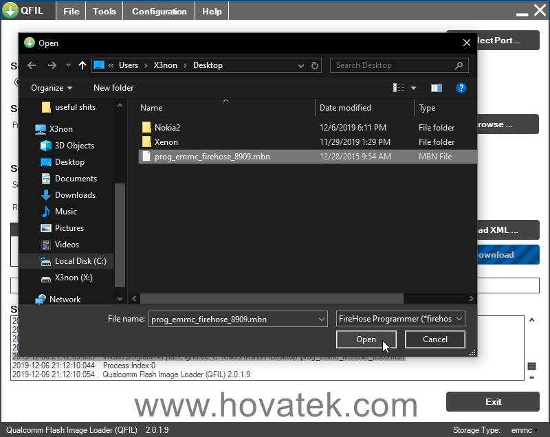

  8. In the Window that pops up, highlight the loader file (usually named prog_emmc_firehose_****.mbn) and click Open
    [Image: how-to-backup-firmware-from-a-qualcomm-a...qfil-8.jpg]

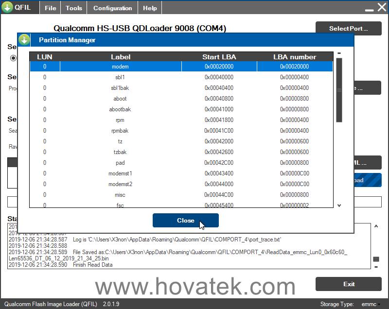

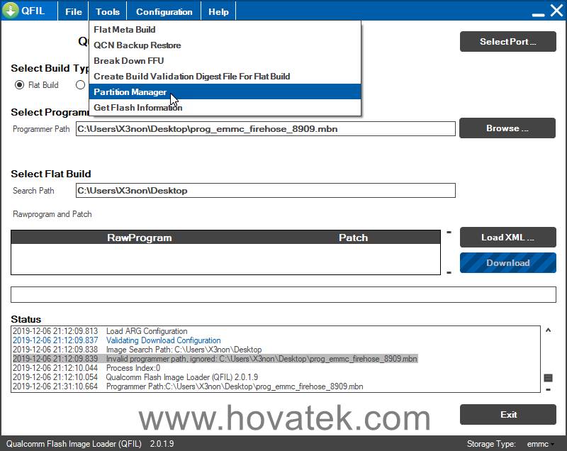

  9. Click Tools > Partition Manager
    [Image: how-to-backup-firmware-from-a-qualcomm-a...qfil-9.jpg]

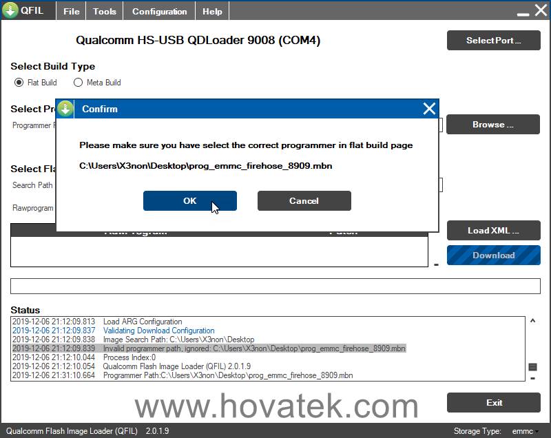

  10. In the confirm window that pops up, click OK
    [Image: how-to-backup-firmware-from-a-qualcomm-a...fil-10.jpg]

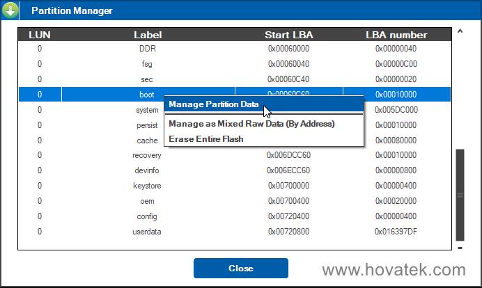

  11. Another Window will automatically pop up, right click on the partition you wish to backup then select Manage Partition Data
    [Image: how-to-backup-firmware-from-a-qualcomm-a...fil-11.jpg]

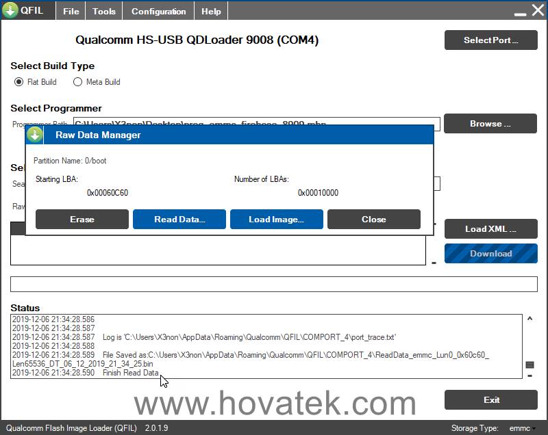

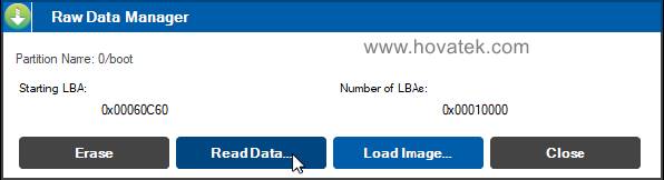

  12. A new window will pop up, click ReadData...
    [Image: how-to-backup-firmware-from-a-qualcomm-a...fil-12.jpg]
  13. You should get "Finish Read Data" once QFIL has successfully dumped the image from the partition
    [Image: how-to-backup-firmware-from-a-qualcomm-a...fil-13.jpg]
  14. You can repeat the procedure for all other partitions you wish to backup

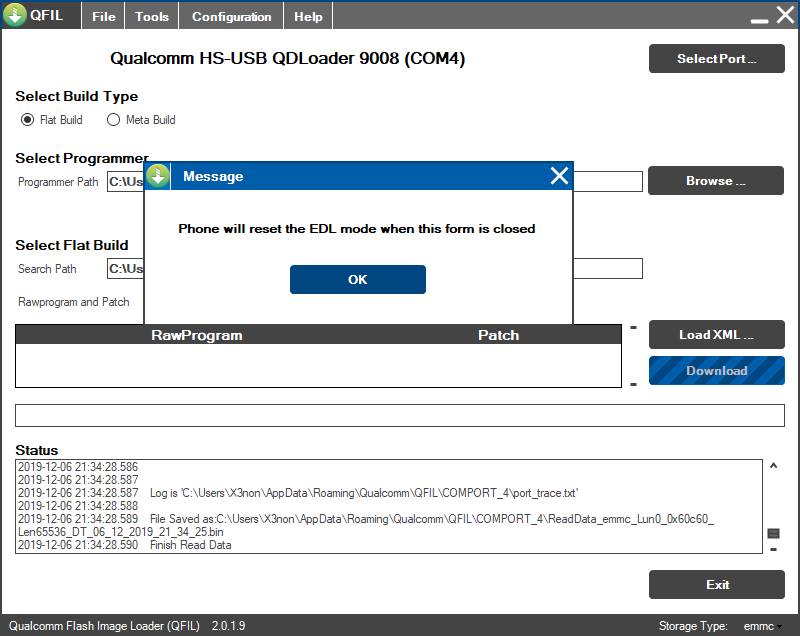

  15. Once done, click Close on Partition Manager window
    [Image: how-to-backup-firmware-from-a-qualcomm-a...fil-14.jpg]
  16. A new window will pop up, reminding you that your device will be reset from edl modeback to homescreen, click OK
    [Image: how-to-backup-firmware-from-a-qualcomm-a...fil-15.jpg]

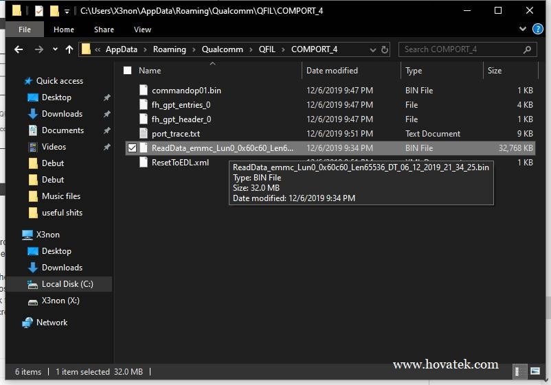

  17. You'll find all the backup files within the same folder location as seen within QFIL logs. In my case, it's under the folder location below
    C:\Users\X3non\AppData\Roaming\Qualcomm\QFIL\COMPORT_4
    [Image: how-to-backup-firmware-from-a-qualcomm-a...fil-16.jpg]
