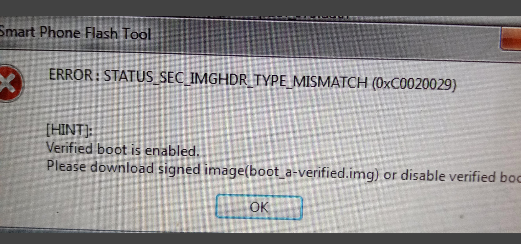

I flashed with this build number.. x605-H632AD-P-190320V202.  The error I'm getting now in below image. And the previous build number

I'm trying attach the image it's not loading..
"Verified boot enabled
Please download signed image( boot_a-verified.img) or disable verified boot"

(28-08-2019, 12:20 PM)highbee I flashed with this build number.. x605-H632AD-P-190320V202.  The error I'm getting now in below image. And the previous build number
what was wrong with the device before you decided to flash it?
was flashing successful or it got interrupted with an error message?
upload your SS to imgur.com then post the link here

(28-08-2019, 03:30 PM)X3non

28-08-2019, 03:40 PM
Nothing wrong with the device before flashing.. it got interrupted

(28-08-2019, 03:40 PM)highbee Nothing wrong with the device before flashing.. it got interrupted
if nothing was wrong and flashing never even started then either disconnect / reconnect the battery clip on the device (you need to disassemble the back cover to get to the battery) OR keep charging the phone till the charging indicator comes up; refer to https://www.hovatek.com/forum/thread-808.html
and if you decide to attempt to reflash then ensure you're doing so with factory firmware (usually having -verified or -sign files) not firmware / rom backup

@Highbee.. I got same issue. It seems the ANDROID PIE STOCK boot.img file isn't verified. what I did was to reflash my phone with the Android 8 0re0 stock ROM. Then did an OTA upgrade to pie or Tcard update to pie.
You can extract and resign the boot.img files in the Stock Rom.
I will soon tell you how to disable "verified boot enable".
