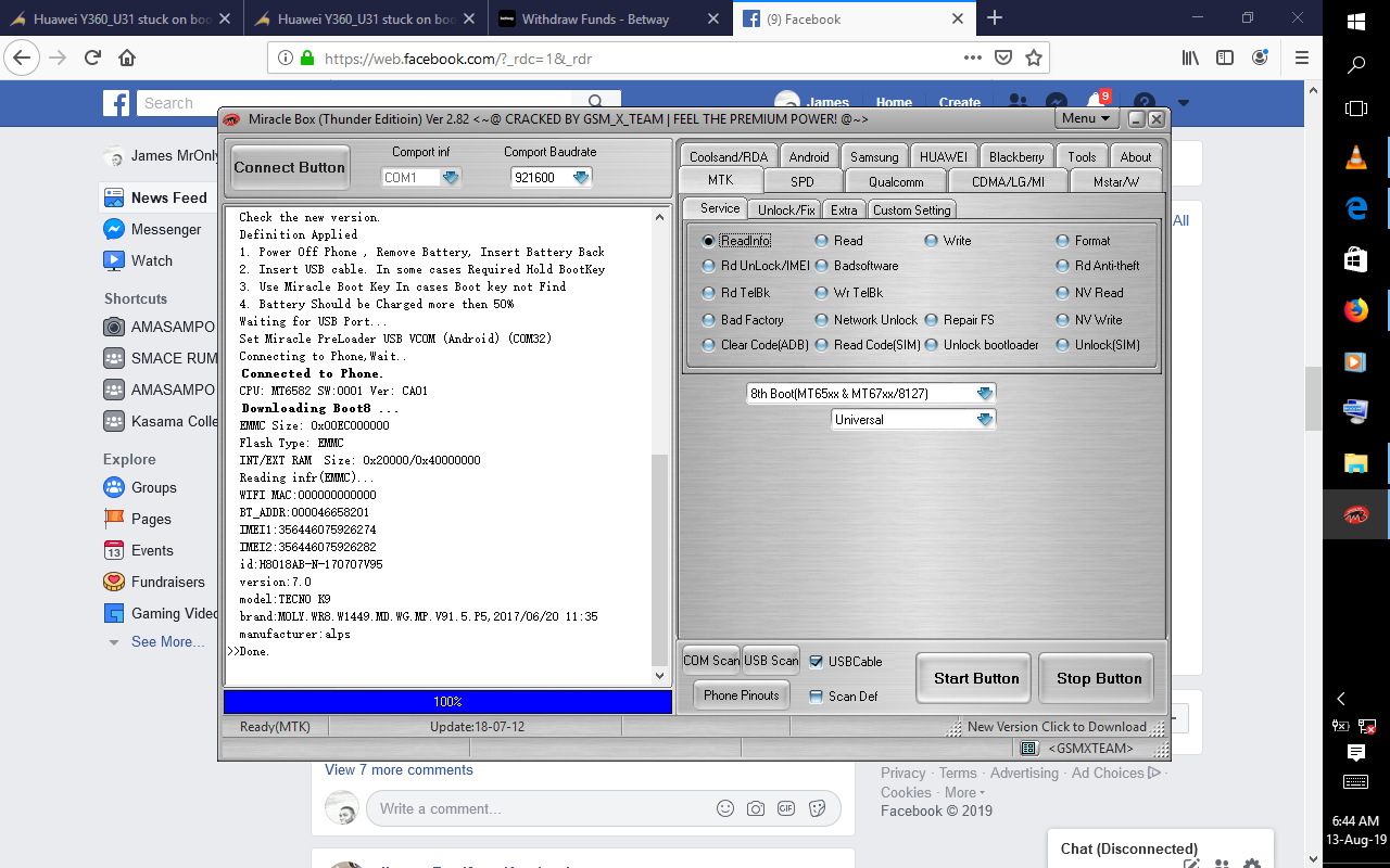

I downloaded the firmware for Tecno k9 here with and id:H8018AB-N170707V95 which is matching to my phone information as shown on the screen shoot attached below but when i extracted the firmware it shows that the chipset is "mt 6580" contrary to my phone's "mt 6582"
Can this firmware still work on my phone?
Please help,my phone is stuck at boot log and can't be turned into recovery mode only fast booting mode

(14-08-2019, 04:13 PM)james bwalya I downloaded the firmware for Tecno k9 here with and id:H8018AB-N170707V95 which is matching to my phone information as shown on the screen shoot attached below but when i extracted the firmware it shows that the chipset is "mt 6580" contrary to my phone's "mt 6582"
it won't work, from all indications your K9 is a clone
chipset mt6582 and ROM 4GB doesn't match the specs on the original device. firmware for the original won't work on your device
you need to look for similar clone to backup firmware from

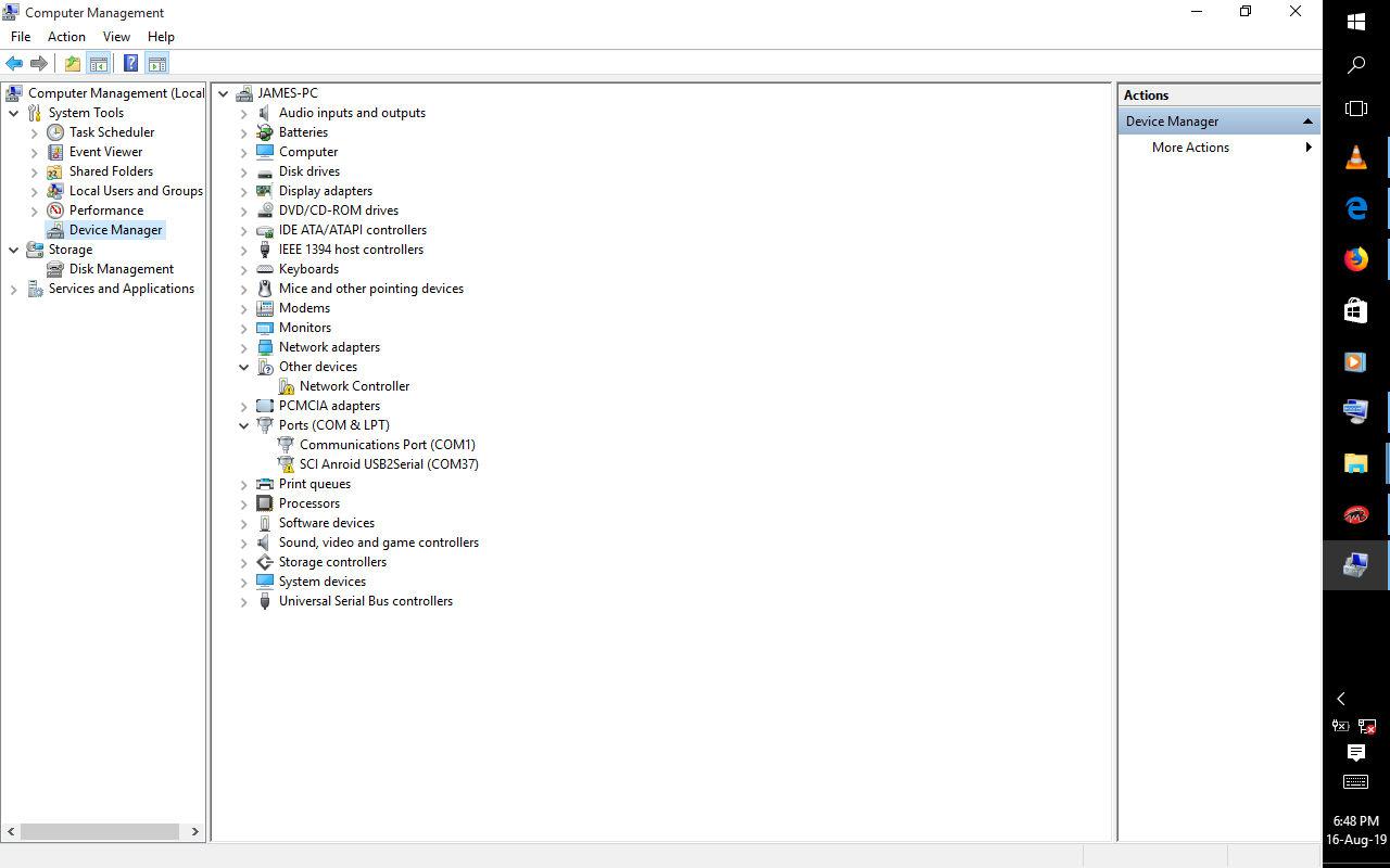

Have done all the steps above but nothing seems to happen, no device manager refresh, no any sound. below is the screen shoot

(16-08-2019, 06:05 PM)james bwalya Thanks for the infor,
try a different PC preferably one running windows 7 also try a different USB cable
