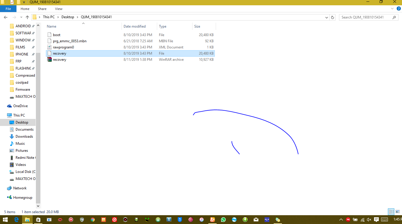

HI EVERYONE ITS BEEN A WHILE I POSTED HERE ,
AM HERE TODAY TO SE IF I CAN FIND A WAY TO MAKE A CUSTOM RECOVERY FOR MY COOLPAD 8297-T01 BUT MY PROBLEM IS THAT WHEN I TRY TO BACK THE BOOT AND STOCKĀ  RECOVERY FILES VIA MIRACLE THUNDER THE FILES ARE NOT IN .IMG FORMAT JUST RAW FORMAT WHICH MAKE THE WHOLE PROCESS HARDER FOR ME TO FIGURE OUT AM ROOTED ALREADY. AM DOING THIS BECAUSE THE PHONE IS A 4G AND 3G PHONE SIM 1 AND 2G ONLY ON SIM 2 BUT NO MATTER What i try 3g or 4g wont show up only 2g so i want to install twrp on it and flash a custom rom that might fix it

for your backup, you can rename and add a file extension e.g from recovery to recovery.img

Yes am going to send the zip file containing the recovery and boot so you can help me port a cmw or twrp

Provide the boot and recovery just as Miracle Thunder backed them up
