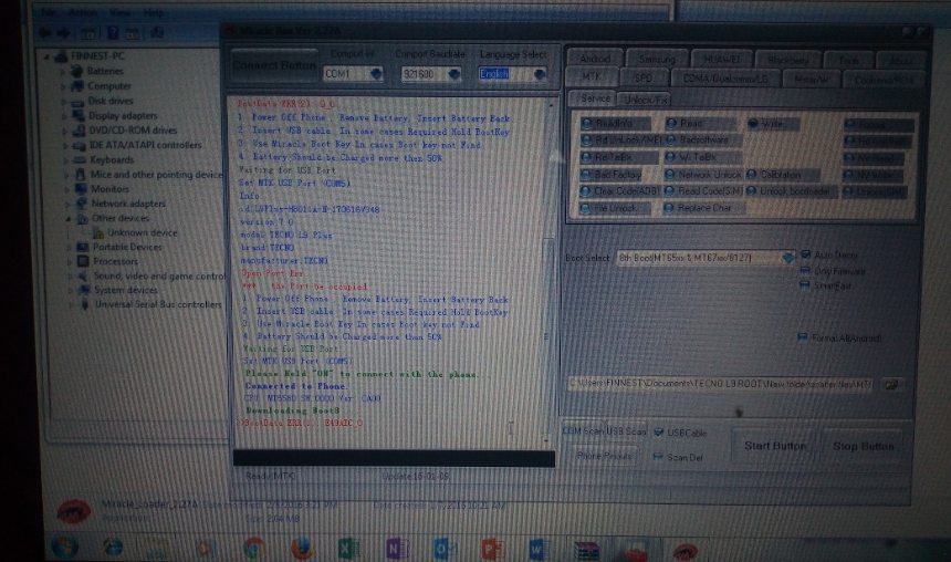

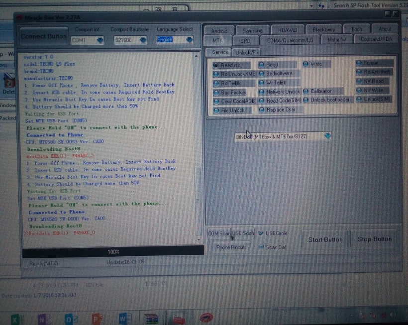

Hi. I'll really appreciate an help on my tecno L9 plus.
I rooted my phone using miracle box method about 6months ago and it has been working fine,  except recently (a month and a half)  that I noticed at times when I want to boot my phone, it'll just get stucked in the first boot page (tecno powered by android) and won't bring the next booting page (only tecno animation) I thought it isn't a big deal and whenever this happens,  I just hold the power button for 12seconds and it'll reboot and enter. Although i also noticed at times it'll just freeze while am using it and I'll have to reboot using the 12 seconds power button press and I'll continue to use my phone.
Not until 2days ago that I charged my phone up to 100% (switched off; cos I plugged it in the midnight), so I decided to switch on my phone and it got stucked at the first boot page again (tecno powered by Android), I thought it's the usual thing,  so I just used my 12 secs power button press but this time it's different; the phone went off and never came back on. I've tried that many times,  It won't come back on.
I only noticed that whenever I plug it to a laptop it gives a sound,  I checked the laptop device manager,  the driver will appear and then disappear again within 3 secs.
I remembered backing up both my scatter file and big .bin file using miracle box 2.27a.
So,  I went back for it,
What I noticed is whenever I try to read my phone through the MTK tab and clicking read, then submitting I get a Boot data ERR(1): E49AEC_0
I searched online for the sp flash tool firmware with scatter file for my exact phone model [Tecno L9 Plus (L9Plus-H8011A-N-170616V348)]  but all I see is still this miracle box stock Rom file
Can anyone kindly be of help by posting the sp flash tool firmware with scatter file for me to try or help me with a way forward with miracle box?

I have attached Screenshots below
This post was last modified: 30-07-2019, 10:43 AM by finnest.
