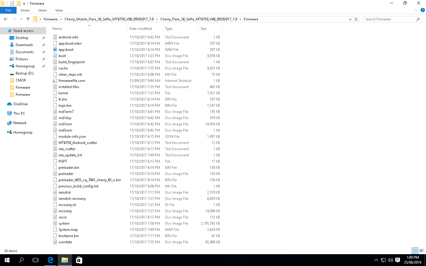

I have downloaded both firmware of s6 selfie v06 and v07 but still gives me the same error in sp flash tool. btw think I remember my phone build it has v09 in it
24-06-2019, 12:40 AM
(23-06-2019, 04:40 AM)Zenmot I have downloaded both firmware of s6 selfie v06 and v07 but still gives me the same error in sp flash tool. btw think I remember my phone build it has v09 in it
if so then try v09 firmware and post feedback, there's one listed @ https://www.needrom.com/download/cherry-...s6-selfie/ ; requires payment
