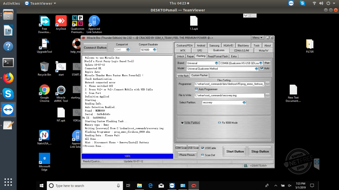

hi i tried it now
sorry for a delay
i think it worked here is the screen shot as attachment
Can you confirm if it is really done?
actually i flash the original recovery image .
So i cannt confirm as it is same image as previous one

02-05-2019, 10:59 AM
#18
(02-05-2019, 01:05 AM)rehannasim hi i tried it now
sorry for a delay
from your screenshot, flashing was successful
since you flashed original recovery image, then check if you can still boot into recovery mode
