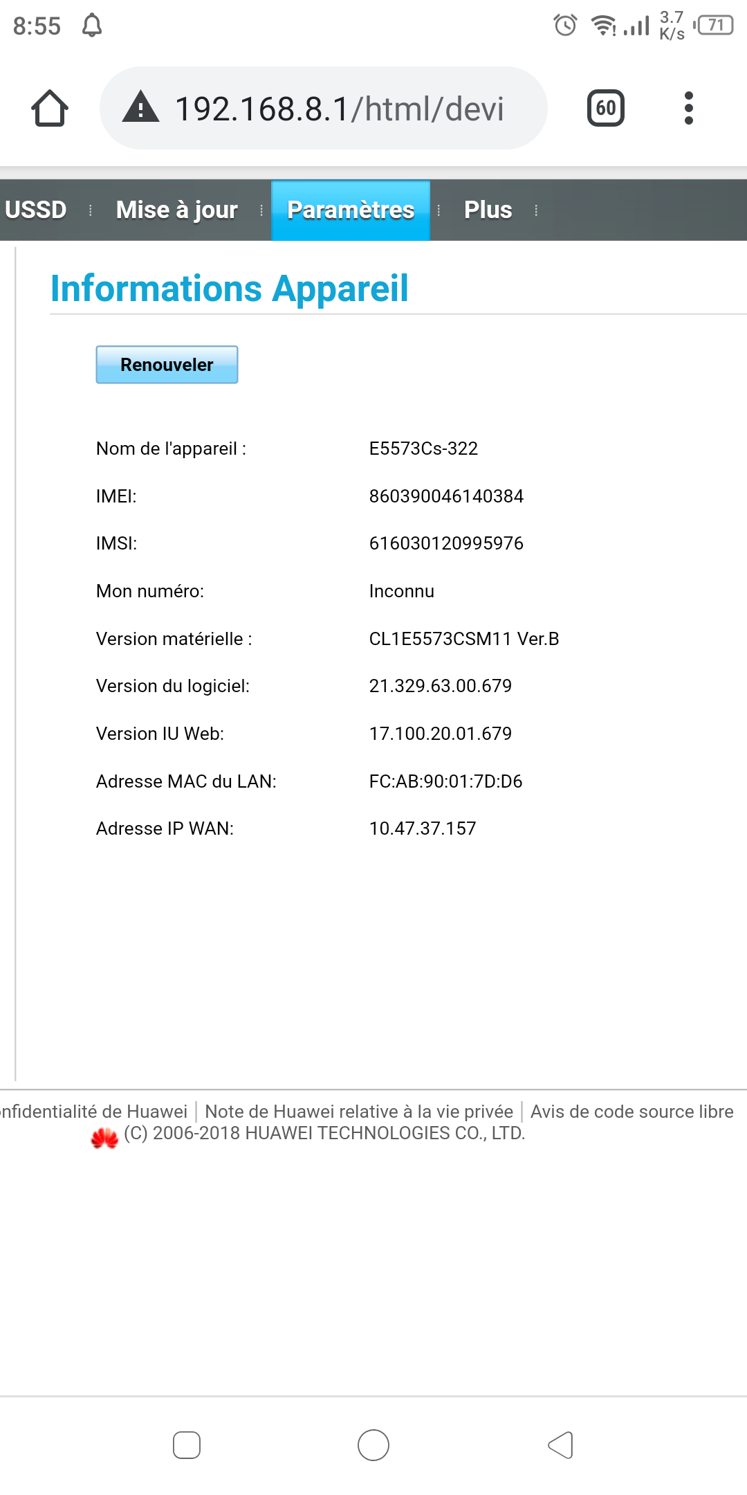

Hello dear admins. Happy new year 2021 and may the blessings be !
My E5573Cs-322 is under firmware v21.329.63.00.679. Since it's a recent firmware, I didn't try bootshot unlocking method as in accordance with the dedicated tutorial. I then tried to directly flash the unlocked firmware you've provided in this thread, for the version v21.329.63.00.1456 (which isn't my device version) hoping that it would unlock it. Unfortunately, it didn't unlock my decide and thanks to God, my device is still performing well.
I'm then looking for unlocked version to be successfully flashed on my device.
Can you then help me with unlocked firmware for version E5573Cs-322 v21.329.63.00.679 ?
Thanks in advance.
I appreciate your help.
PS: Interface screenshot with device details.

Please ! Help me have unlocked firmware for my E5573Cs-322 whose firmware is version 21.329.63.00.679 and which refusing any of the firmware you proposed below.
Thanks in adavnce.

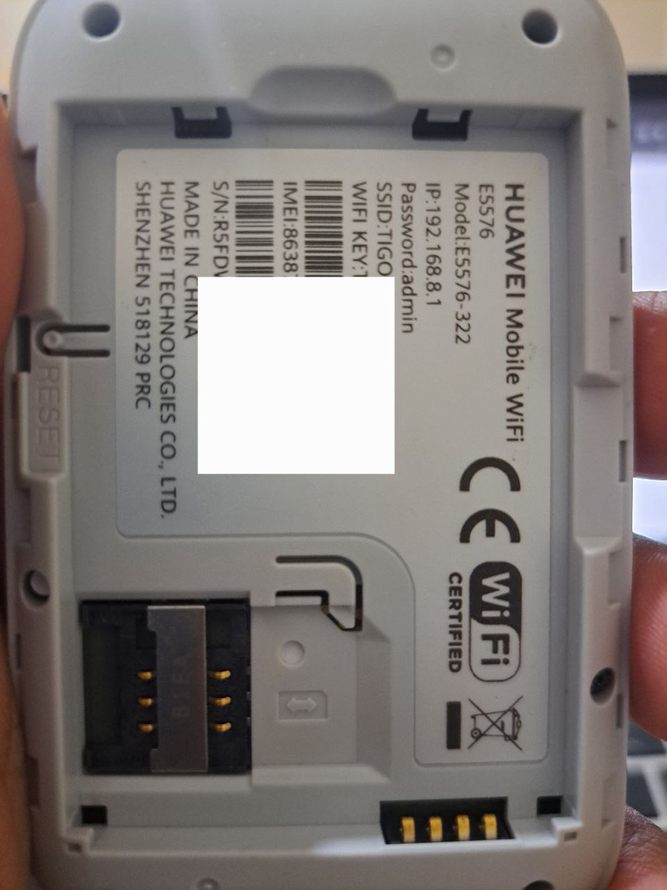

Please who can guide me
I need sim unlock code for Huawei E5576-322
Please i need help
Software version10.0.5.1(H695SP1C983)
Web UI versionWEBUI 10.0.5.1(W11SP1C7601)
