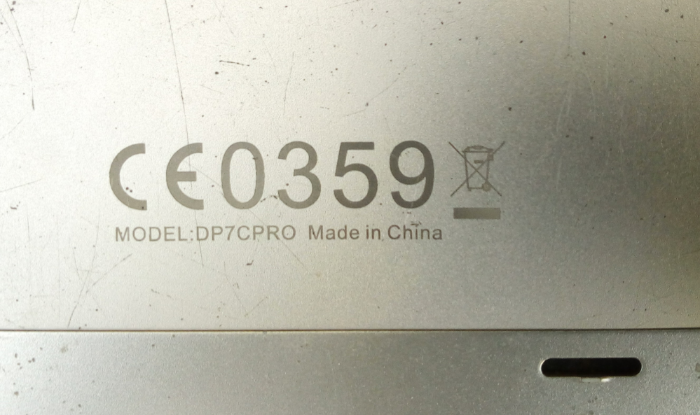

Hi. Please I've only been seeing A1 and B2 build versions of Tecno DP7CPRO online since, but the one on my phone was something like B1 (i have no way of knowing the full build number now, the phone is not starting).
So I went ahead and flashed a B2 version of the stock ROM that I downloaded from this platform, and now the phone is not going pass the Tecno logo display, neither is it booting into recovery mode. Also, when I want to charge it, it only shows the battery image, but it won't show the battery percentage.
Please I could use some help here! [I flashed with Miracle Box]

re-confirm the model of your device; 7C or 7CPro? because you posted this under 7C firmware thread
TECNO DP7CPRO-KC07T-B1-L-20160607 @ https://mega.nz/#!pE5RWYJY!8nSu4jNEcmuhW...3ig4cpNKc0

The model is DroiPad 7C Pro, I'm sure of this... But the build number of my phone before I flashed it was something like TECNO DP7CPRO-KC07T-B1-L-xxxxxxxx [I can't remember the last part]
The versions of the firmware I saw on this platform are A1 and B2, and i went ahead to flash my own phone with the B2 version i downloaded here, and now it's not starting
I'll try flashing with the B1 version you just sent, and will give you a feedback.
Thanks, i really appreciate you help

Thanks, the B1 version worked for my phone!
