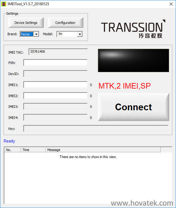

AfterSales IMEI (Transsion Aftersale) tool is a Windows application for writing IMEI on Transsion Mediatek (MTK) Android devices (Tecno, iTel, Infinix, etc).
[Image: AfterSales-IMEI-Tool.png]
Download AfterSales IMEI tool Versions
How to add models to configuration table
This is a quick guide on how to add new models to the configuration table of Aftersales IMEI tool
  • Launch IMEItool
  • Click 'Device settings' at the top left hand corner
  • In the new window that pops up, right click on any model > add model
  • A new brand named 'VILLAON' will be added
  • Double click on the name 'VILLAON' under brands > change it to the desired brand name
  • Do the same for the "models, platform, smartphone, sim , AP & BP" tabs
  • Click OK once you're done

a lot of models seem to be missing from the configuration table any idea of how they can be added?
50,906
12-02-2019, 11:08 AM
(12-02-2019, 08:22 AM)Jaxo Jaxo a lot of models seem to be missing from the configuration table any idea of how they can be added?
just included,
check the first post for the title -- 'How to add models to configuration table'

has anyone successfully written imei with it, the phone gets ro meta mode but the tool seems never to continue from their and then it gives several errors "Failed to write imei" "imei length too short"
10,418
13-02-2019, 01:18 PM
(13-02-2019, 09:52 AM)Jaxo Jaxo has anyone successfully written imei with it, the phone gets ro meta mode but the tool seems never to continue from their and then it gives several errors "Failed to write imei" "imei length too short"
Make sure to insert a valid IMEI and should be 15digits.
If the problem still persist then there are other methods for writing IMEI @ https://www.hovatek.com/forum/thread-116.html
