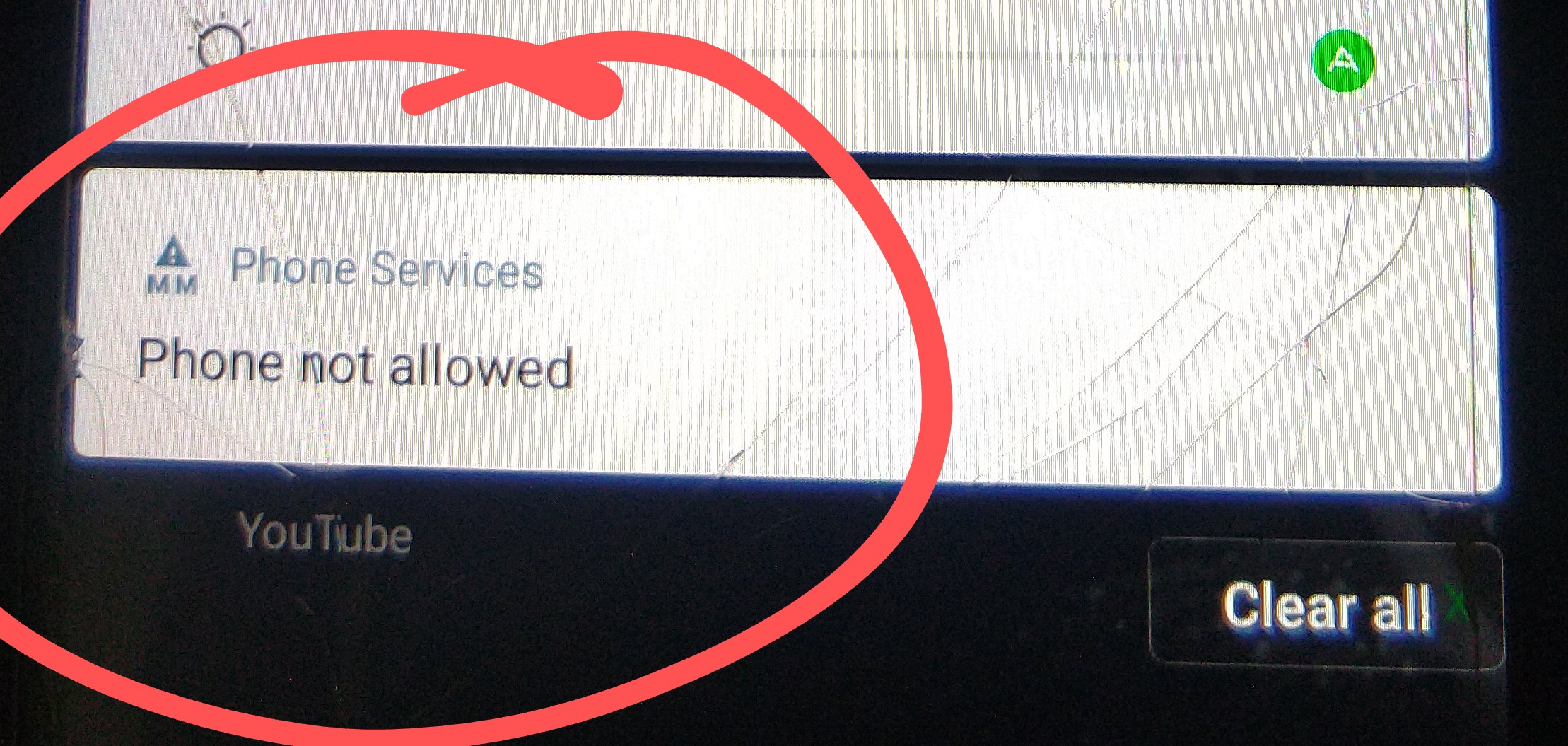

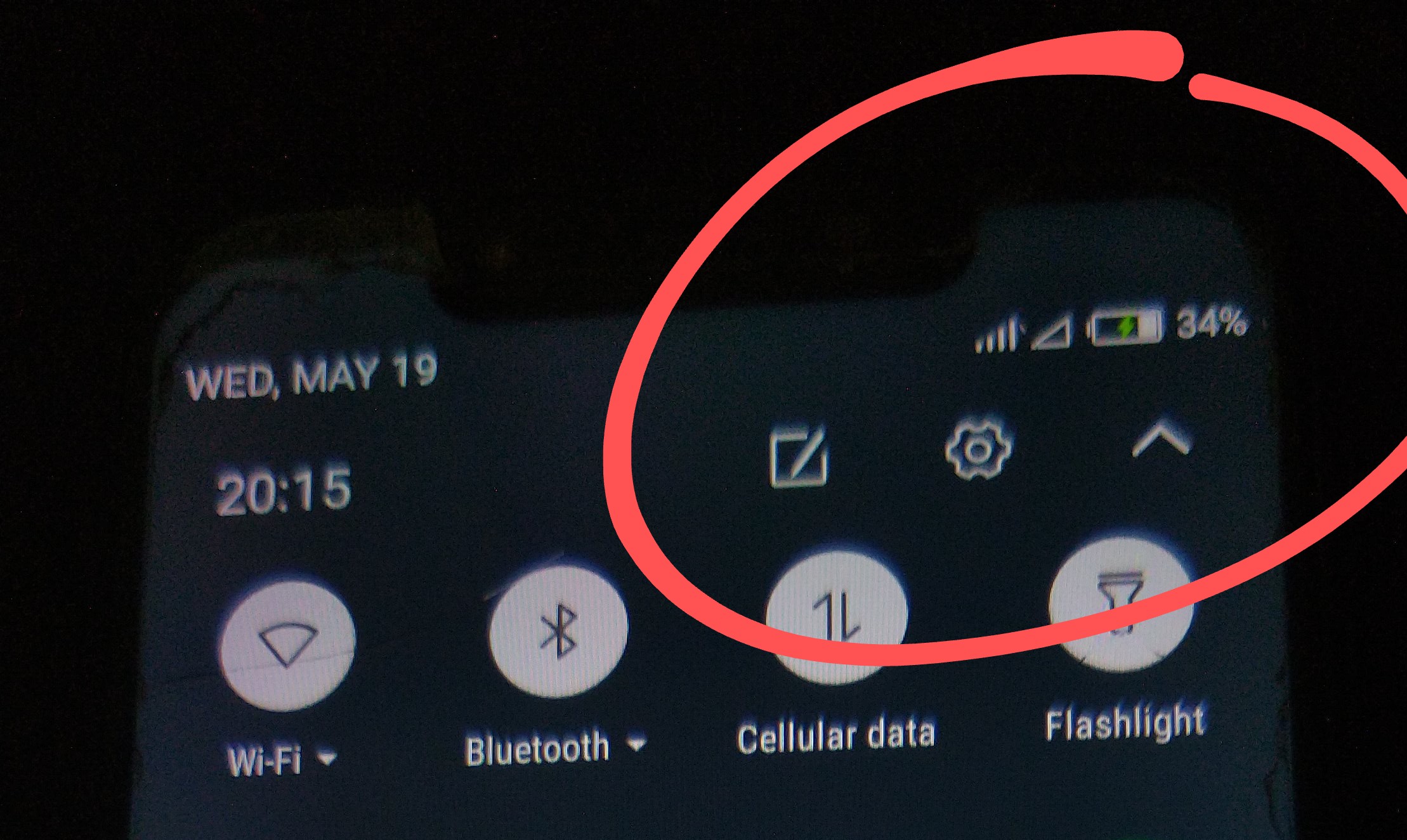

I have noticed a small problem with the device dual sim network. It can only show network for one simcard yet both are active on the device. Has anyone encountered such problem?
Seen attached photos.

(20-05-2021, 04:44 PM)avwova I have noticed a small problem with the device dual sim network. It can only show network for one simcard yet both are active on the device. Has anyone encountered such problem?
create a new thread for this by clicking "ask question" at the top
in the new thread, explain how this problem started also confirm if both sims are enabled in sim card manager in settings
