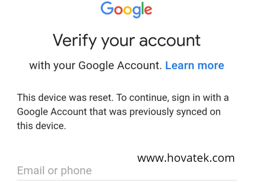

This guide will explain how to bypass Factory Reset Protection (FRP) on a Qualcomm Android device using Miracle box. You get the FRP screen when you do a factory reset (from recovery mode) on a Qualcomm Android device which has already been associated with a Google Account. The FRP screen will lock you out until you supply the username (email address) and password of the Google account which had been linked to the device prior to the reset.
[Image: Qualcomm-Google-Account-FRP-bypass.jpg]

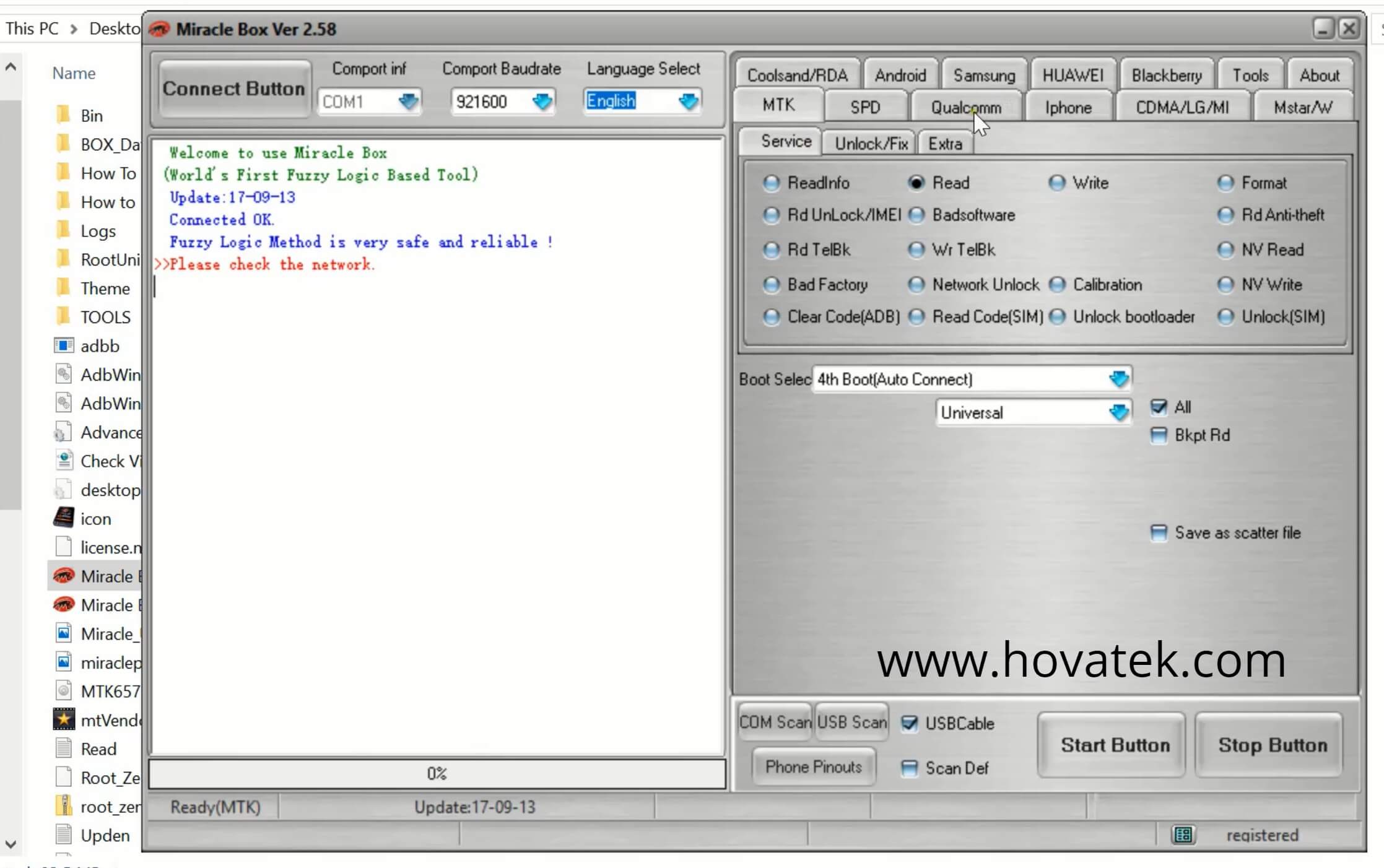

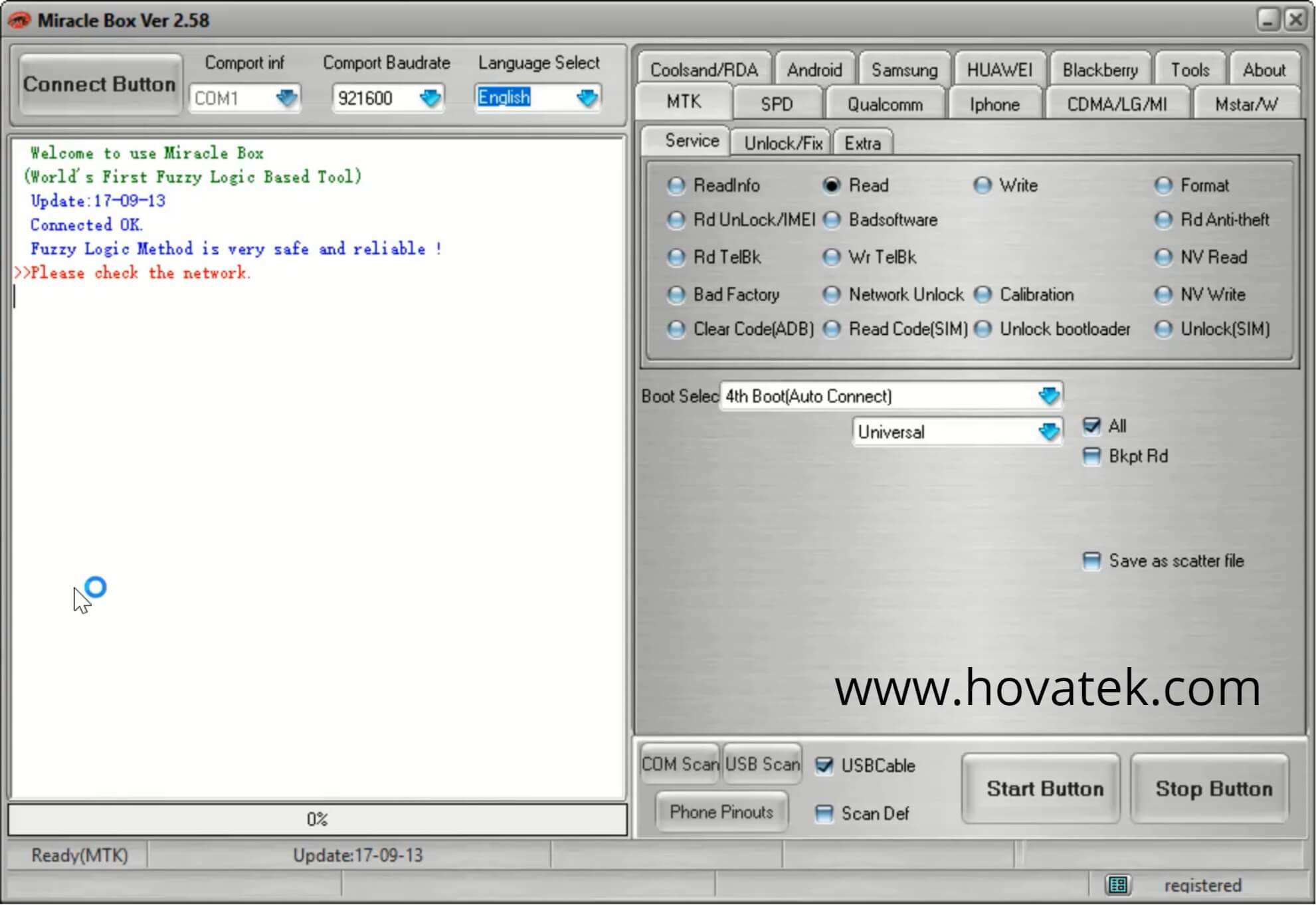

  1. Launch Miracle box
    [Image: How-to-use-Miracle-Box-to-bypass-FRP-on-...ices-1.jpg]

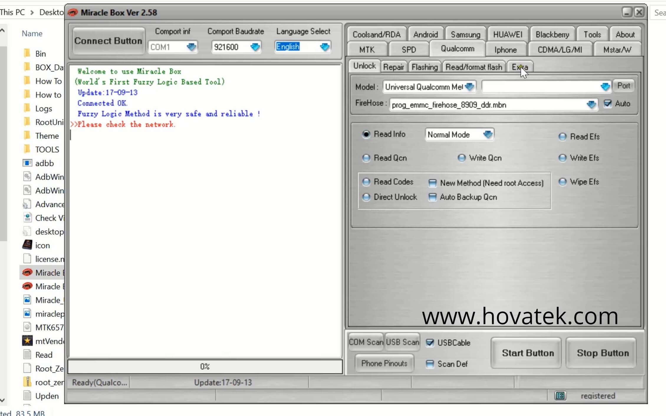

  2. Click the Qualcomm tab
    [Image: How-to-use-Miracle-Box-to-bypass-FRP-on-...ices-2.jpg]

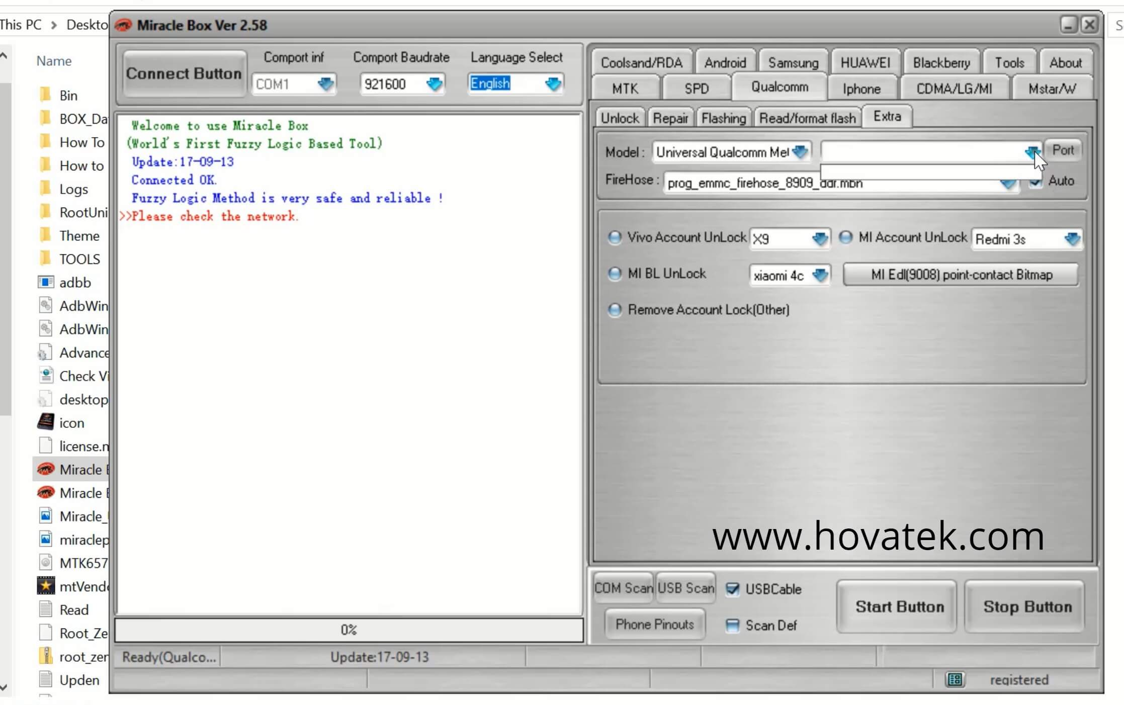

  3. Click the Extra tab
    [Image: How-to-use-Miracle-Box-to-bypass-FRP-on-...ices-3.jpg]

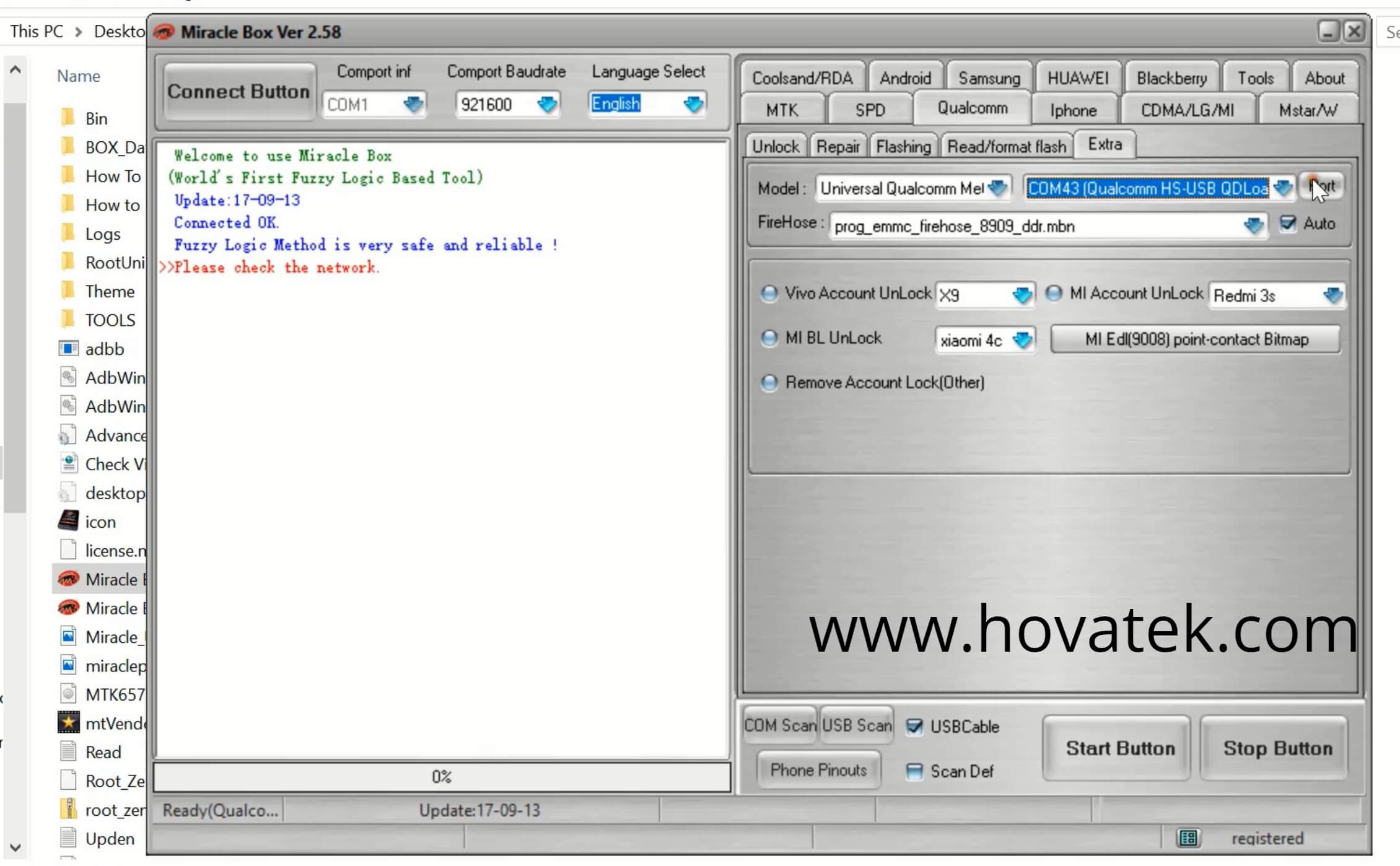

  4. You'll notice that Port is empty
    [Image: How-to-use-Miracle-Box-to-bypass-FRP-on-...ices-4.jpg]

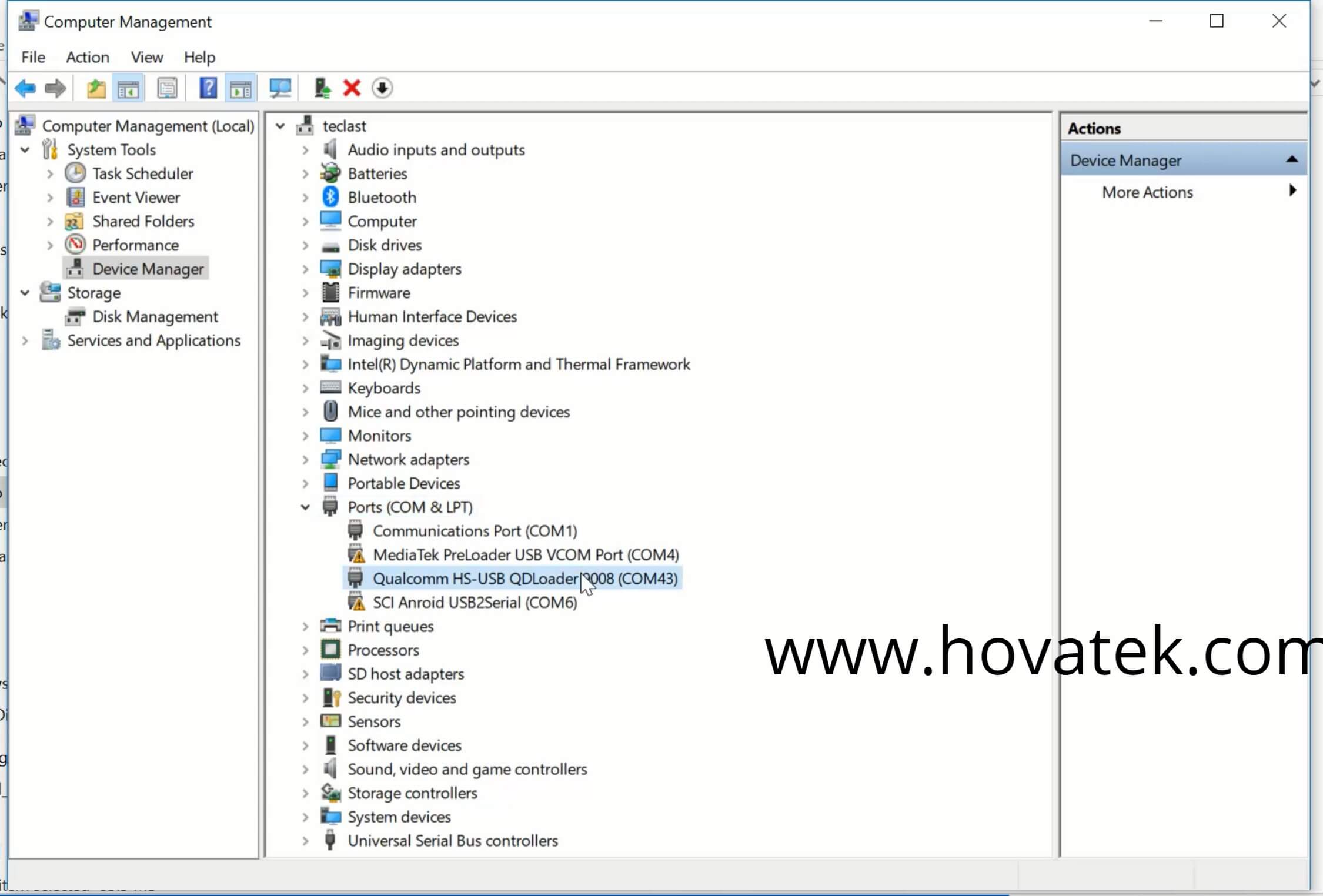

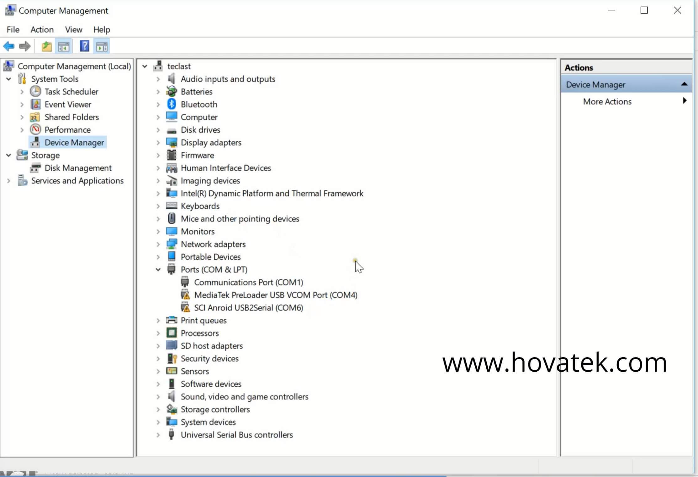

  5. Launch Device Manager and take note of the entries under Ports (COM & LPT)
    [Image: How-to-use-Miracle-Box-to-bypass-FRP-on-...ices-5.jpg]
  6. Boot the device into Emergency Download (EDL) mode then connect to PC. You should see Qualcomm HS-USB QDLoader 9008
    [Image: How-to-use-Miracle-Box-to-bypass-FRP-on-...ices-6.jpg]

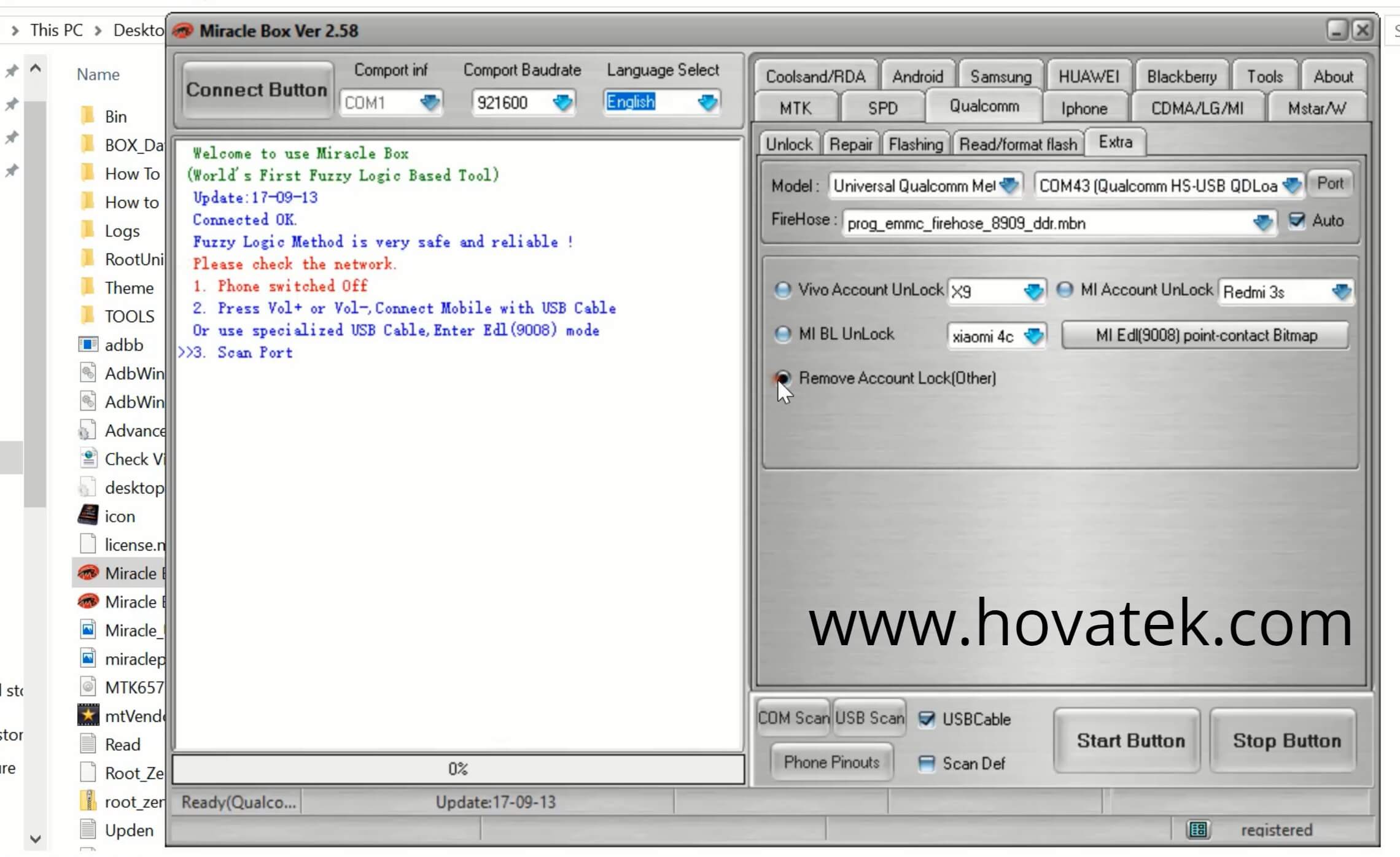

  7. Go back to Miracle box then click Port. The device should get detected.
    [Image: How-to-use-Miracle-Box-to-bypass-FRP-on-...ices-7.jpg]
  8. Tick Remove Account Lock (Other)
    [Image: How-to-use-Miracle-Box-to-bypass-FRP-on-...ices-8.jpg]

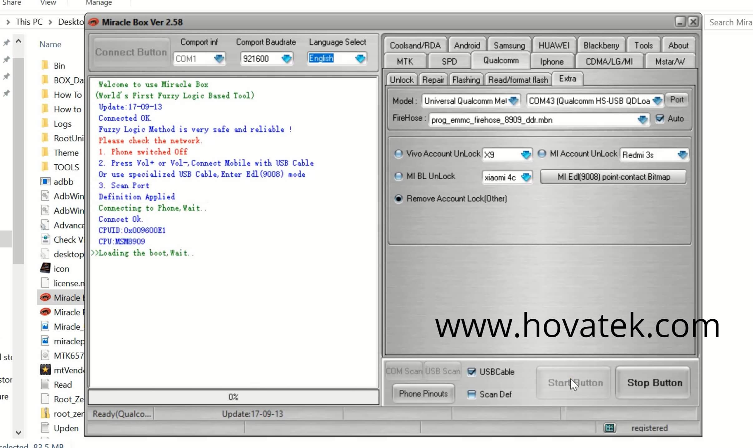

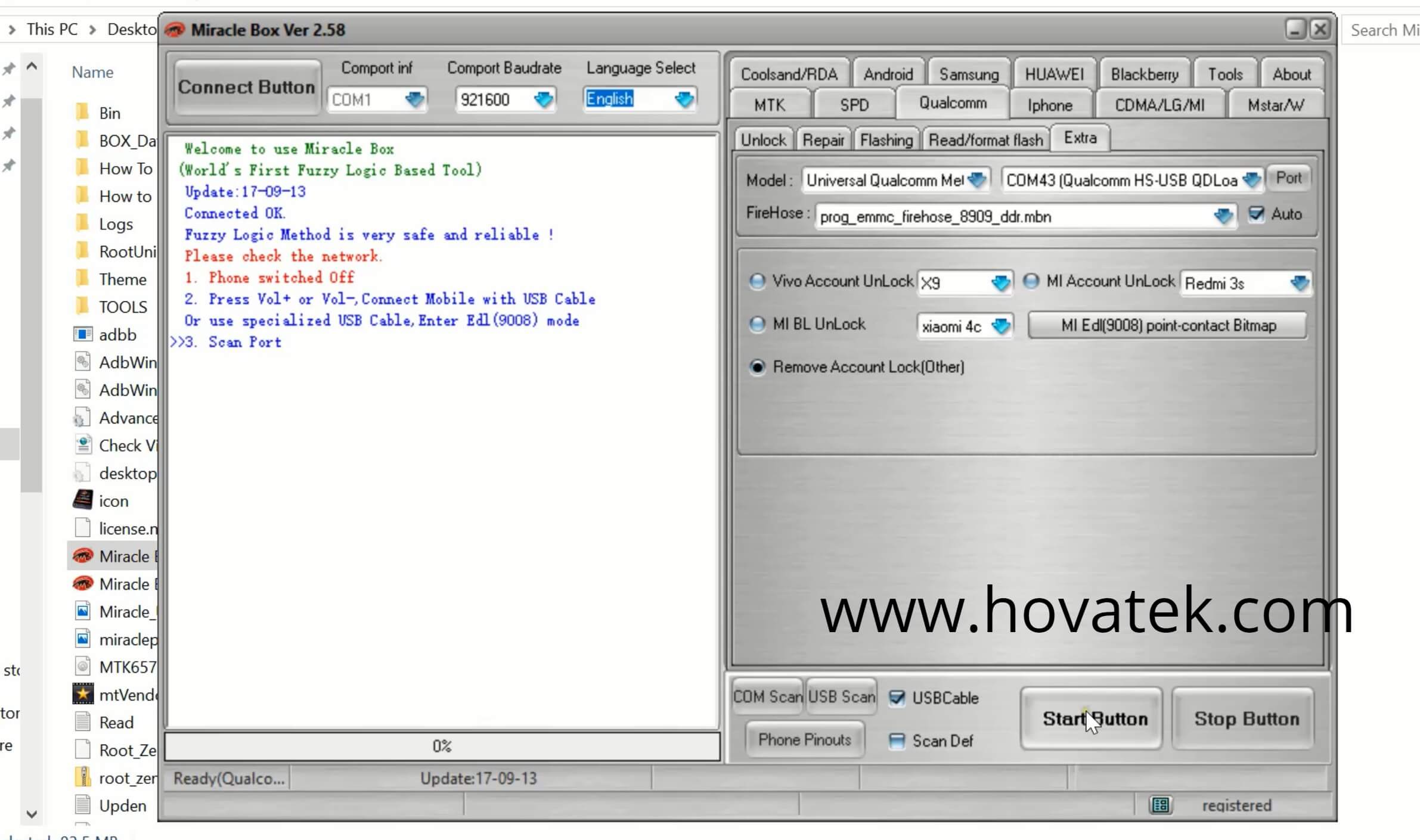

  9. Click Start Button
    [Image: How-to-use-Miracle-Box-to-bypass-FRP-on-...ices-9.jpg]

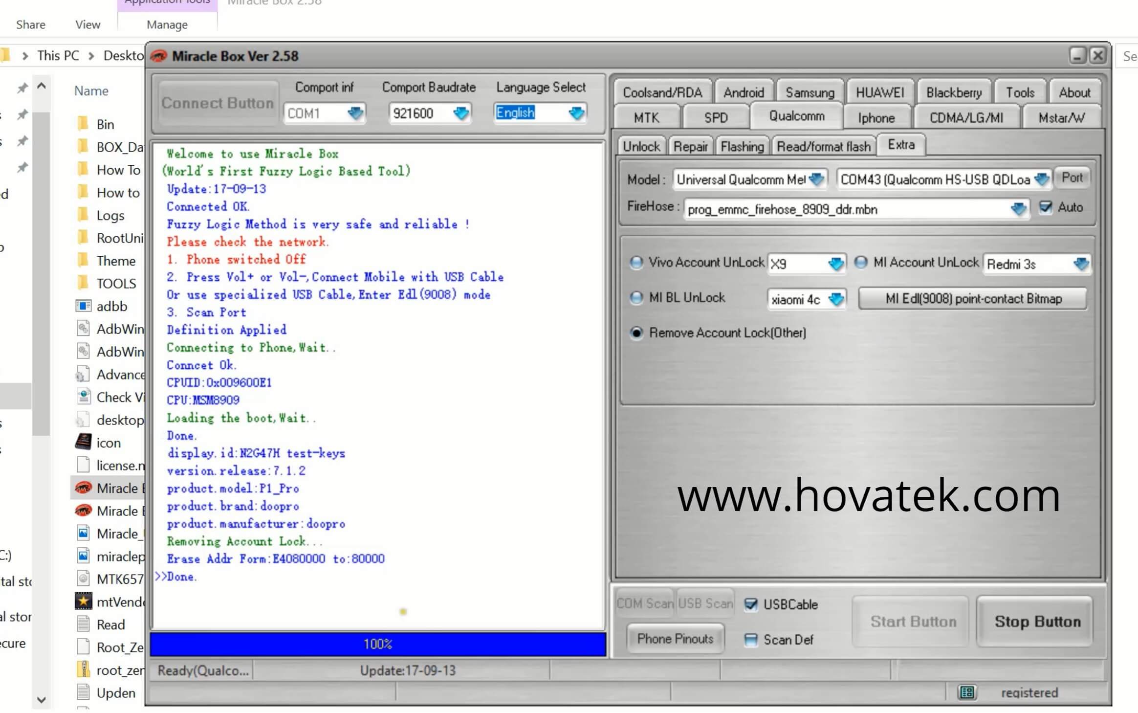

  10. Wait while Miracle box bypasses the FRP lock
    [Image: How-to-use-Miracle-Box-to-bypass-FRP-on-...ces-10.jpg]
  11. You should get a Done message once FRP lock has been bypassed / removed
    [Image: How-to-use-Miracle-Box-to-bypass-FRP-on-...ces-11.jpg]

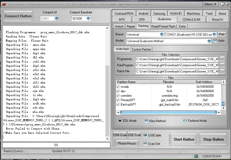

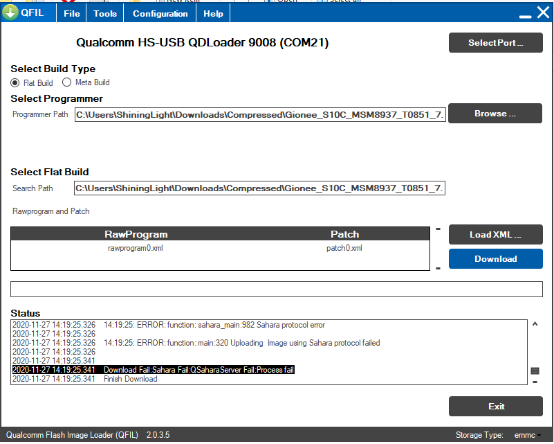

28-11-2020, 08:41 PM
good evening everyone
I have gionee s10c which i tried removing frp with miracle box but i was get no answer so i used frp reset tool to reset it. but after resetting it the phone is no longer pass gionee logo.
and I notice anytime i on the phone this message always display "your device has been loaded with different operating system"
I want to flash the the phone which i have download the firmware for the device but i keep getting this error if i used qfil (Download Fail: Sahara Fail: QsaharaSever Fail: Process fail)
while on miracle box (error fail to connect with phone >> make sure you select the correct port)
please i need your help on this i have screenshot the error.
This post was last modified: 28-11-2020, 08:53 PM by osas2luv.

51,003
30-11-2020, 10:06 AM
(28-11-2020, 08:41 PM)osas2luv good evening everyone
Create a new thread for this by clicking Ask Question at the top
