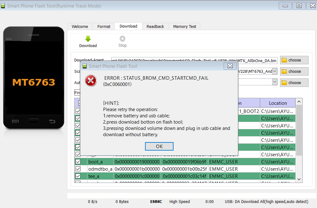

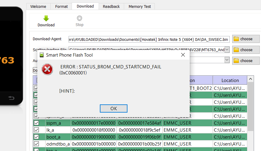

(20-10-2018, 03:21 PM)ayubloaded The Error it shows anytime I try to flash it is ::: ERROR : STATUS_BROM_CMD_STARTCMD_FAIL(0xC006001).
1. Phone several function stopped after I flashed it with wrong boot.img. After that I wanted to Flash it completely with SP Flash tool in the process Phone does not boot till now.
just before the phone went totally dead, was the flashing process successful with a green tick OR it ended with an error or by you?

(20-10-2018, 04:28 PM)X3non
The flashing was not successful with a green tick. It gave me an error when I hit the download button and I stopped. Next is I tried to switch on the phone but it does not respond till this moment.

(20-10-2018, 04:37 PM)ayubloaded The flashing was not successful with a green tick. It gave me an error when I hit the download button and I stopped. Next is I tried to switch on the phone but it does not respond till this moment.
the phone is likely just stuck at flash mode, refer to https://www.hovatek.com/forum/thread-808.html
disconnect / reconnect the battery of the device

(20-10-2018, 07:59 PM)X3non
I just tried something wierd and the phone turned on.. I hold the power button for more than 30 secs. Thanks for your time, l. You're appreciated Sir!!!!
