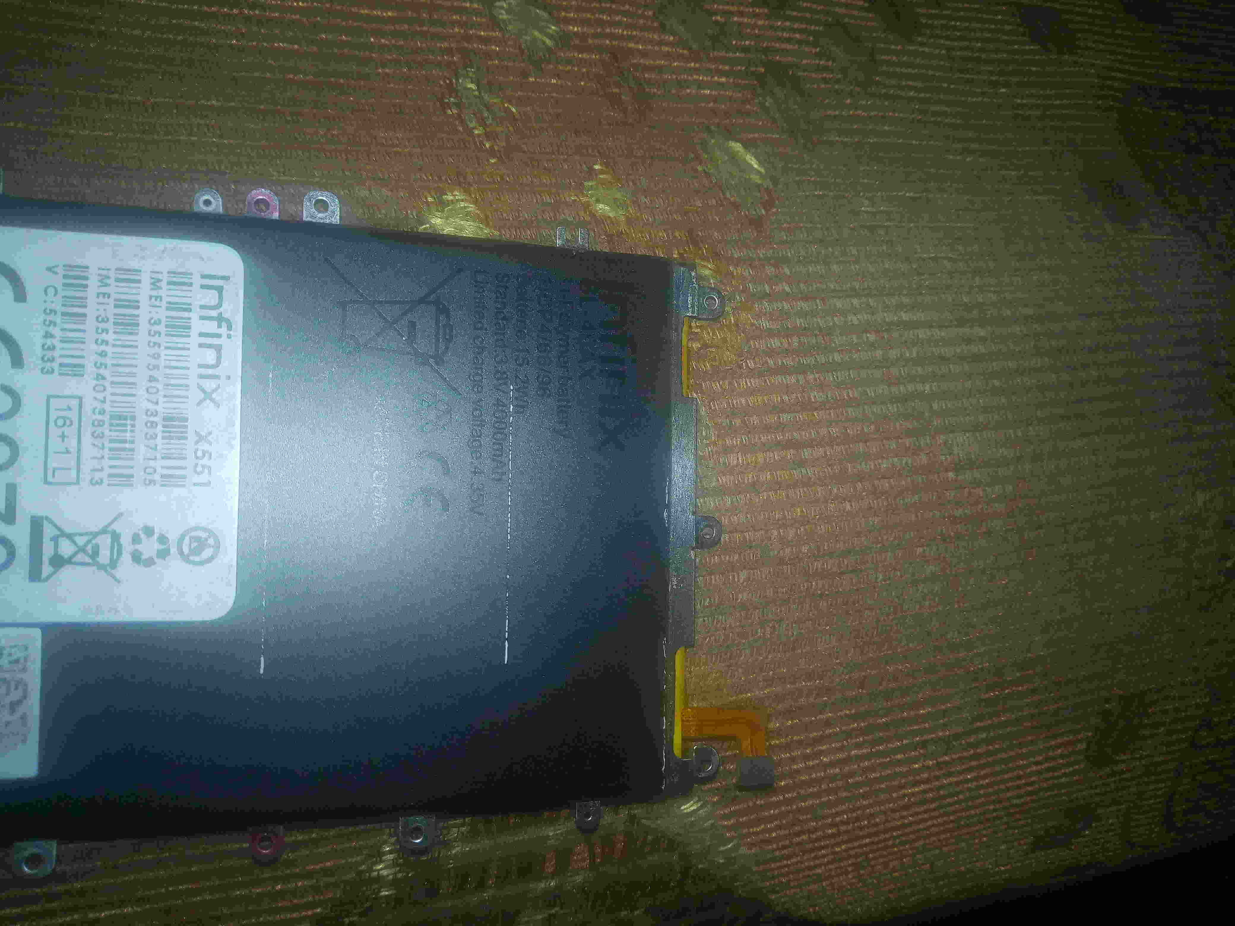

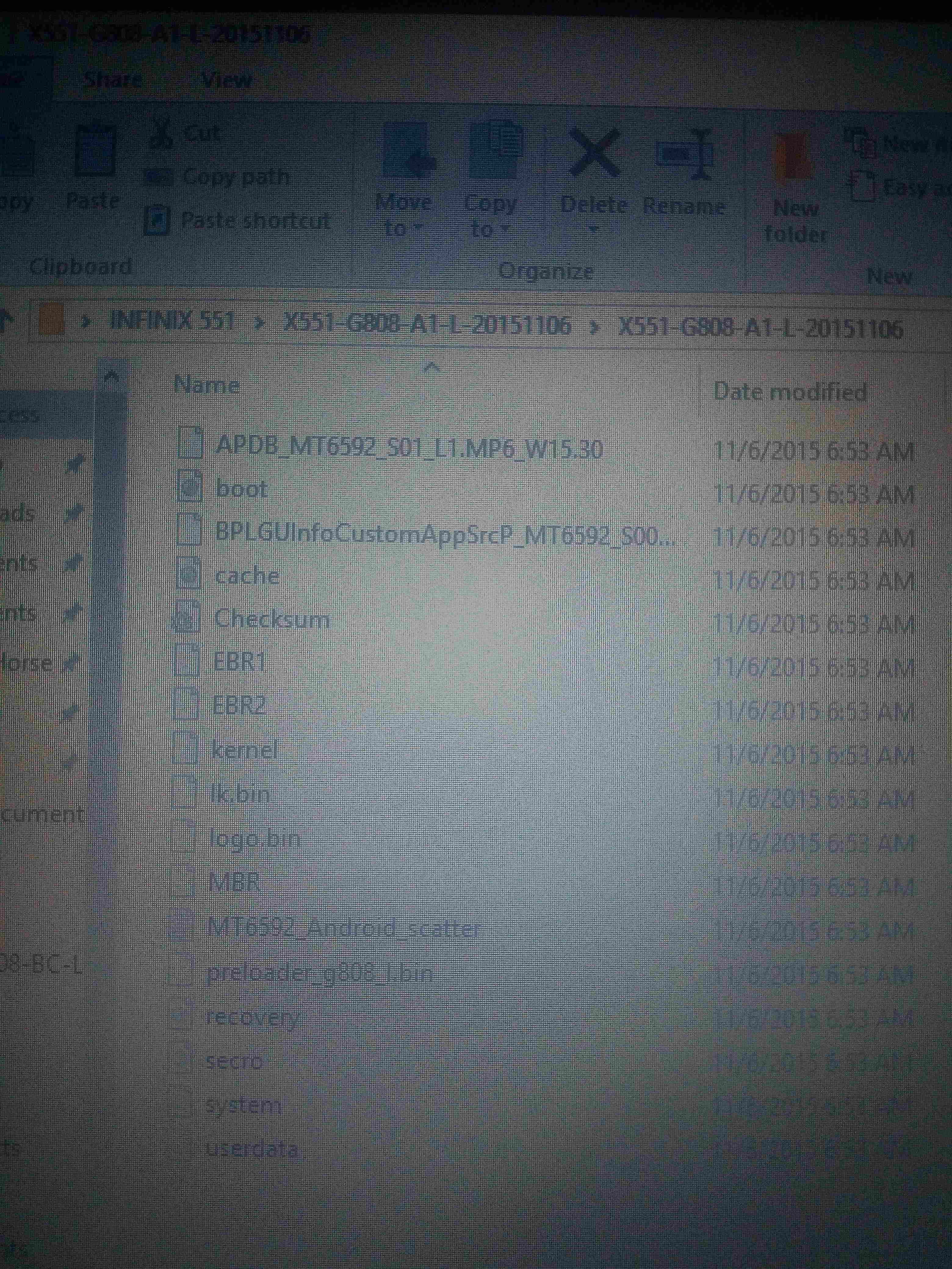

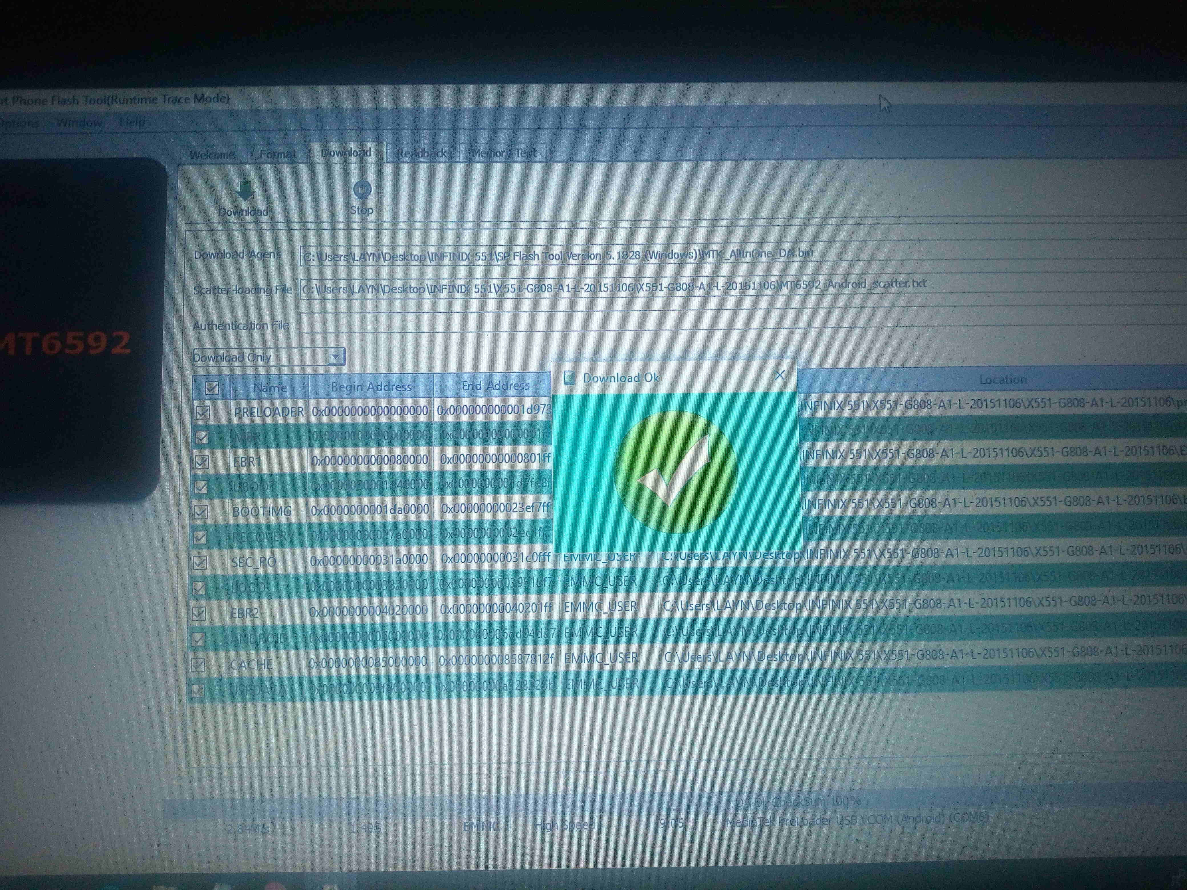

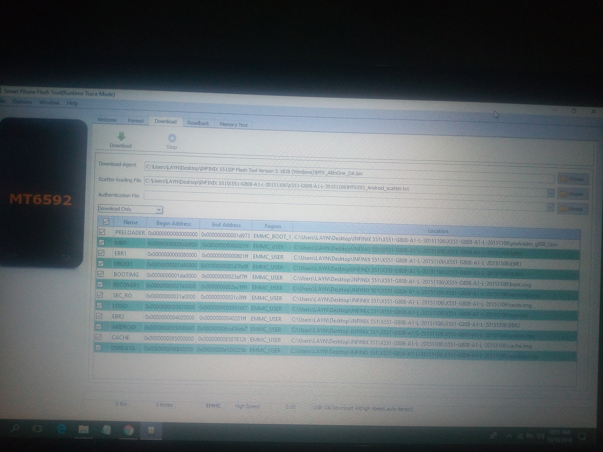

Show us the contents of the firmware you flashed, and also show us a screenshot of spft when you have loaded the file, and a screenshot of the labels on your battery
That is 3 shots we need to see

I've attached the screenshots. Please access them and see whether you might know a solution. Thanks mate

Everything you posted is as they should be.
Maybe you should try another firmware, I will suggest kitkat.
If it still doesn't work, then consider hardware problems.
