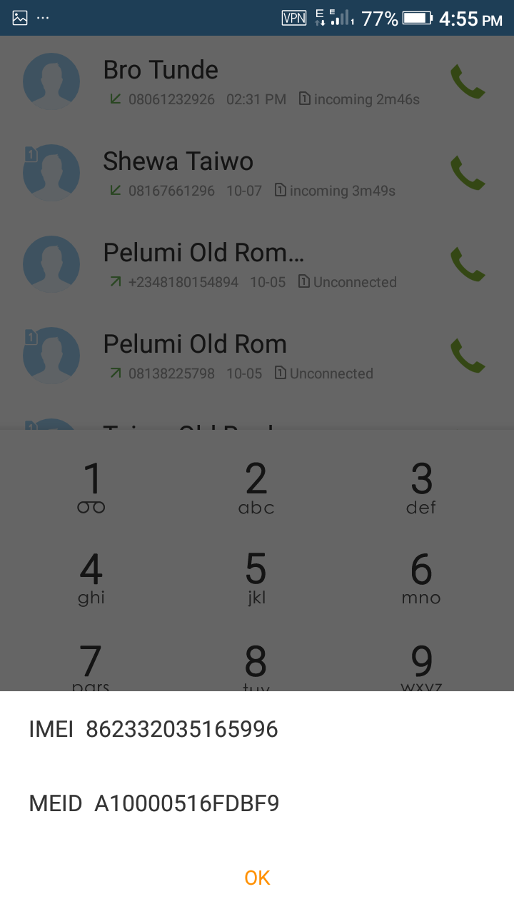

Use *#06# to check IMEI and see if they match those at the battery compartment.

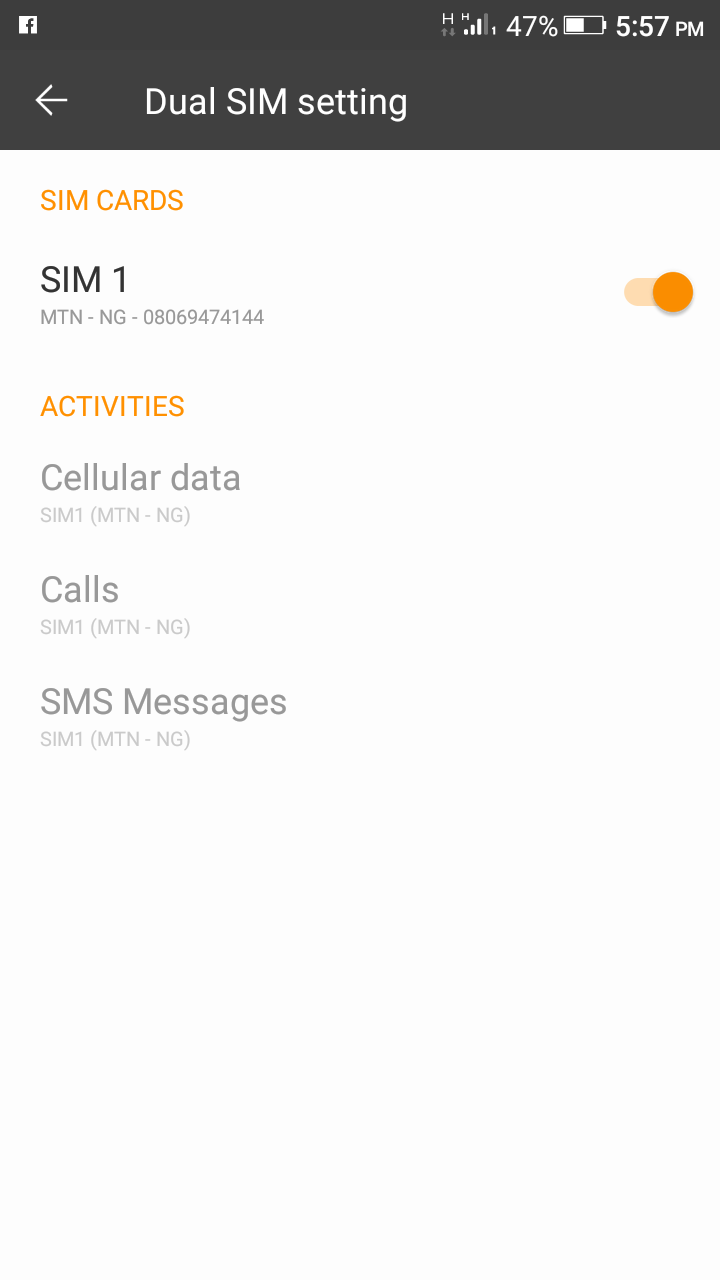

12-10-2018, 05:31 AM
[attachment=5656 hovatek pid='150543' dateline='1539244908']
(09-10-2018, 10:36 AM)abbey2u I have been trying so hard to make it work but it won't work. I have used different SIM cards to know what was going on with it but it won't work again. I have tried everything hardwarely possible but it appears all the effort and time are to no avail. Therfore, hovatek please kindly help me. Even if you would ask for token I will pay. The phone was bought UK used last month. When I bought it, I don't have the second SIM with me to test it works. Upon inserting the second second, I discovered that it did not work. It ought to have given a message that second SIM is not inserted, but no, it doesn't show any sign of second SIM in the network bar.
Start by checking the bands supported by the phone.
Install Shortcut Master (lite) from playstore .
Use Method 3 @ https://www.hovatek.com/forum/thread-664.html as a guide to using the app
Go to EngineerMode from which you can go to BandSelect or BandMode .
Lets see screenshots of that screen
Thanks for the tips. I have not actually tried it yet but want to show you the screen shot of the imie and possibly you can see the network bar. It just shows only one network bar which is for sim 1 slot.

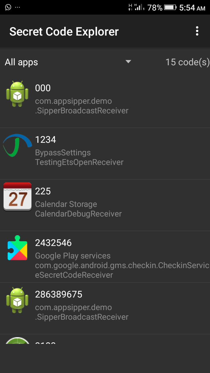

12-10-2018, 05:59 AM
(11-10-2018, 09:01 AM)hovatek
This is the screen shot of the shortcut master I did not see engineer mode on the list.

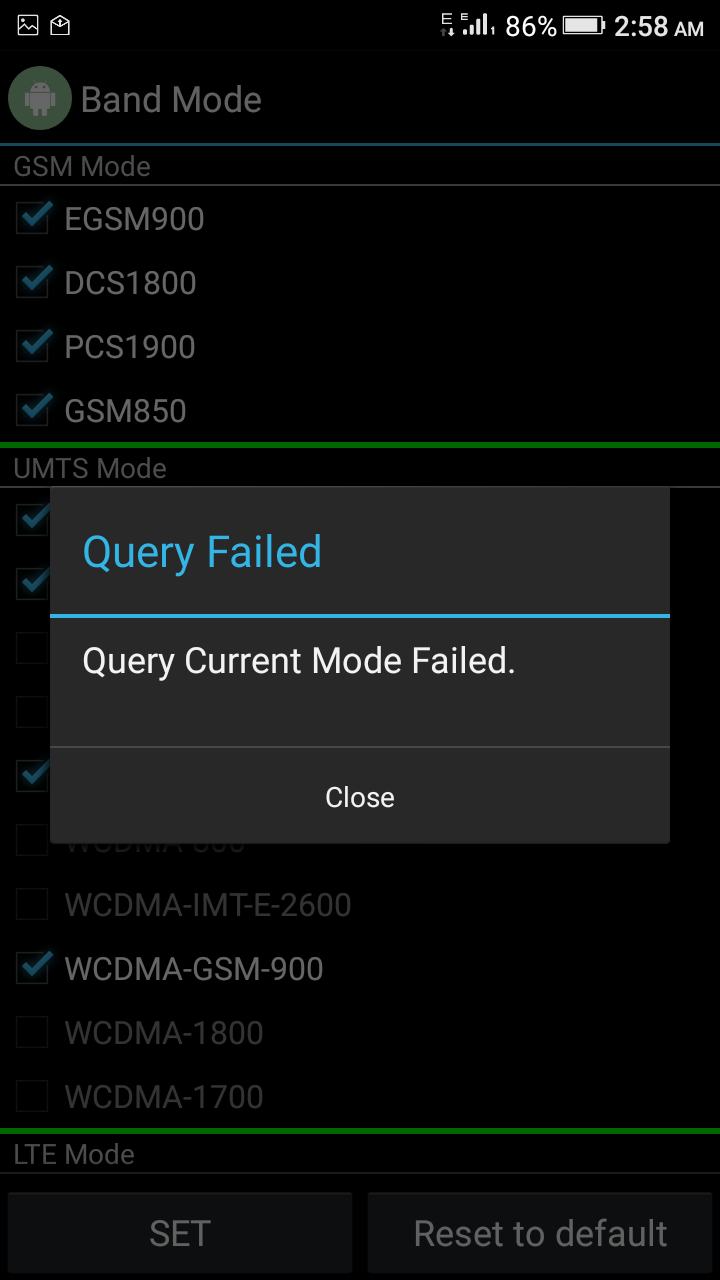

12-10-2018, 04:03 PM
(12-10-2018, 05:59 AM)abbey2u This is the screen shot of the shortcut master I did not see engineer mode on the list.
download engineering mode apk from playstore or from the link @ https://play.google.com/store/apps/detai...rter&hl=en
launch it > MTK settings > band mode
take a screenshot of what you see there

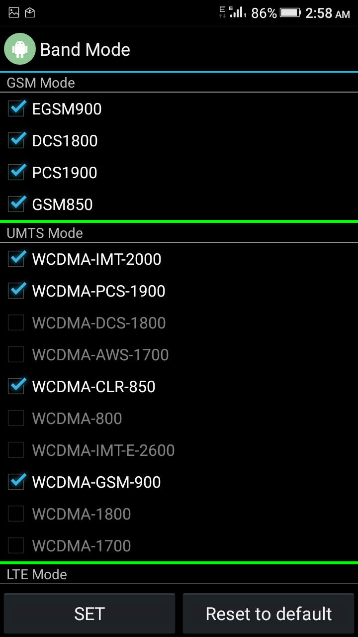

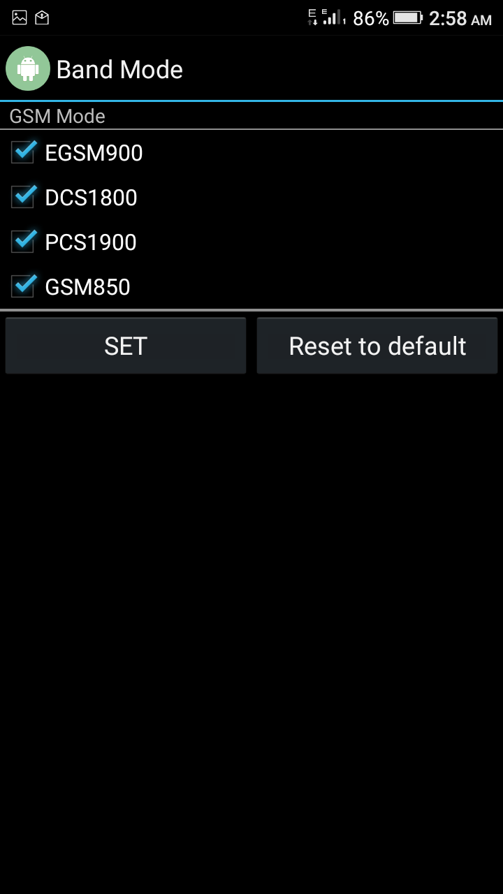

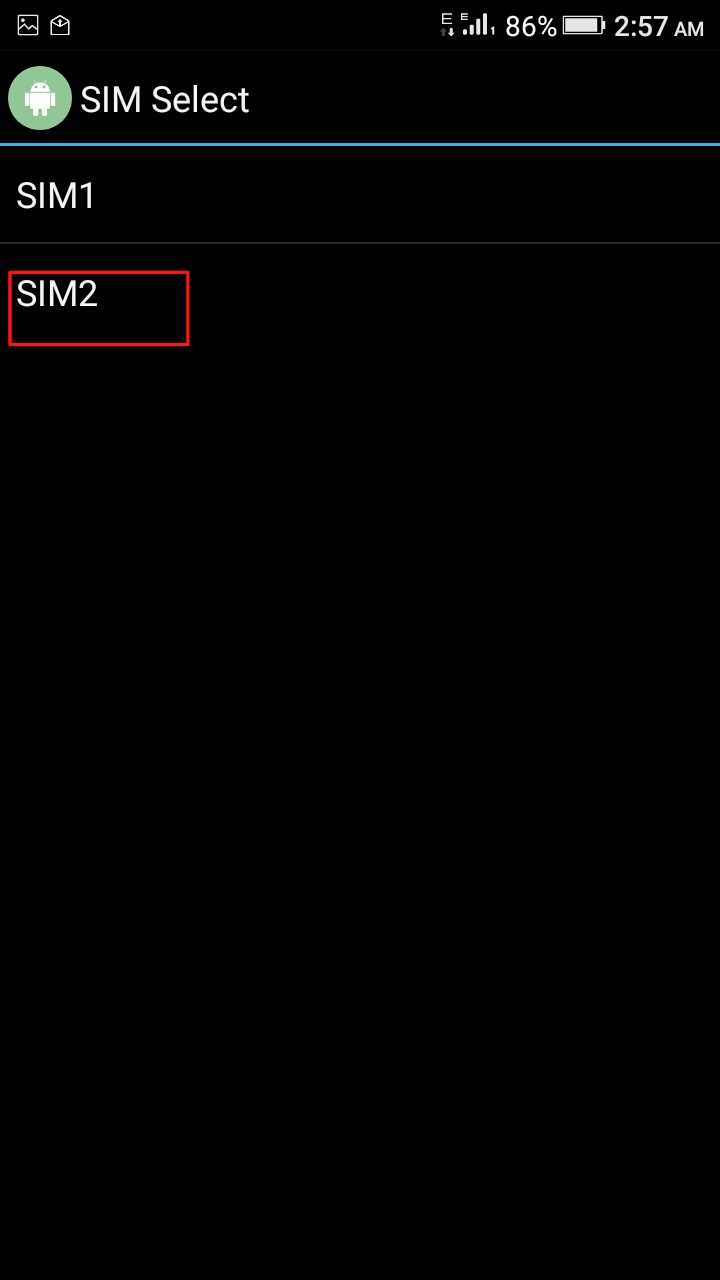

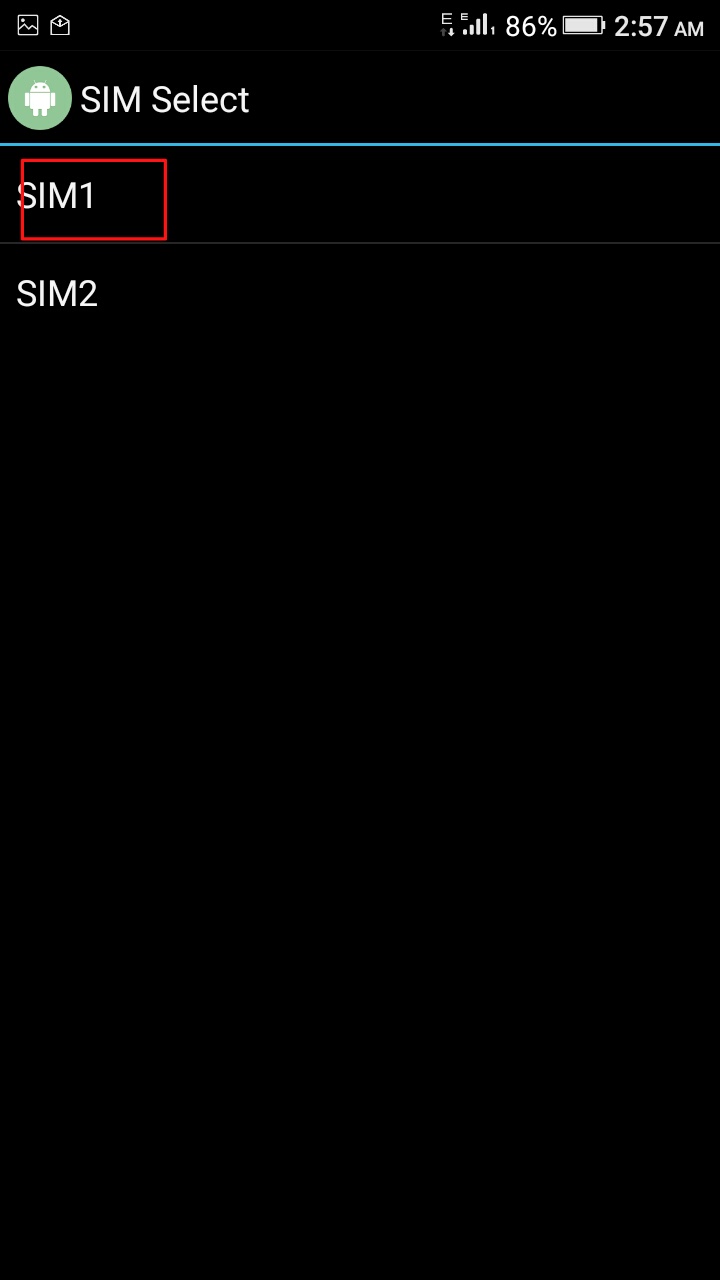

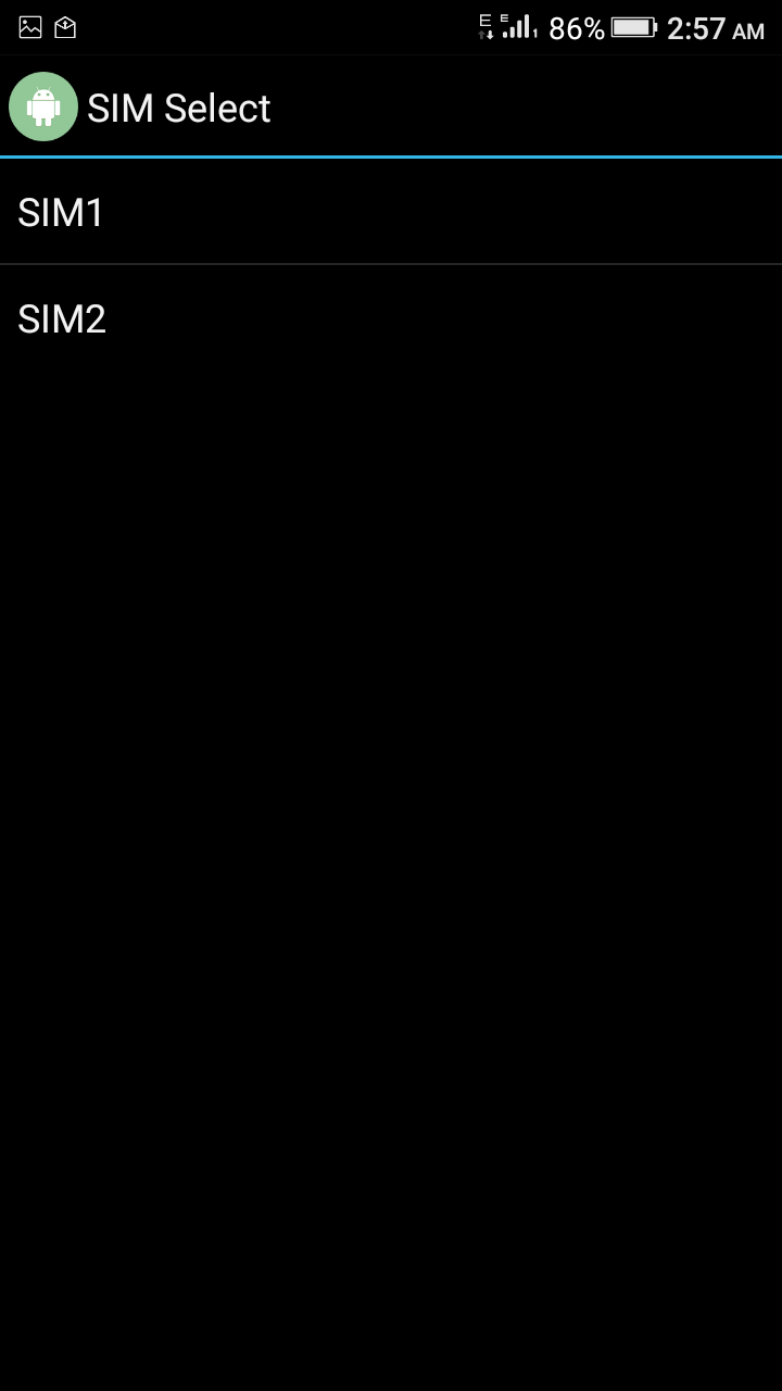

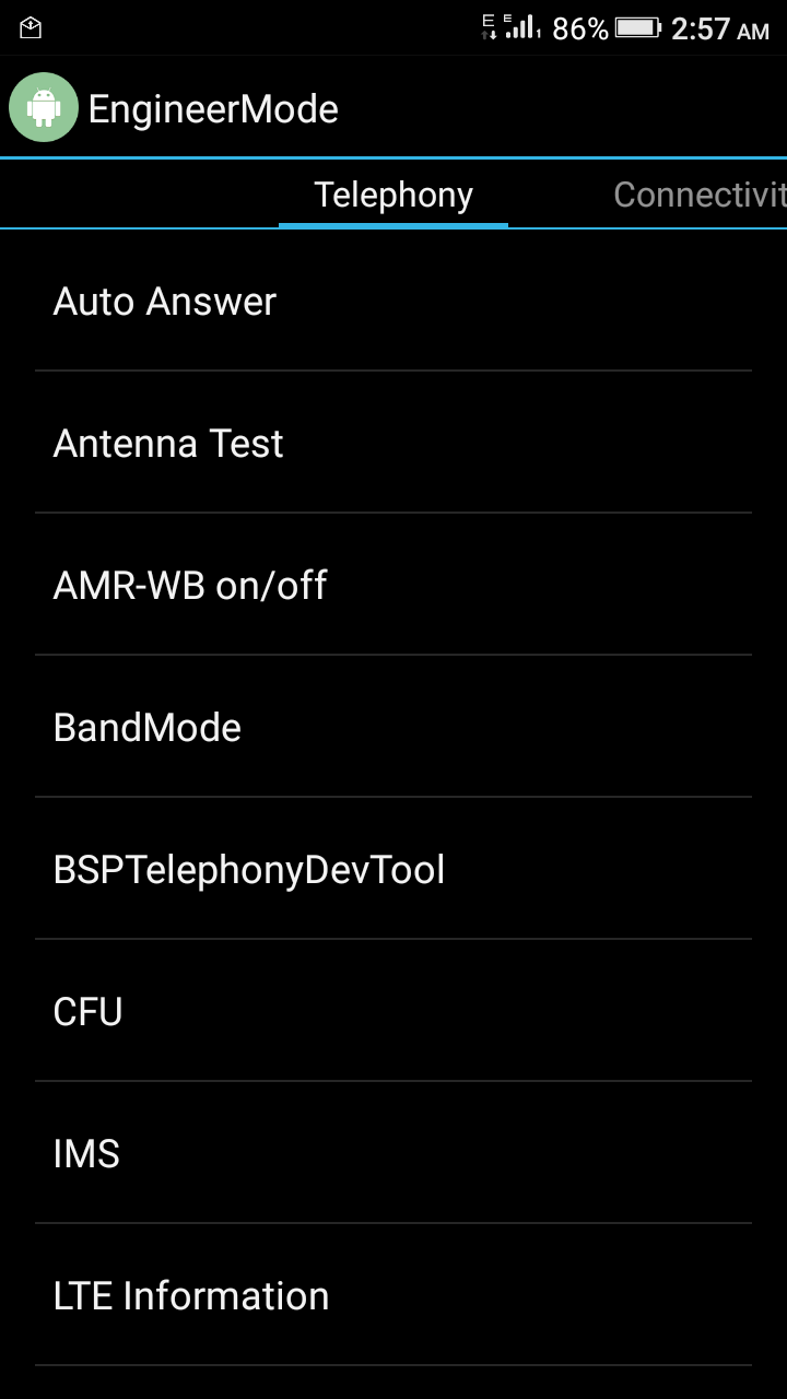

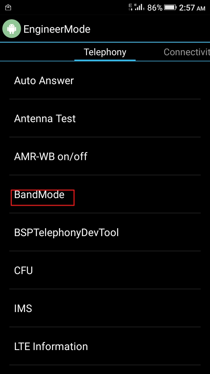

13-10-2018, 03:08 AM
(12-10-2018, 04:03 PM)freshtyt
These are the screen shots of the engineer mode
