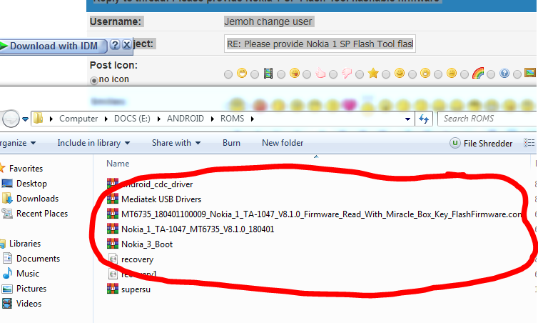

This is one of the roms i have. its the first one i downloaded. See the screenshot

(05-09-2018, 07:00 PM)Jemoh This is one of the roms i have. its the first one i downloaded. See the screenshot
when you load this rom into sp flash tool along with the DA file and try flashing, do you get any error message?
if yes, whats the error message [attach a screenshot]
