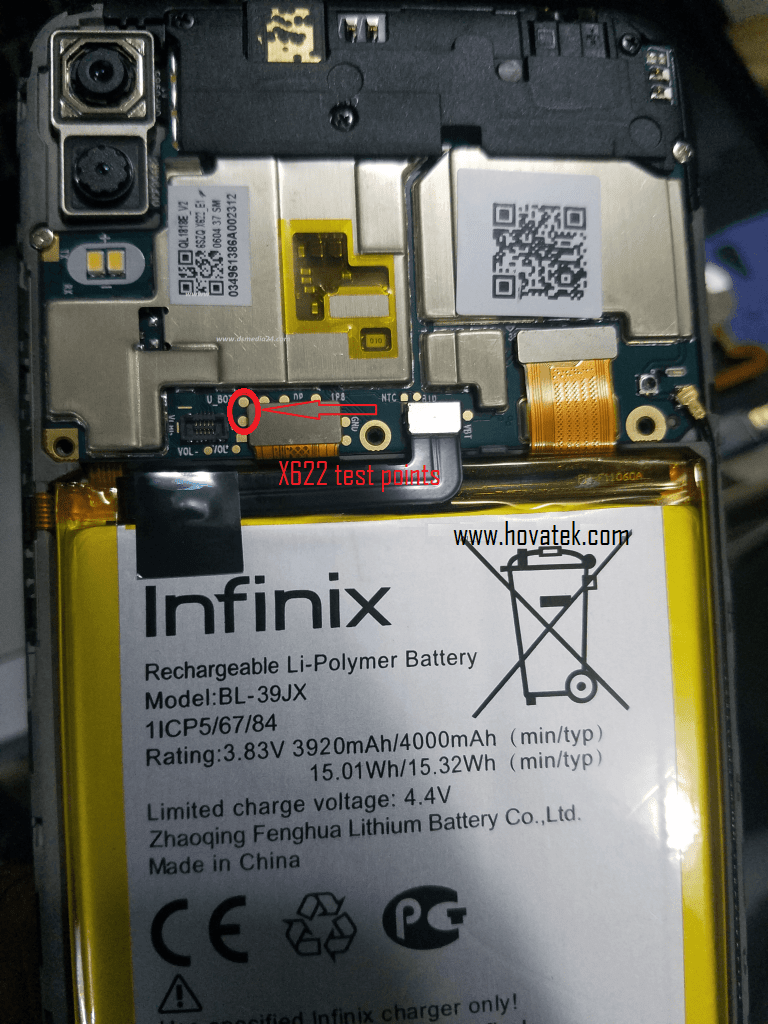

If you have been trying to get your Infinix Hot S3 or Infinix Hot 6 Pro or Infinix Hot 6X (Qualcomm Snapdragon) into Emergency Download or EDL mode (so you can bypass FRP or flash firmware) using button combo or even EDL cable then you must have noticed that it just doesn't work.
To force the phone into EDL mode, you need to disassemble it down to the board, join the two points in the image below using a thin piece of copper wire or tweezer / picker or any conducting material then connect the phone to the PC via USB cord.
Infinix Hot S3 X573 EDL test points
[Image: Infinix-Hot-S3-EDL-test-point.png]
Infinix Hot S3x X622 EDL test points
[Image: x622-hot-s3x-test-point.png]
Infinix Hot 6 Pro X608 EDL test points
[Image: Infinix-Hot-6-Pro-EDL-testpoint.png]
Infinix Hot 6X X623 EDL test points
[Image: X623-Test-Points.png]

28-04-2019, 05:16 AM
Thanks for the great Job @Hovatek, I salute u guys.
After opening my infinix x608, i find the photo above for the x608 is different from my motherboard layout as per attached link;
https://www.dropbox.com/s/b4vn7tw11bdr3r...8.jpg?dl=0
29-04-2019, 10:20 AM
(28-04-2019, 05:16 AM)BaabaFadil Thanks for the great Job @Hovatek, I salute u guys.
probably a clone phone and it might not even be qualcomm
if its the same one you posted @ https://www.hovatek.com/forum/thread-27574.html then its clearly a clone, you should stick to that thread

14-06-2019, 07:37 PM
What does "join the two points" mean?, I'm still newbie in this kind so please enlighten me.
This post was last modified: 16-06-2019, 08:33 PM by hovatek.
15-06-2019, 10:15 AM
(14-06-2019, 07:37 PM)healer12 What does "join the two points" mean?, I'm still newbie in this kind so please enlighten me.
you're to join both points as indicated in the picture using a thin piece of copper wire or tweezer or any conducting material will do
