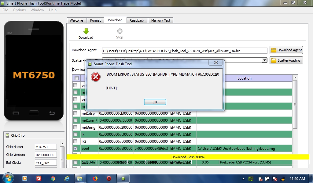

ROM file tested and it flashed successfully without any error. I use the backup boot.img as well as SPFT 5.1628

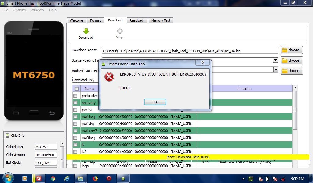

Prior to this time it was SPFT 5.1744 I used to flash the patched_boot and got the insufficient_buffer error
But now I tried using the SPFT 5.1628 to flash the patched_boot again and I got this error in attachment below. It reads BROM ERROR: STATUS_SEC_IMGHDR_TYPE_MISMATCH (0xC0020029)
What next boss?

(28-06-2018, 02:00 PM)ryfoz ROM file tested and it flashed successfully without any error. I use the backup boot.img as well as SPFT 5.1628
What next boss?
This means your device only accepts -signed or -verified images (factory rom)
There are some things I've been wanting to experiment on such devices but I've not met anyone willing to risk a brick
One is tryng Multiport Download tool
