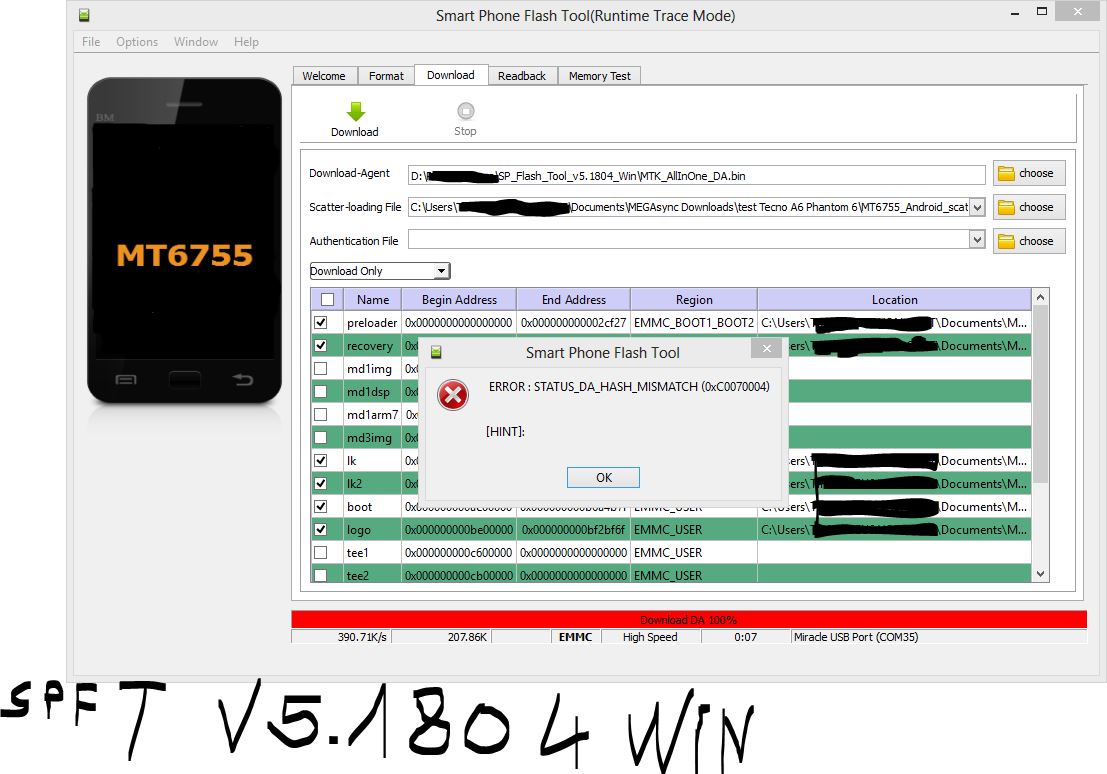

28-05-2018, 12:25 PM
Same error in SP FT latest 18.04

40
28-05-2018, 12:27 PM
Errors are the same in nck and sp flash tool. Don't have miracle box but will checck with a friend's
