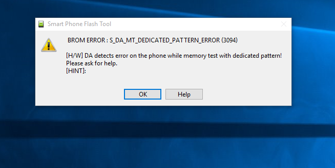

Phone still stuck at Bootlogo (Acer Liquid z5)
I've tried flashing stock ROM via SP Flash Tools as you say. Everything goes fine with no error message during flashing process but then when restarts back in the Boot-logo (Acer), as if nothing was flashed...
Besides, I get this error with the Memory Test of Flash Tool
BROM ERROR: S_DA_MT_DEDICATED PATTER ERROR (3094)
with no further hintm, what can it be?  emmc brick!!
thanks...

looks like a damaged emmc

any suggestion before throwing it in the trash..many thanks

(01-05-2018, 07:42 AM)pantofla any suggestion before throwing it in the trash..many thanks
eMMC chip needs replacement, you need to look for a phone hardware repair technician that can do that
