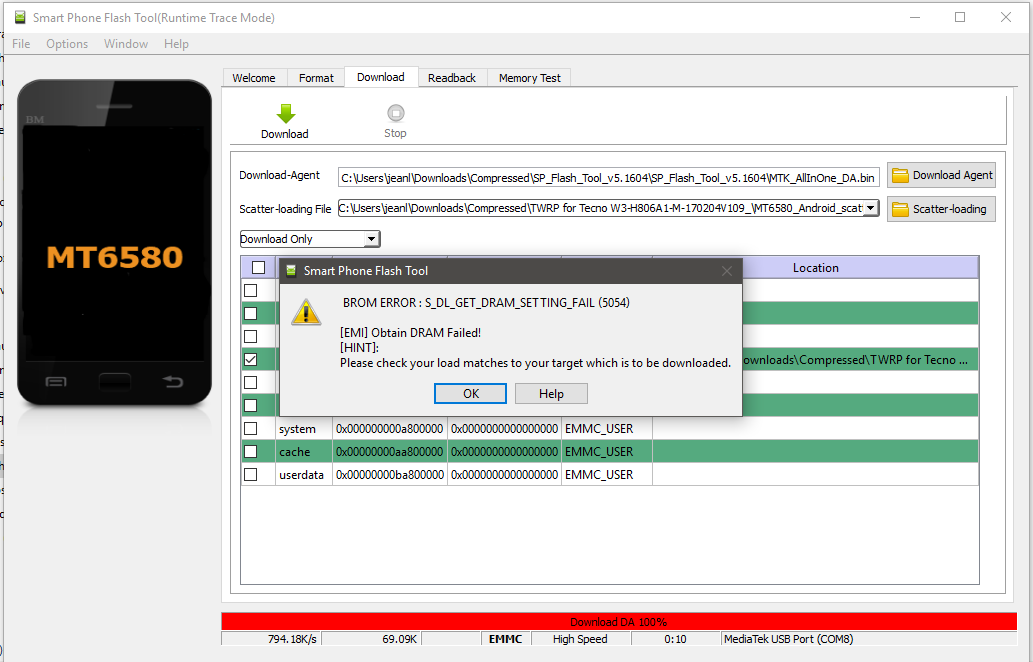

I tried several times to root my Tecno w3 (W3-H806A1-M-170204V109 ) without success I always get this error
BROM ERROR S_DL_GET_DRAM_SETTINGS_FAIL (5054)
a screenshot of my sp flash tool https://imgur.com/a/c66vvRx
below the recovery that i've tried to flash

21-04-2018, 08:28 PM
(21-04-2018, 03:05 AM)jeanloic179 I tried several times to root my Tecno w3 (W3-H806A1-M-170204V109 ) without success I always get this error
https://drive.google.com/file/d/0B4S-Z72...NCRm8/view
This is a mismatch error. The files your using aren't for your device.
Dump your phone's firmware in scatter format using Miracle Box at https://www.hovatek.com/forum/thread-13347.html
