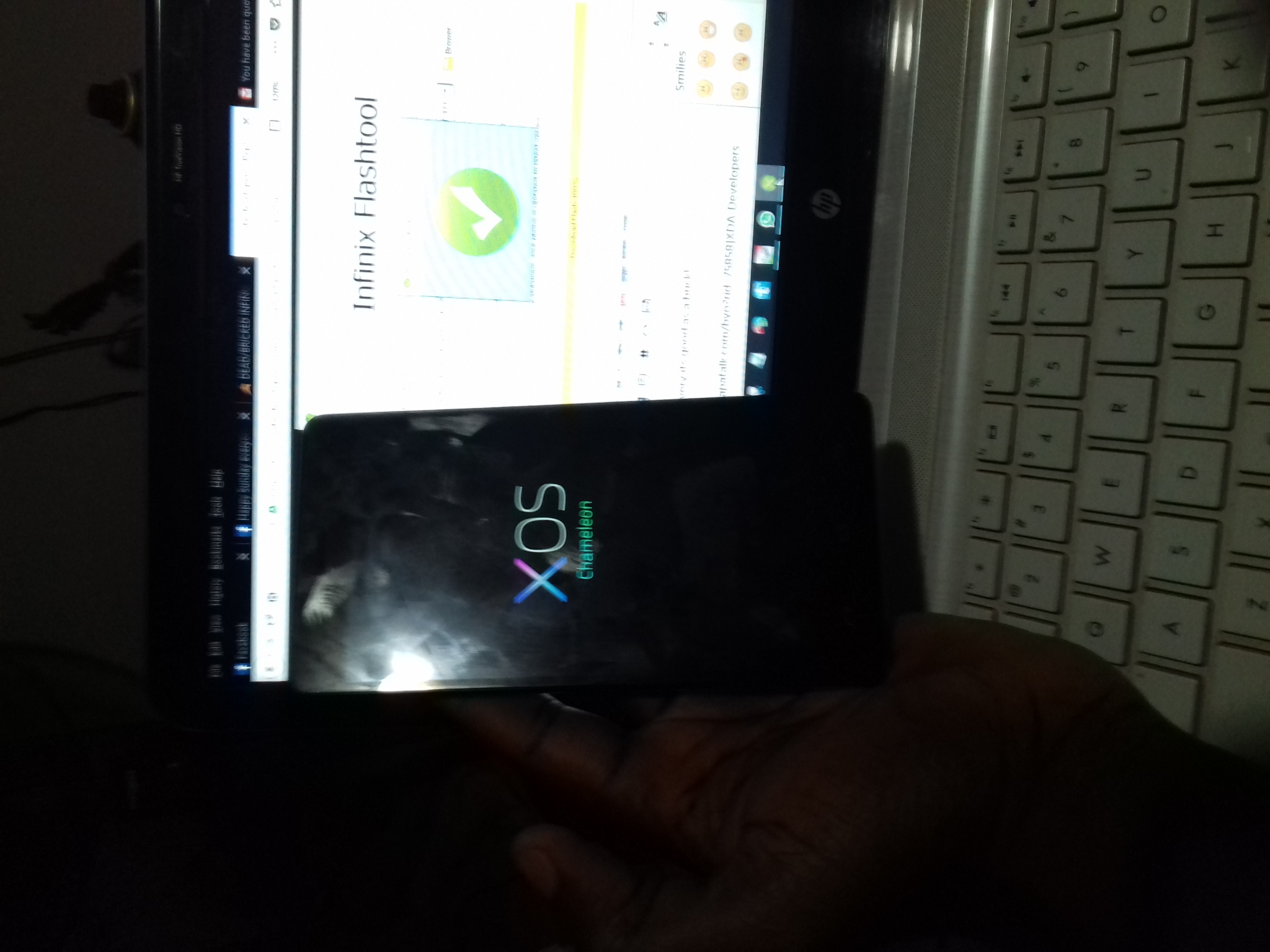

Well, I thank God I didn't relent on my own effort by not giving up on the phone as some people, even from other forum have already condemned it, telling me that there's neither chance or any hopes of the phone to be recovered.
I later used Infinix Flash tool to flash the same firmware I flashed with SP flash tool, (which made the phone dead) and now the phone is up and running well.
It seems to me that the Infinix flash Tool is somehow better than the Normal SP Flash Tool.
