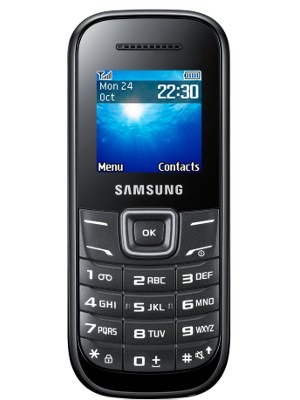

Confused Confused  can any one help me i was flashing E1207y dual  via miracle crack when flashing is done the phone doesnT power on i thing it was dead what can i do to retrive my phone plz help me

What was wrong with the phone before flashing?
Did you take note of the phone's build no. before flashing it?
Take out/reinsert the battery then try powering up the phone.

phone lock then i try to flash when flash is done my phone wont power on again

{phone lock } yess i take build number then i run mircalce crack then suddenly i select error jibset my jipset is spd the one i selected is mtk that coused the problem plz can u help me

(06-04-2018, 11:45 PM)Hanad777 {phone lock } yess i take build number then i run mircalce crack then suddenly i select error jibset my jipset is spd the one i selected is mtk that coused the problem plz can u help me
What's the phone's build no.
Also, selecting a wrong CPU/chipset should not be the problem. In fact, if your device is mtk and you selected spd, miracle will not even connect/detect your phone.

From what you've described, I don't think flashing occurred at all. Maybe the error caused the phone to go dead (refer to https://www.hovatek.com/forum/thread-808.html )
You need to clarify if flashing actually started / completed at all or if you got an error message before the phone went dead.

first the flashing started bro when it finished the phone doesn power on
the link u give is telling me to press and hold power button and volume but this phone doesnt have volume buttons

if flashing was successful, then take out / reinsert the battery and leave the phone to charge for some hours
if it still doesn't power on, then you'll need to look for and flash another rom from a different source
