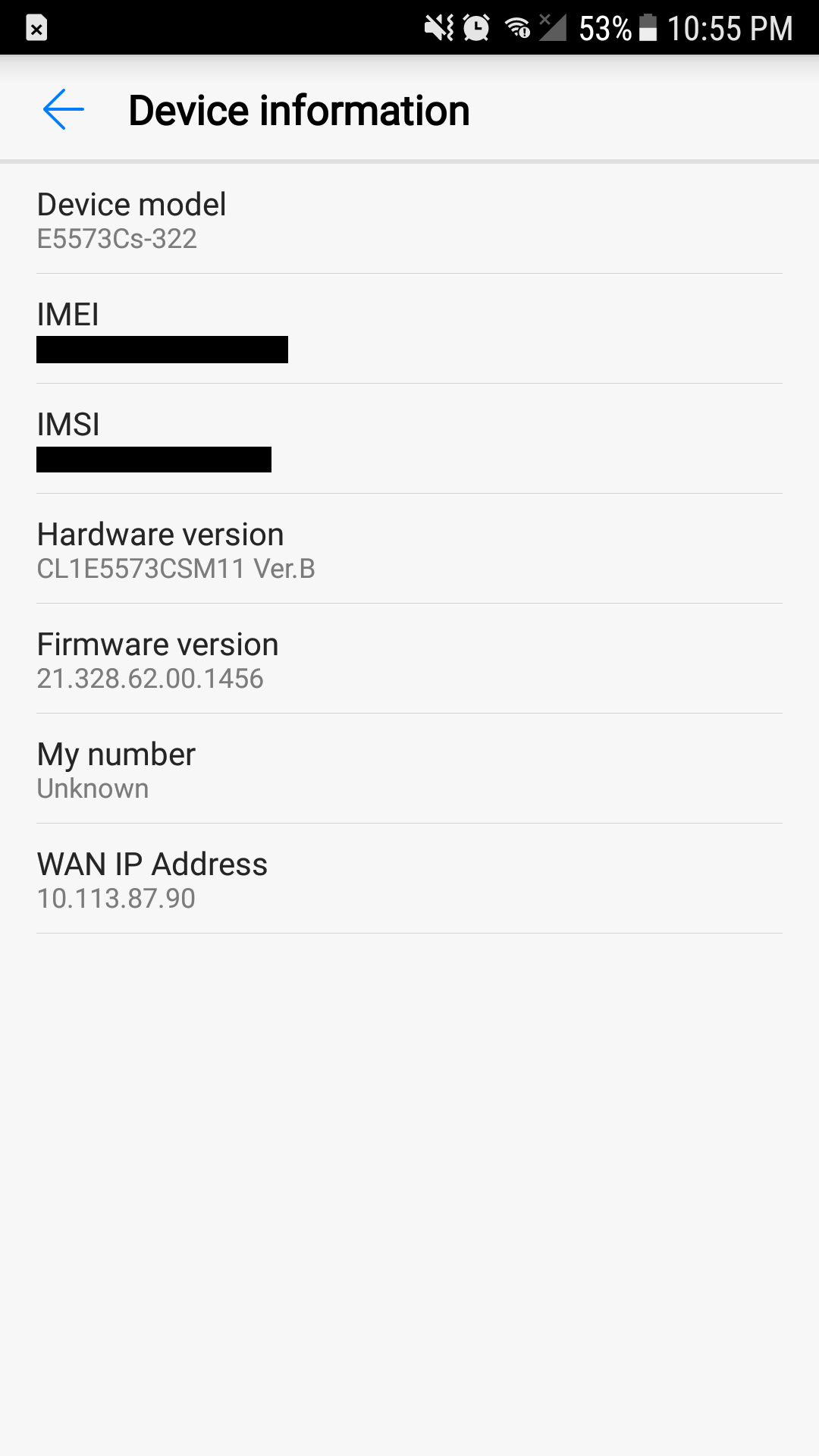

My device info:

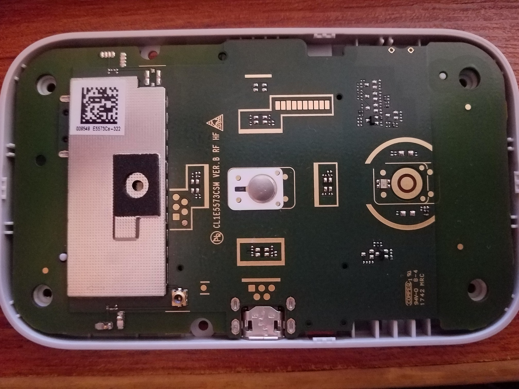

My device snapshots

- Disassembled the mifi device,
- Boot short the device and connected it to the pc
- let the pc detect it in boot short mode

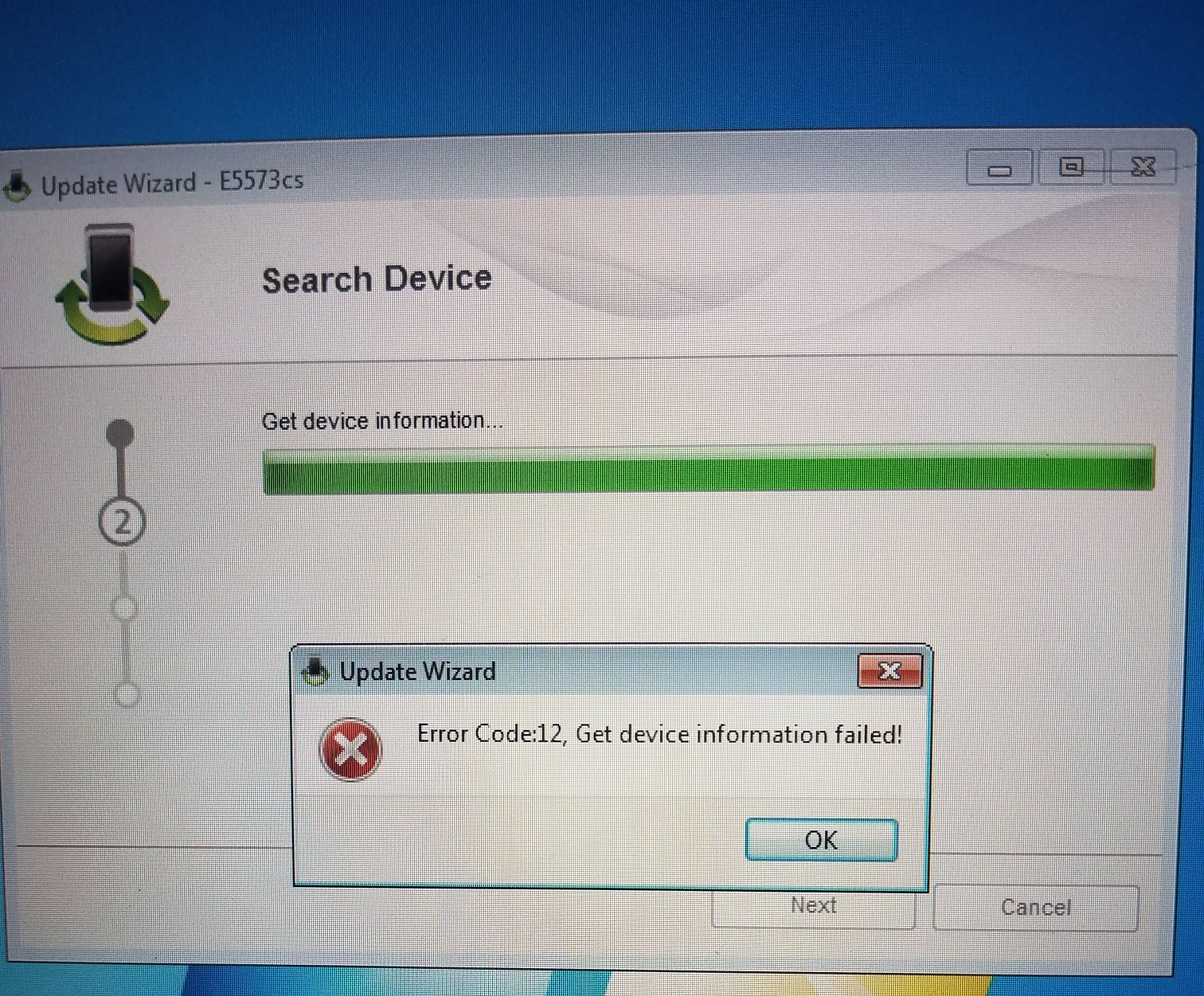

if i just ignore it and move on to the next step i get "get device information field"

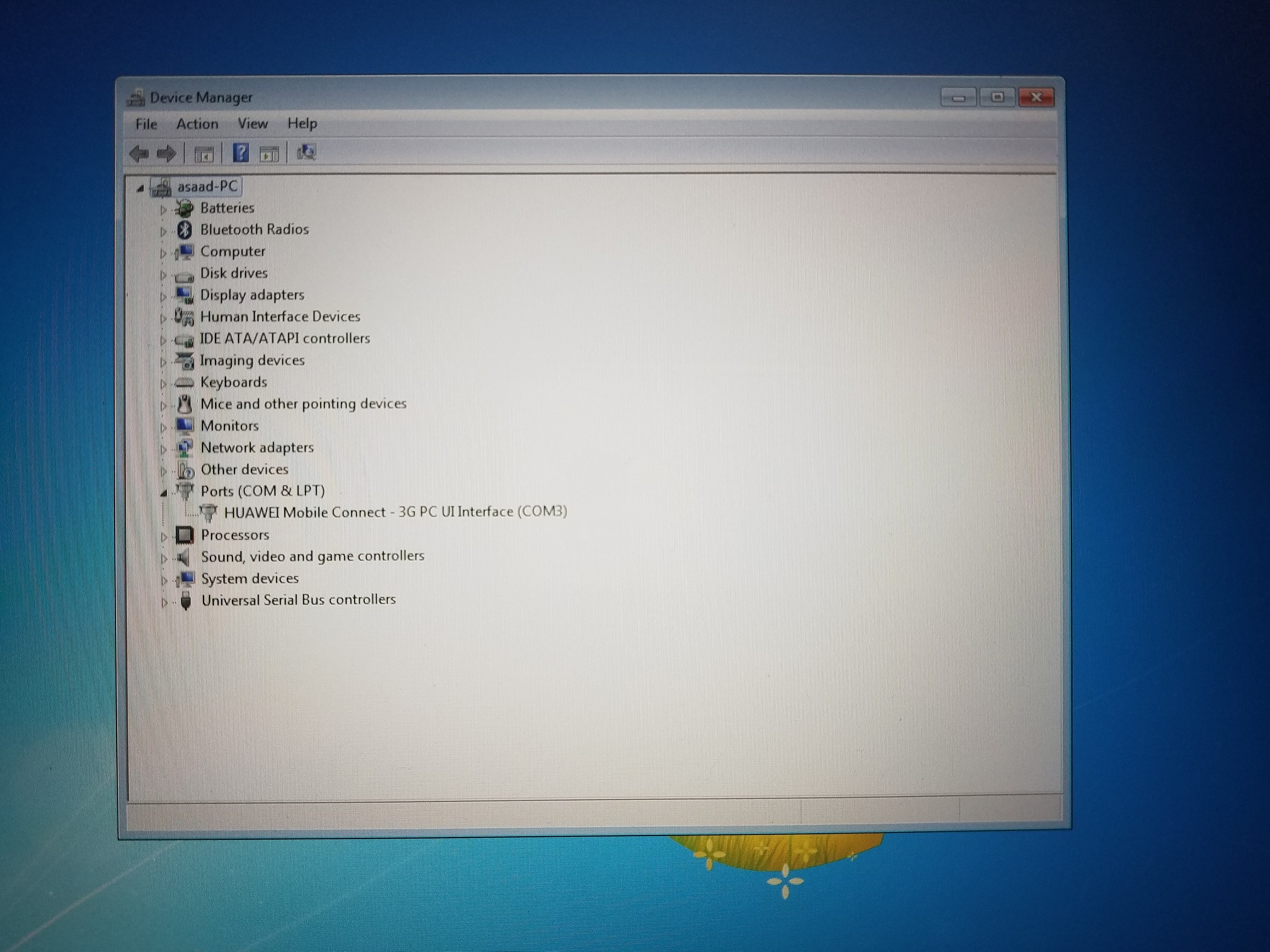

and my device manager looks something like this (on the fresh install windows 7 machine) (windows 10 machine is the same except on windows 7 network adapters etc are uninstalled)
there is no change in device manager before and after balong step.

whats the status of the device when you turn it on now; the two led lights blink continuously right?
retry flashing the firmware 2 - 3 more times , the driver in device manager is meant to change to "FC-*****-interface"  and there should be two of them displayed in device manager before the device will be detected for firmware flashing
if it doesn't work, then uninstall all huawei drivers using usb deview then download and install FC serial drivers @ http://www.mediafire.com/file/39p188qk2b...Serial.zip then retry flashing the firmware
