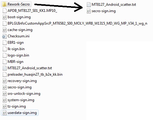

(05-04-2018, 10:42 AM)hovatek
(05-04-2018, 12:28 AM)Tii sorry about all this time, so the tablet has the same behaviour, even with windows 7, it detects and then quickly stops being detected and starts to show the battery logo...
OK. I think we can find a way around that.
Now, what I want to know is if you have the stock rom for the phone. If you do, I want to see a full screenshot of its contents
it calls: Acer_AV0K0_A3-A20_1.018.00_WW_GEN1_DCC
There is also a 1.015.00 file version and a 1.0.19.00 - this last one didn't work for me last time...
51,020
06-04-2018, 03:18 PM
#12
(06-04-2018, 11:47 AM)Tii it calls: Acer_AV0K0_A3-A20_1.018.00_WW_GEN1_DCC
try flashing this rom using sp flash tool;
load the scatter file > click download > hold the vol down button on the phone [hold the button until flashing is complete] > connect the phone to the pc
another alt would be to try booting to and flashing system.img via fastboot
