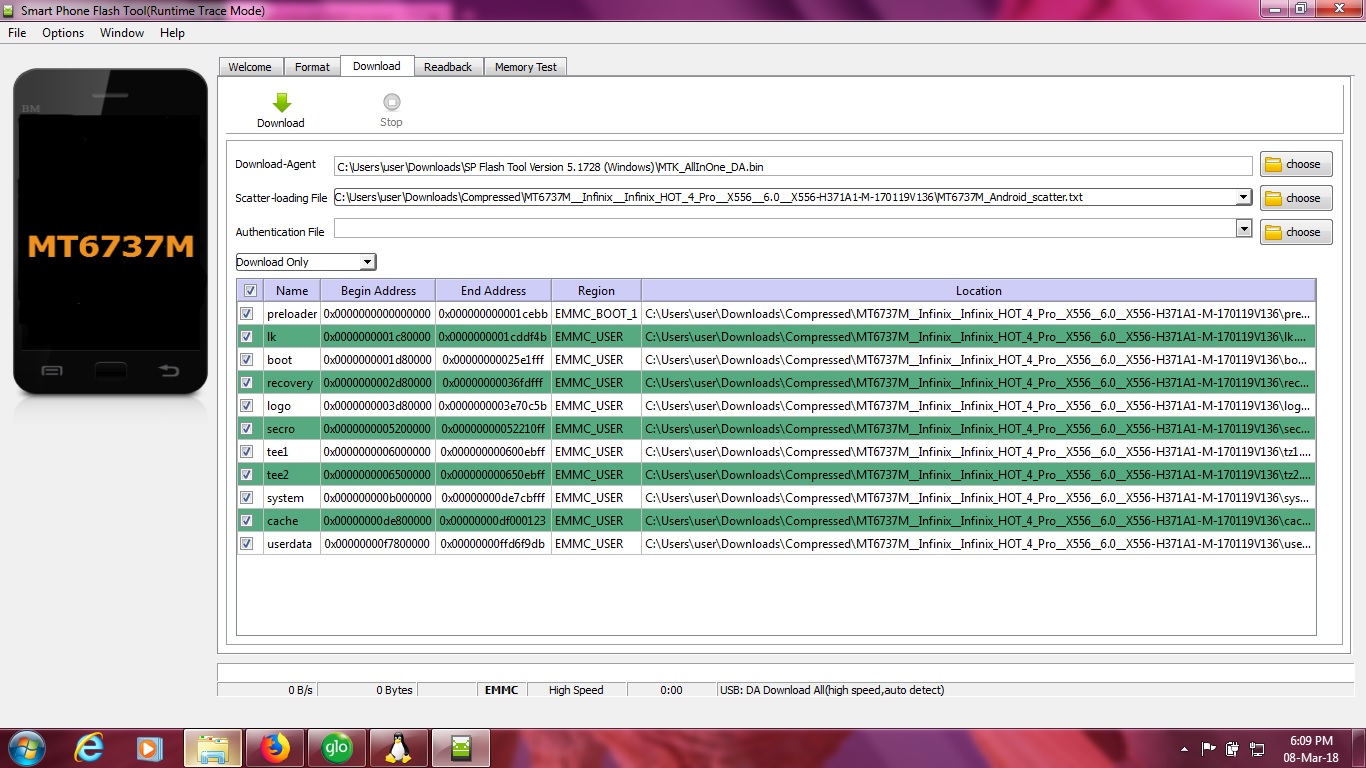

first of all i appreciate your effort for providing the file in the link above. i was confident my problem will be solved after receiving that link. after successful download and extraction of the file, i flash the phone using sp flash tool. successful flash but, the phone will not charge neither will it on.

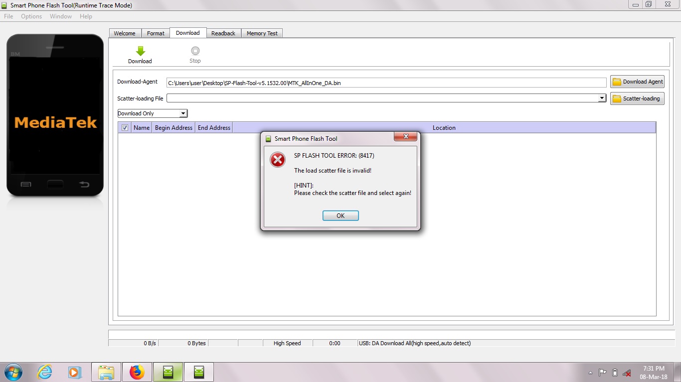

another thing i discover is that, the scatter file can not be load in infinix flash tool. in infinix flash tool i get this error "the loader scatter file is invalid.

Upload scatter file here. What is size of preloader? How did you get scatter file? Made yoirself or downloaded? What system is called? Is it called system sign? What version of spflashtool is? Post few screenshots.

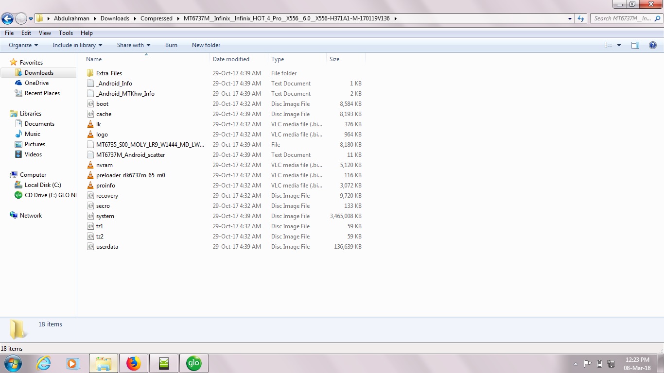

(08-03-2018, 12:00 AM)nijazxp Upload scatter file here. What is size of preloader? How did you get scatter file? Made yoirself or downloaded? What system is called? Is it called system sign? What version of spflashtool is? Post few screenshots.
base on the last file i just downloaded; the size of the preloader is 116kb, the scatter file was part of the file i downloaded, sp flash tool version is 5.1728.
.txt
MT6737M_Android_scatter.txt

Ok, please write me all file names that came with in that download, names of flashable files.

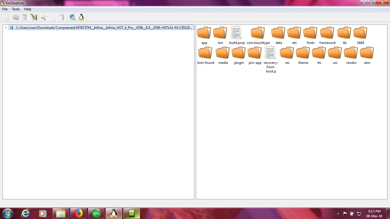

(08-03-2018, 01:33 AM)nijazxp Ok, please write me all file names that came with in that download, names of flashable files.
Preloader, lk, boot, recovery, logo, secro, tee1, tee2, system, cache and userdata.
