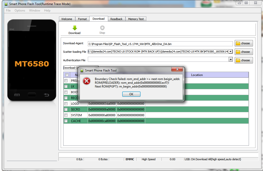

Hello. please help me my. Tecno l8 plus is in a boot loop mode. i have tried hard reseting and clearing catched partition but that has not helped .what next should i do?

download a rom from https://www.hovatek.com/forum/thread-19348.html then flash with SP FLASH

i have dowloaded but when i select the scatter file an error occurs

(19-02-2018, 07:38 AM)jayjayb .
Seems you're loading a Miracle box scatter in Sp flash tool.
read the instructions at the bottom of our firmware page
