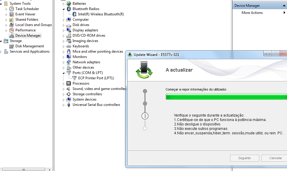

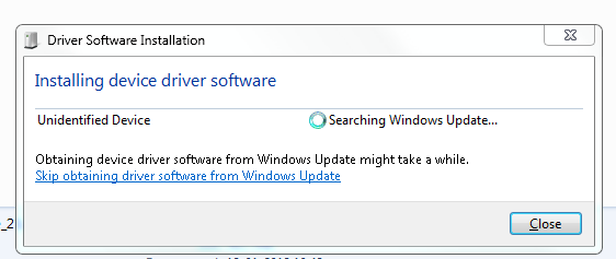

21-01-2018, 09:21 PM
I tried what you said and the step 5 it was done with success but the step 6 (the firmware: 21.316.01.00.00) stops when it almost at the end.
The device rebooted and the screen show "battery Error" but on device manger at windows, the device it's not recognized. (image attached: 2.png)
I tried the step 6 again and when the screen show "battery error", i put the battery carefully and the screen change to huawei logo but on device manager, the device it's not recognized. (image attached: 1.png)
