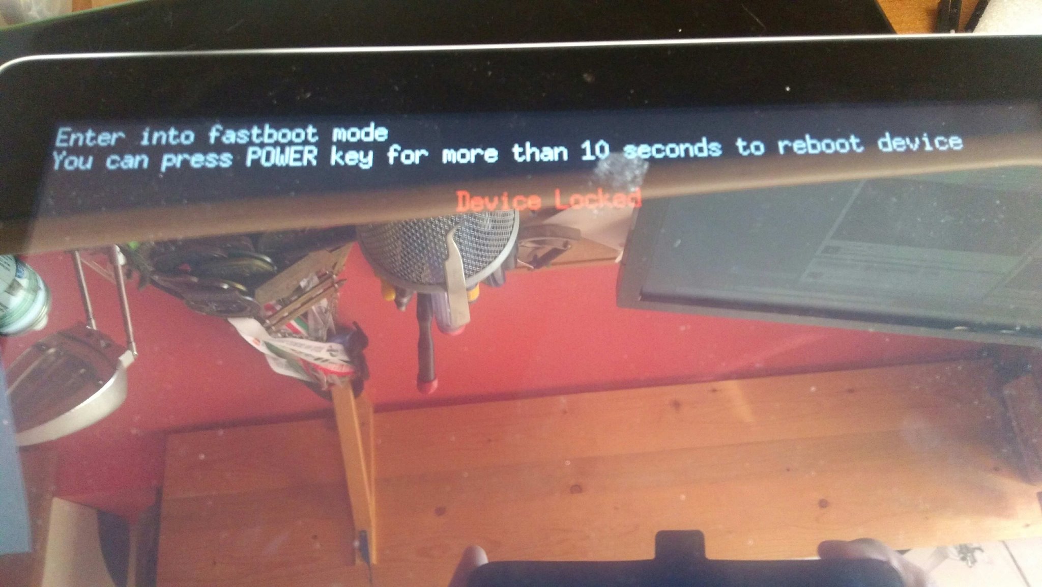

Hello everyone!
I have a Huawei Mediapad 10 Link + (S10-231L) tablet which remains blocked on the Huawei boot logo. I don't even know if the tablet's charging because every time I plug it to charger, it comes on and stays blocked on the logo.
I tried to update via sdcard with the stock rom Huawei Mediapad 10 Link + LTE Firmware (S10-231L, Android 4.2, 1.6 EMUI, V100R001C100B006, Finland) according to the guide contained in the zip of the stock rom, but nothing happens.
Can't even get in recovery mode. No command works... The tablet always came on and get stucked on the boot logo.
I tried different combination of power and volume button, the tablet always came on and get stucked on boot logo which one exception. Combitanion of power on and volume down button turning on a fastboot mode with information that device is blocked (at picture).
So I need help and suggestions please.
Thank you for everything!

23-08-2017, 06:13 PM
Yes i have, table enter into fastboot mode. I add a screen of this message to attached file.
23-08-2017, 11:17 PM
(23-08-2017, 06:13 PM)WojciechBachiński Yes i have, table enter into fastboot mode. I add a screen of this message to attached file.
This is fastboot.
I came across these fastboot flashable files your your model @ https://www.mediafire.com/folder/gfcssmj...231u_4.2.2
but first, how did the tab get stuck at logo?

Its quite possible that one of the volume buttons is stuck.
Anyway, run the fastboot devices command to see if the PC detects the phone while in fastboot
