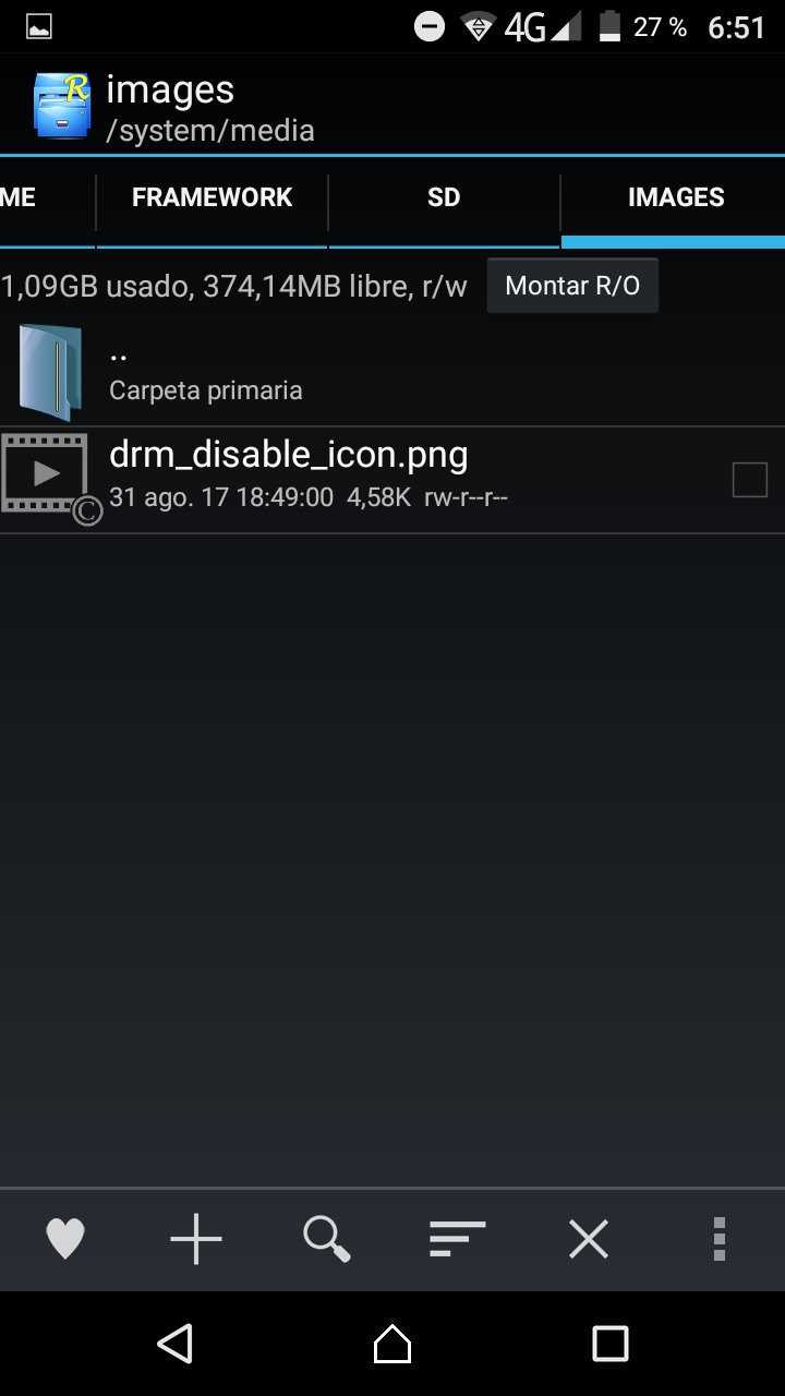

Can I see a screenshot of the contents of /system/media
With miracle box, I have the Lk.bin file
But I do not know how to decompress it and / or modify it
Here are the screenshots of what I have in system / media and subfolders:
[Image: Screenshot_1%5B1%5D.png?dl=0]
I attach the captures of what I have in system / media and subfolders:
