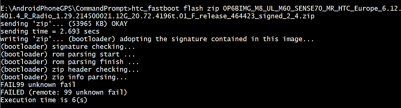

(04-02-2021, 12:11 PM)ludemon I used this method to unbrick a HTC One M8 however I am unable to flash a RUU without error using fastboot/RUU or XTC2Clip. I did restore a stock OS via TWRP recovery and everything appeared to be working except sound and microphone.
I am only able to move between OS, bootloader and recovery with the mmcblk0.img SD Card inserted. If the SD Card is removed and any reboot action is done the phone returns to EDL mode.
Can you help resolve this situation?
seems like a faulty emmc
what is the error when trying to flash ruu?
FAIL99 unknown fail
FAILED (remote: 99 unknown fail)

(05-02-2021, 09:57 PM)ludemon FAIL99 unknown fail
attach a full screenshot

Thanks for you reply. Attached is the screenshot.

(06-02-2021, 10:44 AM)ludemon Thanks for you reply. Attached is the screenshot.
if flashing zip firmware then you should run the command "fastboot oem rebootRUU"
if you still have problems then create a new thread for your device issue by clicking "Ask question" at the top

Before the flash command the phone was in RUU mode which was issued from XTC2CLIP program.
I will start a new thread as you suggest. Will I need to start the explanation from the beginning again?
