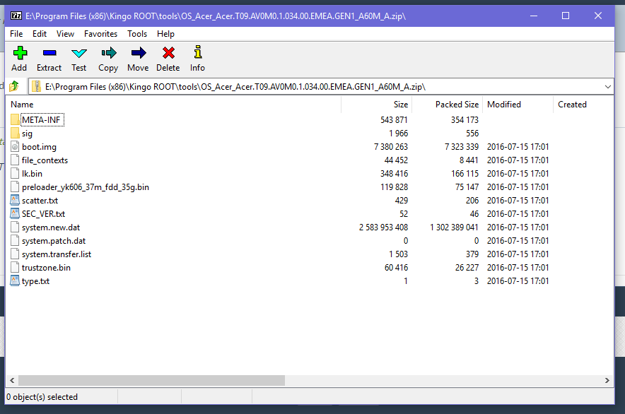

(02-08-2017, 04:10 PM)darkflame Is not the *.img I quoted the link too above the stock rom?
Its from acers site, and matches my model.
(02-08-2017, 10:40 PM)hovatek(02-08-2017, 04:10 PM)darkflame Is not the *.img I quoted the link too above the stock rom?
I think that ROM you flashed is supposed to be flashed in stock recovery, not custom.
Can I see a screenshot of the contents of the zip
(05-08-2017, 11:31 PM)darkflame Sure,
