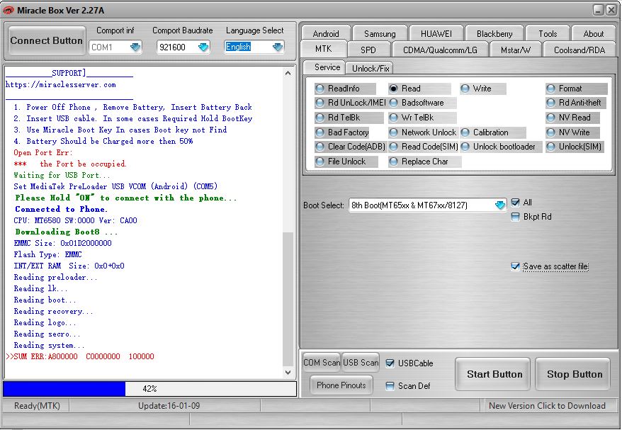

Hi,
My phone's build number is Acer_AV0M0_T10_1.021.00_EMEA_GEN1
Android version is android 6.0
With the Miracle Box read function I get a sum error while trying to write the system partition. (see attachement)

14-07-2017, 11:42 PM
(14-07-2017, 06:38 PM)HBurgers Hi,
That happens once a while. Retry
