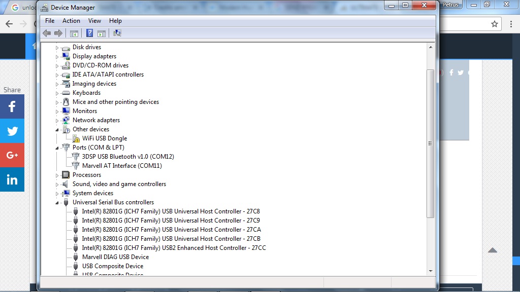

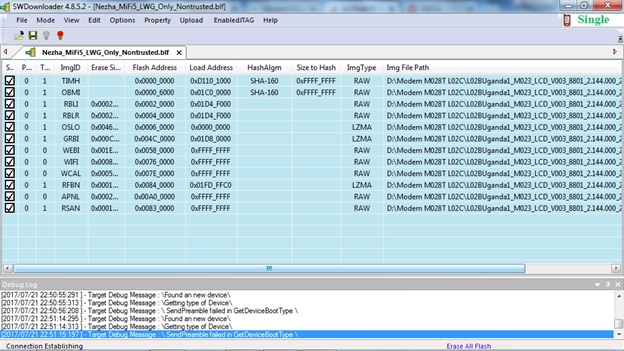

Hi Guys,
really need your help. after install usb driver i stuck at connect mifi (battery remove) with note "sendpreamble failed in gettdeviceboot type".
Thanks a lot guys.
Regards,
MRD
droidmobitech
droidmobitech
droidmobitech
828
21-07-2017, 06:50 PM
(21-07-2017, 06:41 PM)mrd1901 Hi Guys,
Thanks a lot guys.
Regards,
MRD
First check the drivers
1. Two drivers are installed
A. Wtptp driver
B. Marvell AT interface (LTE Generic Drivers manually)
Check to be sure if both are properly installed....I referred users to watch L02B steps to install drivers
2. Change USB port and test modem drivers before proceeding on operation as described in L02B guide
Pages (4): 1 2 3 4 Next
