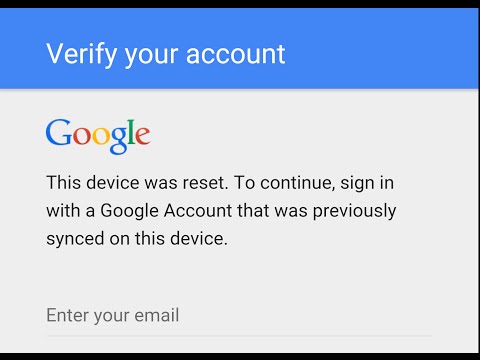

In this guide you will learn how to remove Factory Reset Protection (FRP) on Spreadtrum (SPD) chipset phone using ADB & Fastboot method.
If you have a Google account set up on the device, FRP is active, this means that after factory reset, you'll be required to log in to the Google Account using the username and password. If you have multiple Google Accounts set up on the device, you can log in using any of the accounts but in a case whereby you've forgotten the login details then you can follow the below method to remove FRP lock

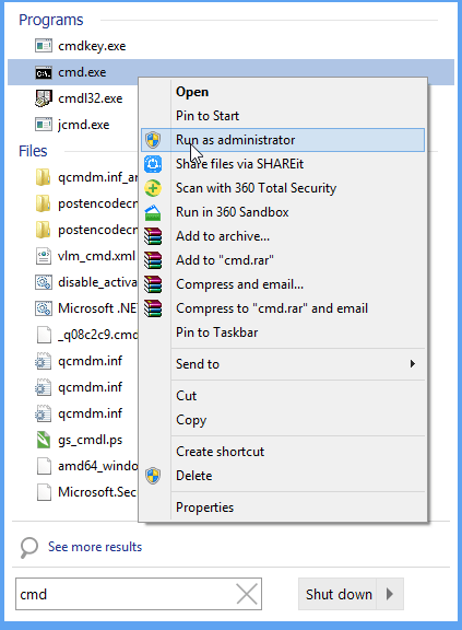

  3. Now Open CMD.exe as an Administrator
    [Image: how-to-remove-bypass-frp-google-account-...-4-min.png]

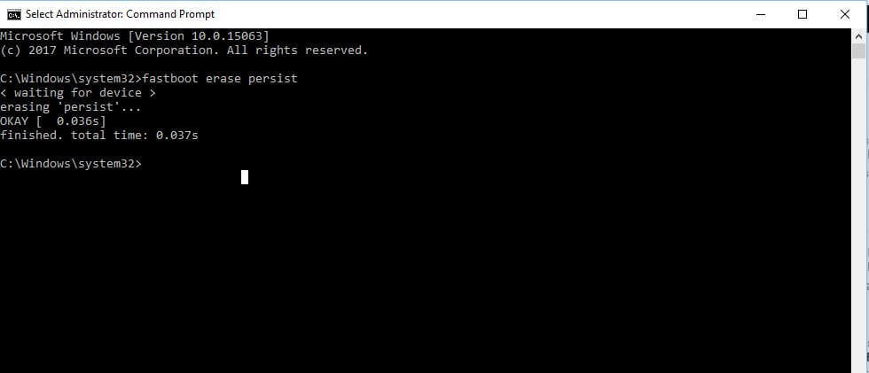

  5. Command Prompt will open then type the command below and Hit Enter Button
    fastboot erase persist
  6. [Image: fastboot.jpg]
  7. Then type the below command to restart your phone
    fastboot reboot
  8. [Image: fastboot-2.jpg]

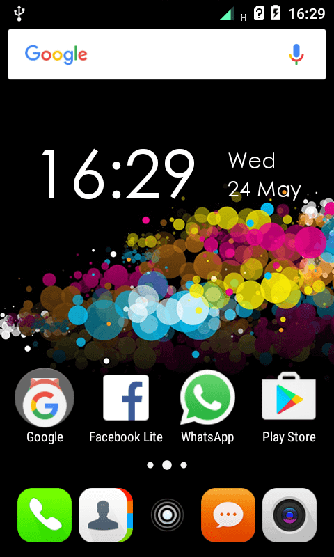

  9. Now Google Account is removed on your device
    [Image: how-to-remove-bypass-frp-google-account-...-9-min.png]
