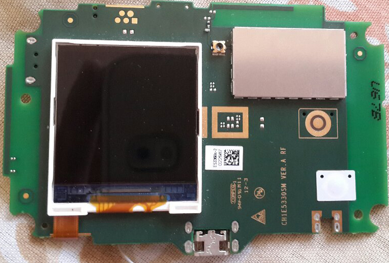

Post board picture for futher assistance

19-09-2017, 04:22 PM
Bro; upgrade both firmware and webUI with actually model not E5...
Be sure modem is  4g only or 3g and 4g/LTE
[/quote]
