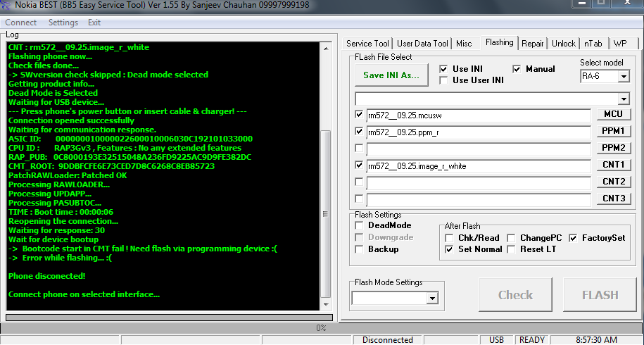

[img=43x54]546[/img]Hello guys my nokia 3208c it's working perfect an put a wrong code multiples times so it can access any codes any more...so i decided to
flash using ifinix best file i knw how to use ifinix best very well but this time it has come with my mistake..so i adedd mcu ppm1 cnt1 as i normanly flash all nokia phones..but this end with erro massage
>bootcode start in CMT fail ! i need flash via progrmming device
pls can any one know what that mean thanks

(14-02-2017, 06:25 PM)ibrahim12 [img=43x54]546[/img]Hello guys my nokia 3208c it's working perfect an put a wrong code multiples times so it can access any codes any more...so i decided to
from your screenshot, you didnt select the right model
* retry flashing using dead mode and select your device model from the dropdown bar.
* you can also try flashing using a different box or software (phoenix, jaf etc)
* are you using the infinity dongle or a cracked version?
