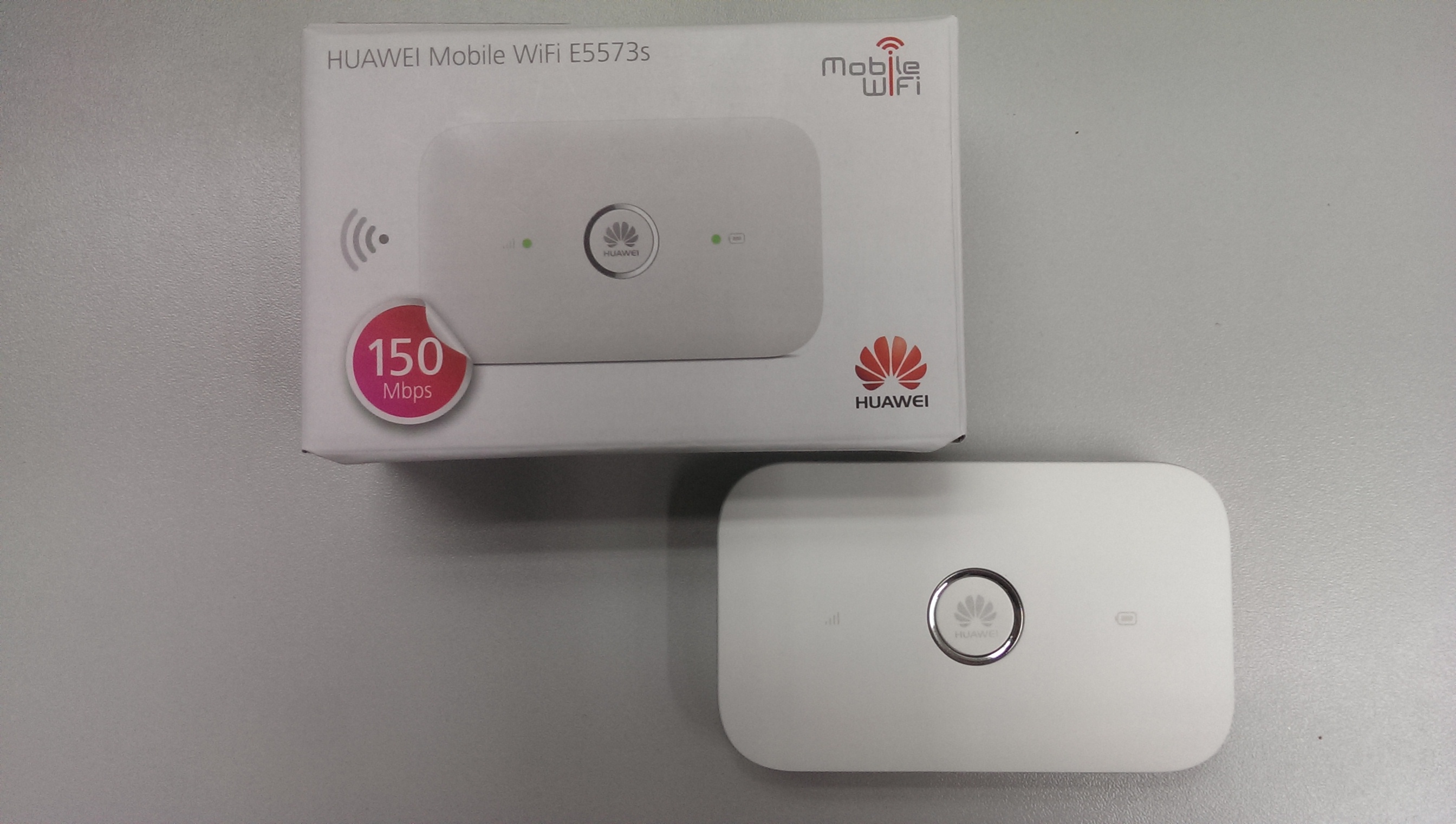

I will show you how to unlock your Huawei e5573s-606  MiFi (like from Airtel, Spectranet, EE and co)
What you will need
  1. Well charged MiFi you want to unlock
  2. Insert another network's SIM card into the MiFi
  3. Copy the IMEI of the Mi-Fi from the back
  4. Automatically install drivers by connecting the router to your computer using a USB cord
  5. Download and install (on your computer) HT-Huawei-latest-HiLink-Drivers &  HT-Huawei-Hilink-driver-v5.1.2600.2781 drivers (I have attached them at the end of this post)
  6. Download Huawei E5573s-606 Firmware (HT-Huawei E5573s-606 Firmware 21.110.99.03.00 general) from http://adf.ly/1ir0Mx
  7. Download Huawei v4 Code Calculator from http://adf.ly/1ir0Yt
  8. Generate your MiFi's Flash Code from http://www.modemunlock.com/huawei.php
How to successfully unlock Huawei e5573s-606
  1. Connect the MiFi to your computer
  2. Unzip the Huawei E5573s-606 Firmware file. You'll find P711s-E5_Update_21.110.99.03.00 in it. Double-click it
  3. Follow the installation wizard till it asks you for a Flash Code / Password. Input the Flash Code you generated above
  4. Follow the steps till its successful
  5. Launch the Huawei Unlock Code Calculator and click the Read
  6. The tool will provide Pattern 1 & 2 with hash codes
  7. At this point, click Calculate
  8. Wait till it generates the unlock code the copy it out
  9. Go back to the Huawei E5573s-606 firmware folder and run E5573_Update_21.180.17.00.00
  10. Follow the wizard till update is successful
  11. Connect to the Huawei mifi's network and login at the Dashboard to enter the unlock Code
