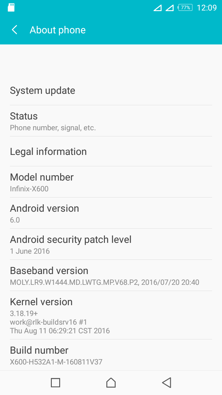

I did exactly as you said. Was able to flash TWRP on both the working and the problematic one. Later made backup of NVRAM and Secro, then successfully restored it to the problematic one, but painfully still, NO SIGNAL, yet it'll display the the 2 network names.
I later took my time to back up everything on the working phone and gave back to the owner. So please, what can I do to make it bring out the signals and work?
Thanks for your unwavering support.

Thank you Maxpayne for your response. I've actually downgraded it back to the 5.1 lollipop it was before the flash, and yet the problem sitll persists. That was even before I tried the backup and restore option, as I was advised by the Hovatek guru

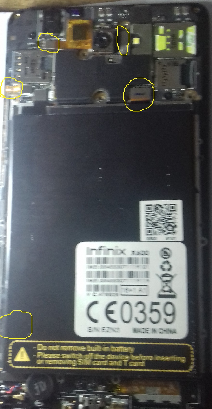

This seems like a minor Hardware issue.
On some models, there's a cable that joins the upper section of the Motherboard to the lower section. Changing or disconnecting and reconnecting this cable has fixed two cases I've encountered.
You should have the phone looked at by an experienced hardware technician

Okay, but which of the cable precisely? Is it the one underneath the battery?
Attached is the hardware section of the phone after carefully loosing it, with the cable connections
