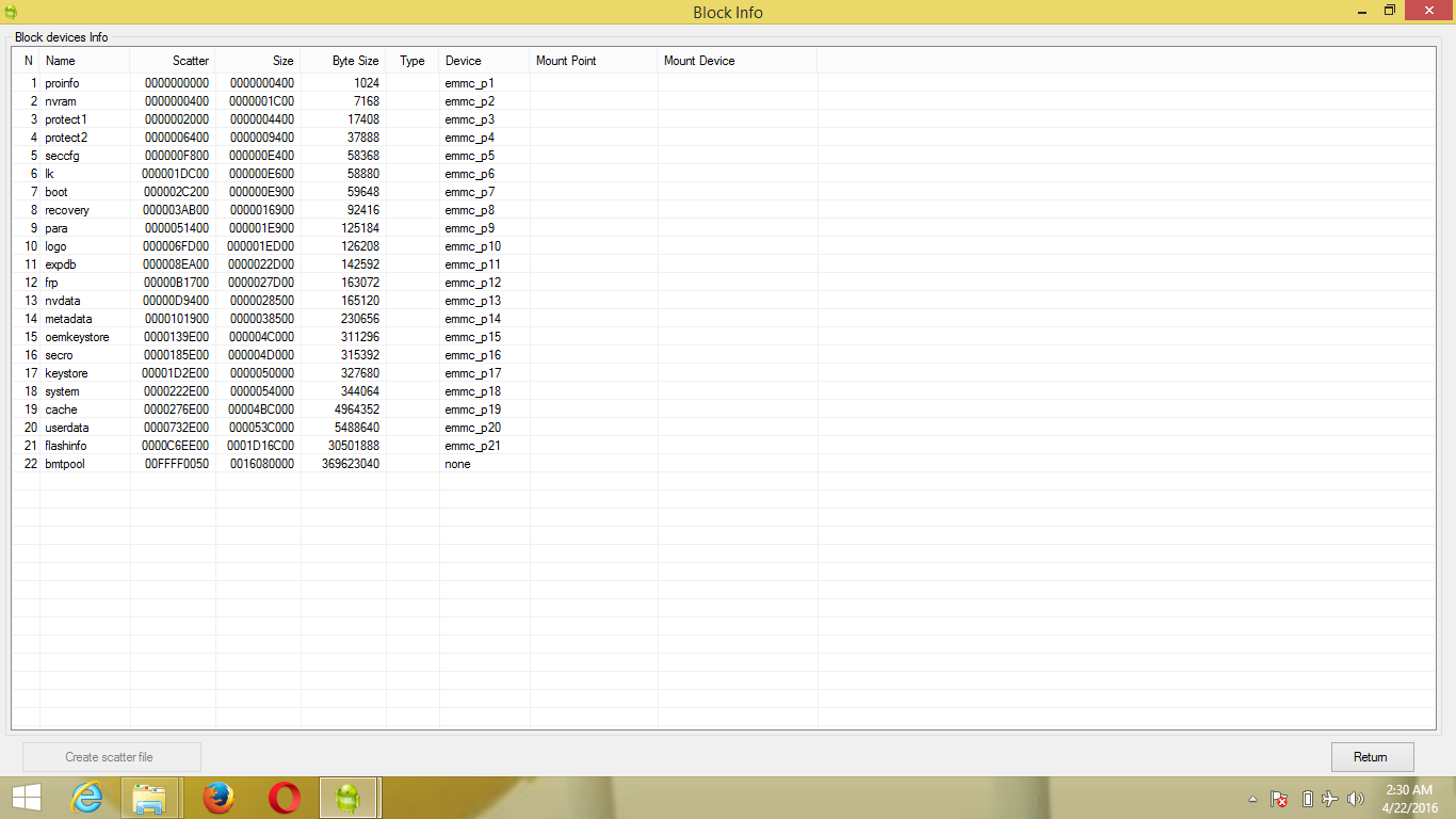

Good Morning guys, please when i was modifying the scatter file i encountered 2 problems :
1 In the Block Map, there's BMTPOOL but in the Scatter file that i'm modifying, it's not there. So how do i do that please?
2 In the Block Map, under PROINFO scatter column, it displayed only zeros,e.g. 000000000000000000. How do i modify that please?
But i tried to use my own idea, i ignored the BMTPOOL that is not in the Scatter file that i'm modifying but in my BLOCK MAP and i also modified the PROINFO that was showing only zeros (00000000000000000) , as 0x and i deleted others that are in the scatter file but not in the Block Map and i saved it.

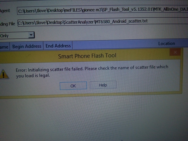

And i tried to load it in SP FLASH TOOL but it's showing " error : initializing scatter file failed, please check the name of the scatter file which you load is legal"
I followed this thread ? https://www.hovatek.com/forum/thread-12719.html in modifying the scatter file.
I've also attached an image for the Sp flash tool error,
Attached also is a screenshot of the BLOCK MAP information from MTK DROID TOOLS ,
Attached also is the modified scatter file using the information from the BLOCK MAP in MTK DROID TOOLS.
Please, your kind assistance will be highly appreciated, thanks in advance.

(22-04-2016, 02:20 AM)lakunle1love Good Morning guys, please when i was modifying the scatter file i encountered 2 problems :
Sent from my M5 mini using Hovatek mobile
1. Ignore BMTPOOl
2. It's supposed to be 0x0

22-04-2016, 03:20 PM
Done that but i'm getting this error [WHITE RIGHT POINTING BACKHAND INDEX] "address or length bytes not align" while trying to backup a single partition which is boot.img.
What should i do please?

paste the content of the scatter file here and a screenshot of the Blocks Map

(22-04-2016, 03:20 PM)lakunle1love Done that but i'm getting this error [WHITE RIGHT POINTING BACKHAND INDEX] "address or length bytes not align" while trying to backup a single partition which is boot.img.

Please help take a look at it and check if there's anything wrong.
Thanks in advance.

still expecting the Blocks Map screenshot
